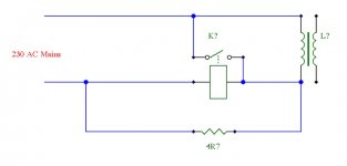

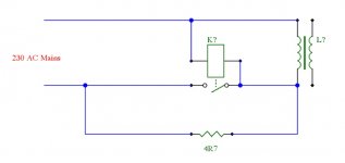

A very, very simple soft start circuit

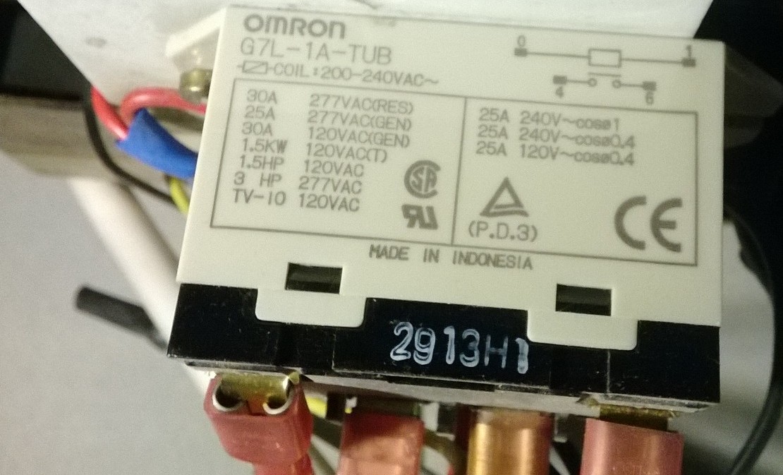

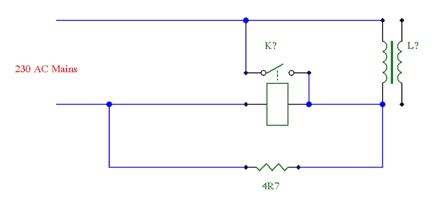

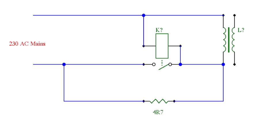

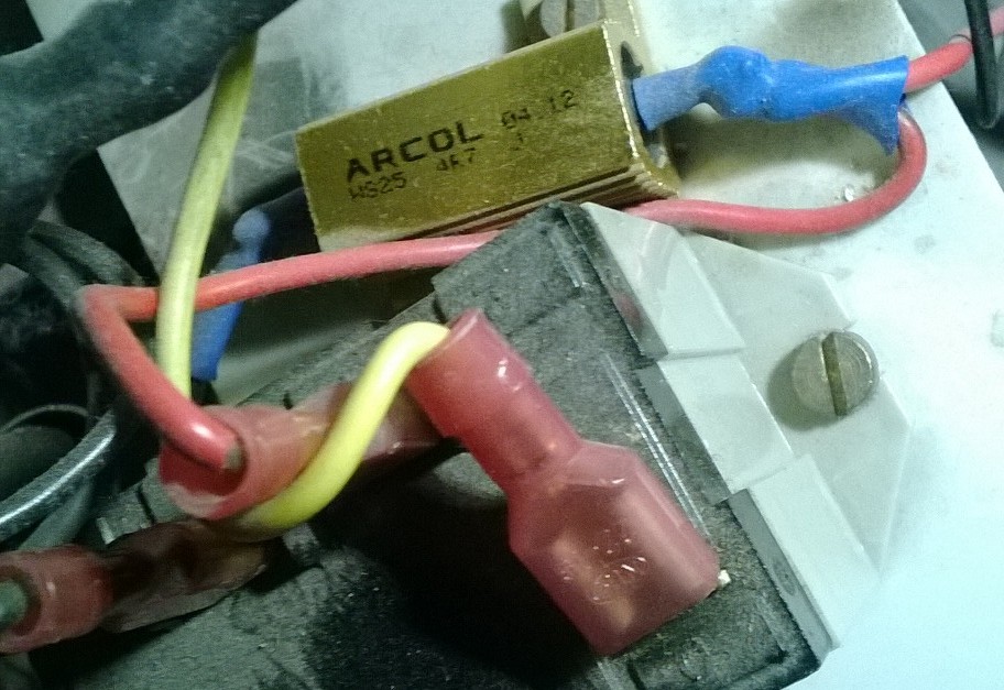

I use a relay (Omron 30A with a 200/240 coil for my 230 grid) and one 4,7 ohm Arcol power resistor to start up a 5 KVA toroid trafo (1:1) which in turn holds two 1,2KVA trafos etc.
The relay draw at 150 volt. Its arranged so that the load is on the 4,7 ohm resistor until the voltage has risen to 150 volt over the primary. Then the resistor is shortened by the relay.
Takes 2 components.

That makes more sense! Correct me if I am wrong, but I believe that the delay in your circuit is too small, considering that for that particular relay "must energize" voltage is 150V, probably a bit less, and time to energize is max 30ms, so that would give a delay of 1-2 cycles.
It is long enough to make my system being able to start or blowing my 10A fuses. I couldn't make it start without it and it has worked for 10 years+. But yes, it will not pamper your big capacitors. I keep my rig on mostly. But I clearly can hear the delay but it is short - less than a second.
a diode in series with the coil, and diode across the coil (oriented so it doesn't short the mains out).. should provide at least double the turn on time. only problem being it will take a good bit of time for the relay to open on a momentary mains blip.
Transformer in-rush condition plus effective short circuited secondary condition would I reckon restrict the coil voltage quite a lot for many cycles, and hence meet the basic requirement. Of course, during that time the series resistor 'gets it in the neck' so needs to be a type with a good overload characteristic, and a value that will be somewhat of a compromise between delay time and power rating, and so the resistor becomes a 'not so simple' selection because it has mains on it. A digital cro is probably needed to see how much actual delay time you achieve, and whether you need to go to half-wave coil powering or not.
