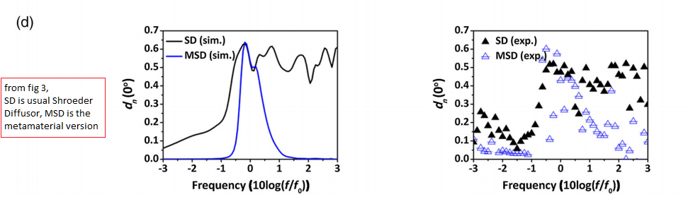

Here looks to be a bug in the ointment: "The results demonstrate that the MSD has normalized diffusion coefficients comparable with the conventional SD in the vicinity of the center frequency"
attachment.php

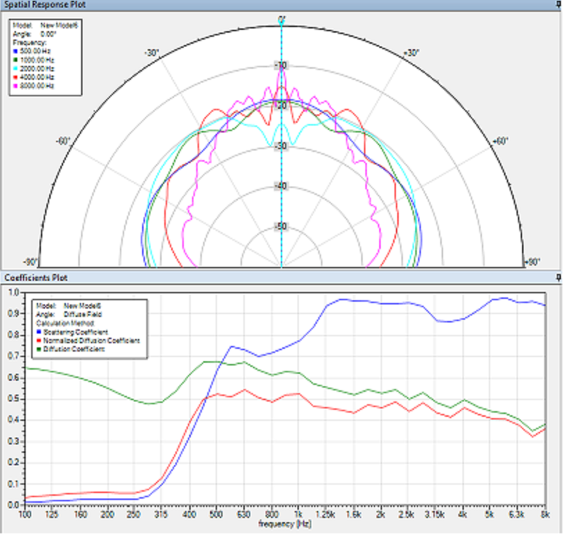

The bandwidth doesn't look very wide, compared to the usual Shroeder diffusor or evolutionary-optimized step diffusor. Unless I'm reading this wrong.
For instance, the 'depot' diffusor covers (in modeling at least, who knows? in measurements...) from about 500 to 8kHz --

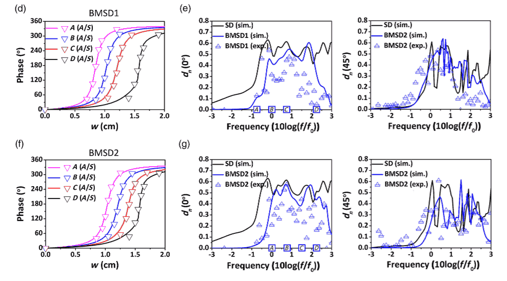

Yes, I saw that and it worried me. But it made me wonder if that's the reason to have multiple frequency points. What is the bandwidth if each block in a normal skyline diffuser? Or the slots of the other types? Are they more broadband?
EDIT. Their graph does show the normal SD to have much better bandwidth. But there were some solutions to that, will have a look.
They dealt with the bandwith problem on page 7.
" A broad-band MSD (BMSD) has a hybrid structure comprising
components designed for generating the desired phase delay
at multiple frequencies. "
It seems to work better.
