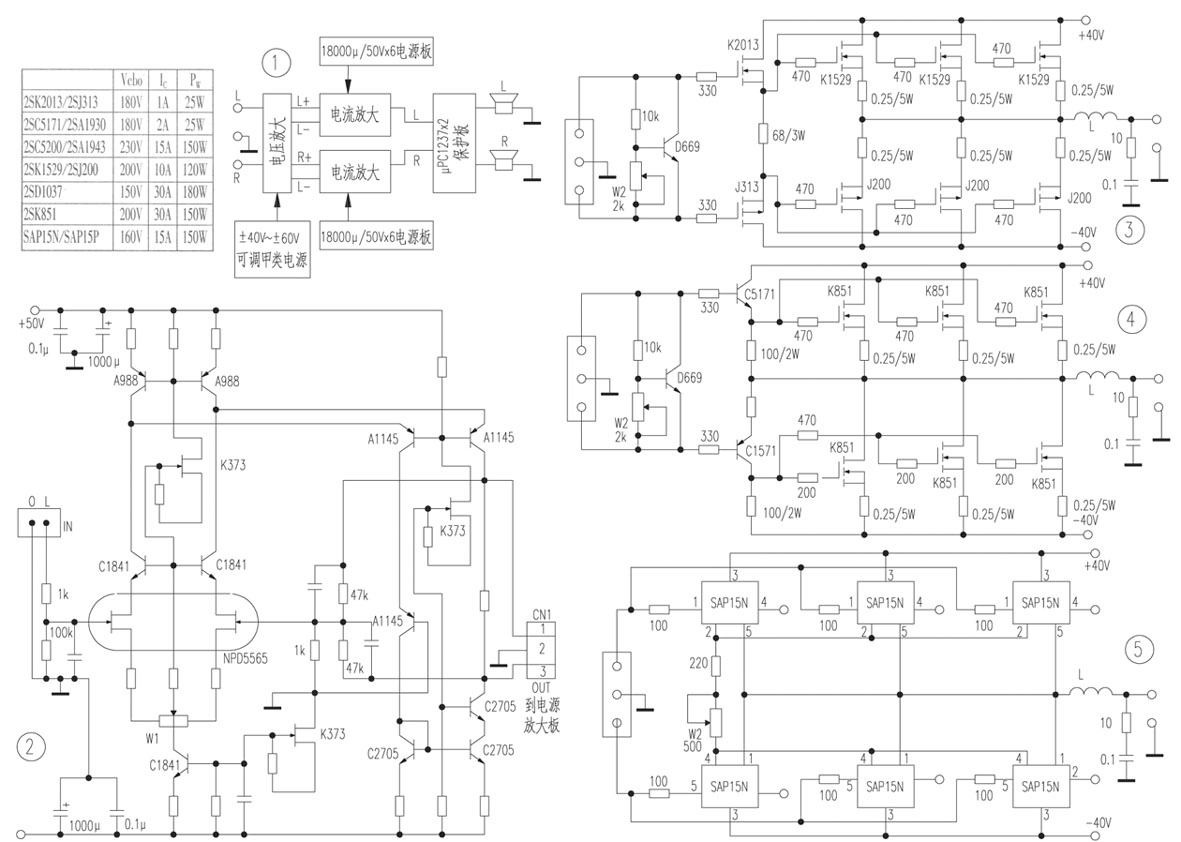

A very interesting amplifier schem , do someone knows more about??
Hello
Here is a amplifier schematic , for 2 different type power mosfet or to the new Sanken darlington .
Do someone know more about these ?
Any comment welcome since only the schematic and a couple words ,to me looks like Japanese .
Sorry if already somebody ask about these , I didn't find any info on the forum.
Please take a look .😉
Greetings

Hello
Yes the front end I think a bit over complicate but can be still good .
The output section actually very nice .
Probably for a few watt biased in class A or all the way ? 40V PS and 3 pair high power mosfet or darlingtons .
I was curious if anybody tried to clone these . Or the front end to scary?? It seems to me a bit over "the limit" .
Greetings
Not too complicated at all, cascodes with J-fet CCS's to set the cascode voltages and the current sources for the LTP legs, the VAS mirror is also cascode. The difference in current from the sum of the two LTP leg sources and common mode current source at the bottom for both sides drives the VAS. Quite a neat arrangement I think.🙂
Front end looks like Roender's "RMI" folded cascode. Only difference is the FET CCS for the cascode references. Another neat thing ... it looks like a modular setup , plug in any output stage. #1 is P-N vertical 2- quasi vertical 3 - a mystery?? (proprietary **) 🙂

Maybe if you compare it to a DX. 🙄 It is just a slighty augmented "symasym"... 😎 I might sim it and put it on a 75mm X 75mm PCB module , just for fun (HX "mongrel").

Chinese I think. A couple of points - don't follow the input wiring arrangement shown - decoupling to the input ground (unless you want fairly poor sound). And the output stages have the zobel network on the wrong side of the output choke. According to Doug Self, the zobel is to help suppress VHF parasitics in the output stage, putting it on the far side of an inductor will reduce its effectiveness at that.

That is probably a HF input filter (220-470pF) OUR (DIY) zobels are standard ..😀
I don't think this was meant to be built , just an overview of some chinese design with a separate more specific BOM.
Thiele showed two verions of the Network.
One had the Hot to Ground R+C before the Hot to Output L//R coil.
In the other the R+C was often reduced to just a C and placed after the L//R.
Leach uses this version.
Cherry discusses both versions and the infinite set of versions in between.
Where there's a lowish-value resistor in parallel with the choke (considerably lower than the zobel resistor value) then I don't think it matters which side of the choke the zobel goes. Having a non-wirewound resistor in parallel with the choke is a good idea as it provides HF damping.
This amplifier is of high class. No doubt about it!
Lot's of good things in the circuit. Especially the input.
But here comes the problems .... to find all 'exotic' transistors used.
The JFETs, NPD5565 and SK373.
The outputs, SK1529/SJ200 or those SANKEN.
