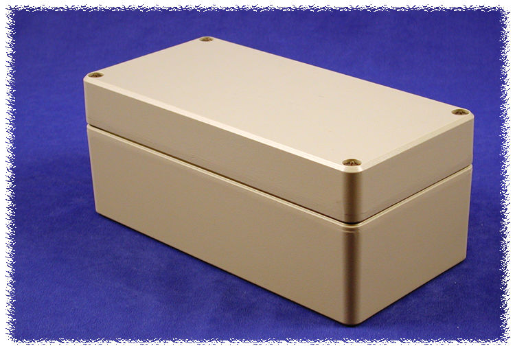

Hi and thanks for the helpful explanations.
My point is that the front baffle vibrations are the most detrimental for a good 3D effect
If i had to make a panel stiffer i would start from the front baffle for sure
The contribution of side and back panels is much less detrimental.
A solution for the speaker enclosure could be like this one ... i guess a very expensive solution i am afraid.
Hammond Mfg. - ROLEC-HAMMOND Painted, Diecast Aluminum Enclosures (R100 Series)
or even only the cover for the front panel
Possibly this could be a small two ways satellite for mid/high signals, probably the most delicate and important for soundstage reproduction
Thanks again and kind regards, gino
