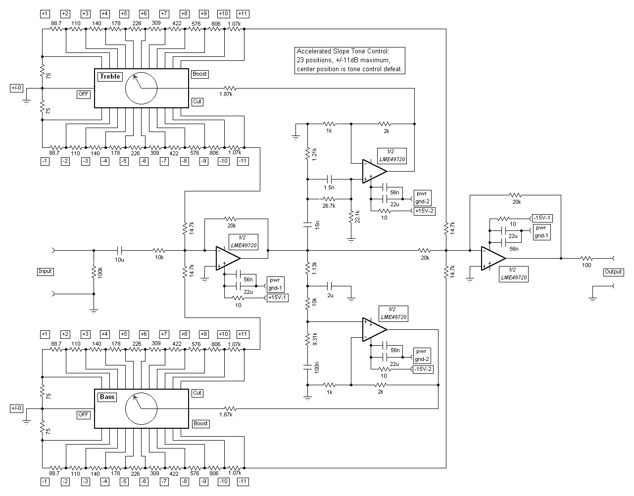

I have some more questions about your interesting circuit, specifically on the most recent version:
1. What amount of attenuation is obtained with the 25kOhm potentiometer on the input?
2. Do you recommend any particular pot on the input? Audio (log) or linear taper? What about constructing a stepped attenuator? Any suggestions for that?
3. What is the input impedance on the most recent version with the 25kOhm pot and the 20k input resistor on the opamp? What would it be if I wanted to use a 10kOhm resistor on the opamp input to give 2X gain?
4. I notice you again changed the opamps, this time to the LME49860. Any particular reason for that? Are they stable in this circuit, and did you bypass the power supply pins in the same way as with your previous versions?
5. Is this circuit now in use in your system? If so, how do you like it?
The more I look at your circuit, the more I believe it would provide the basis for an excellent preamp for my system. Thanks for your continued attention to my questions.

Hi majerjack, I'm back as promised.
A) With the input level control set to maximum it will be about (-.75dB), and of course, at minimum it fully attenuates.
A) The input level controls are there to eliminate the differences in output levels of the signal sources so that when one switches from one source to another there will be no aparent change in loudness, they aren't intended to be used as volume controls. So you could use linear or log taper pots here, I used linear trim pots, it really isn't critical at all.
A) The input impedance with a 20kOhm resistor in the circuit as shown is 12kOhm, with 10kOhm it's 8kOhm. Input impedance would be 5.1kOhm if a 4.99kOhm were used for 4X gain, any decent signal source should work just fine with that.
A) For my initial version, I just used parts I had on hand. At the time I had a bunch of OPA2132's in the parts bin, so that's what got used. I built the first one on a piece of perf board, and used a bunch of cheap slide switches instead of rotary switches because that was what I had on hand for testing. When I was satisfied that it worked as expected, I ordered all new parts to build it "for real" using LM4562's, tighter tolerance caps and resistors, and good quality rotary switches. And yeah, the power supply bypass configuration shown is what I used in all versions, which is not to say that further improvements couldn't be realized with further experimenting, but it shows no issues on the O'scope as is. The latest version of TI Tina 9 has the LME49860 included, the earlier Tina 7 that I used didn't have any of the LM4562 family available.
A) Unfortunatly, I've not had the time or money to actually build the latest version due to ongoing employment issues, but the intermediate version I built that had +/- 11dB adjustment range and the accelerated slope filters sounds good, and is mostly noise free. I eventually will get back to it and put the latest version together and post the results, and I might be willing to make PC boards available if there's enough interest.

Hi Davy,
Sorry it took so long to reply, I was pleasantly surprized to see this thread come back to life agian.
I'm not reallty into the whole "botique parts" thing, so any good quality components from known to be reputable suppliers is what I generally recommend using. Any decent polypropylene or mylar type film cap is just fine here as long as it has a high enough working voltage, say 25 volts or higher for a minimum, and should be the tightest tolerance you can find, no more than +/- 5% (I buy a lot of 2% to 3% tolerance caps from DigiKey).
As for supply voltage, the usual regulated +/- 15 volt source will work fine here.

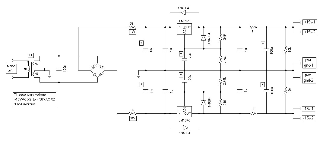

Attched are the schematics for the current version of the tone circuit and an appropriate regulated power supply.
I recommend using either an OPA2132 type Opamp like in the early version, or even better, use one of the LM4582/LME49710 types as in my current version. Those chips have better than average specs, are relatively forgiving of less than perfect circuit layouts, and better than average output drive capability that this circuit needs.

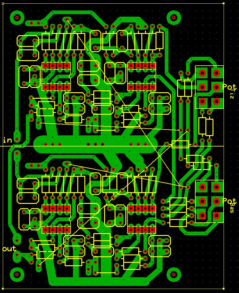

Well, I've got one. However it has never been fabbed and tested. I built my test project that drove me to craft this on vero board. The PCB measures 144mm deep by 220mm wide.
If you ever end up making boards, I will buy enough for a stereo unit. I appreciate the fact that you used connectors to allow easy connection of pots, inputs, outputs, PS voltages and ground. My only suggestion might be to add local ceramic bypasses to allow COG or X7R 2-4uf bypasses, per Tom Christiansen's recommendations on the Neurochrome website (he posts here in the vendor's section for his Mod 86 amp board).
... My only suggestion might be to add local ceramic bypasses to allow COG or X7R 2-4uf bypasses, per Tom Christiansen's recommendations on the Neurochrome website (he posts here in the vendor's section for his Mod 86 amp board).
The board is setup to take WIMA poly bypass caps. That's what those rectangular parts are at either end of every opamp.
Great! Excellent. When can I buy this?🙂🙂🙂
