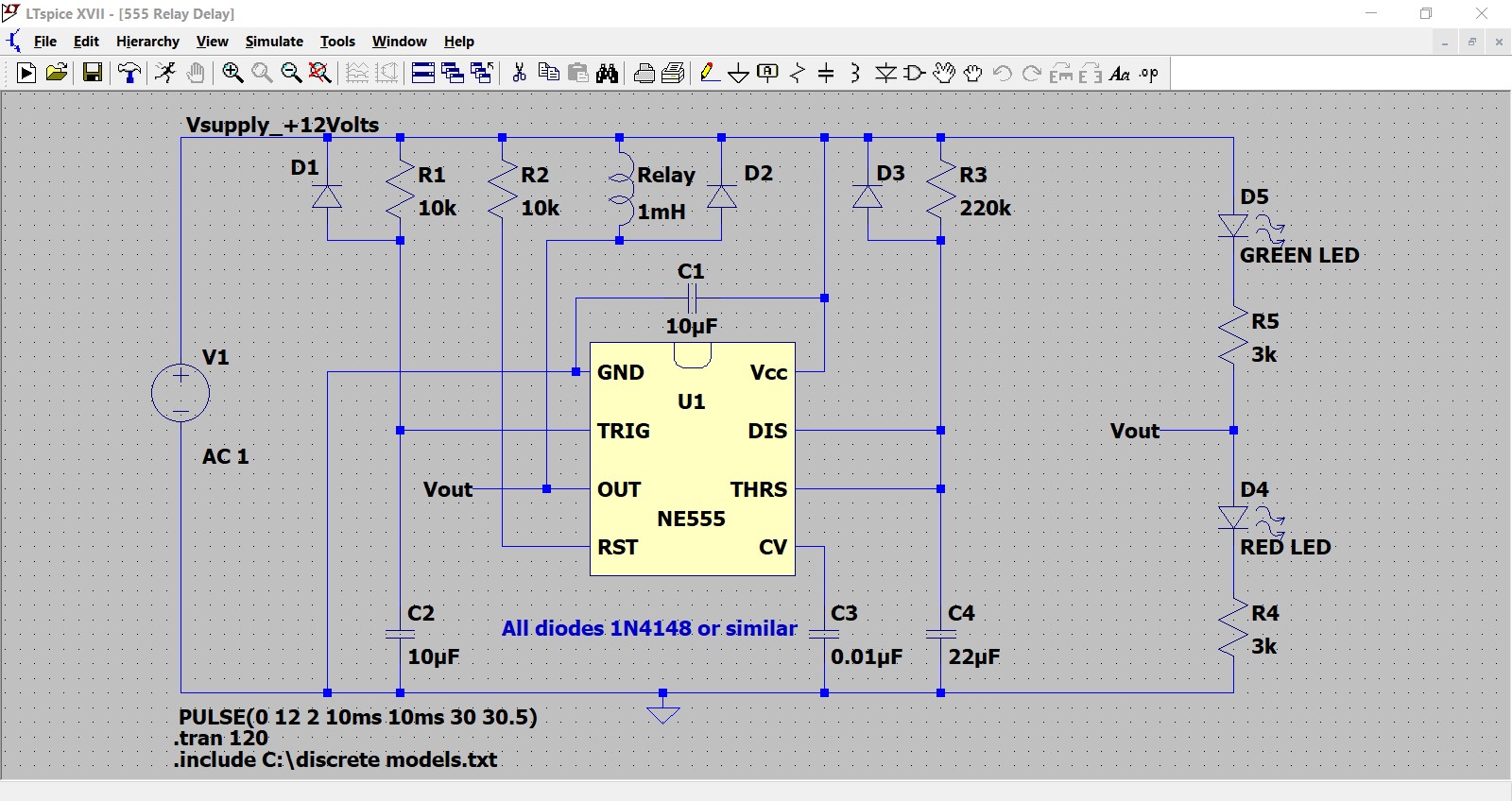

The following circuit is a copy of an LM555 (equiv NE555) based relay delay circuit I designed around 20 years or more ago for muting the output of a preamp. The design goals were reliable operation and the ability for the circuit to give the full mute period if the power supply was cycled quickly on and off. Some recent threads on diyAudio have enquired about such circuits.
The design offered here is done so as more of a 'cookbook' type of design that can be altered and changed to suit individual requirements rather than a fully documented construction project.
Practical points:
1/ Ideally the circuit should be fed from a small auxiliary supply of limited 'reserve' capacity. This means a supply of minimal reservoir capacitor size which ensures that the relay drops out very smartly on power off. A single half wave rectifier and smallish cap (perhaps just 220uF) is the kind of thing that would work well. Ensure the ripple rating of the cap is not exceeded. A little series resistance added to the supply works wonders in dramatically reducing peak ripple currents.
2/ The delay can be altered by means of the time constant of R3 and C4. You should ensure that the combination chosen is suitable. For example it is no good using a 10 Meg resistor and a relatively large and leaky electrolytic cap.
3/ The design has not been tested with either the low power or CMOS versions of the chip. In practice the relatively high draw of the original LM555 can be useful in ensuring the rail powering the device collapses quickly should the power be cycled on/off during the initial period the delay is operating.
4/ The LED indication at the right is something I didn't build into the original, however it could be useful for some. The series connected LED + resistor network seems the simplest method of achieving this and uses the fact that the 555 output switches between supply and ground thus effectively shorting out one or other of the indicators. The series resistors are scaled to suit your LED's.
5/ The original 555 has a wide operating supply range of 5 to 16 volts and a source/sink ability of up to 200ma.
6/ It is very important to decouple the NE555 very close to the power pins in order to avoid false triggering. My favourite approach is to neatly solder a small high quality 10uF cap directly across the pins.

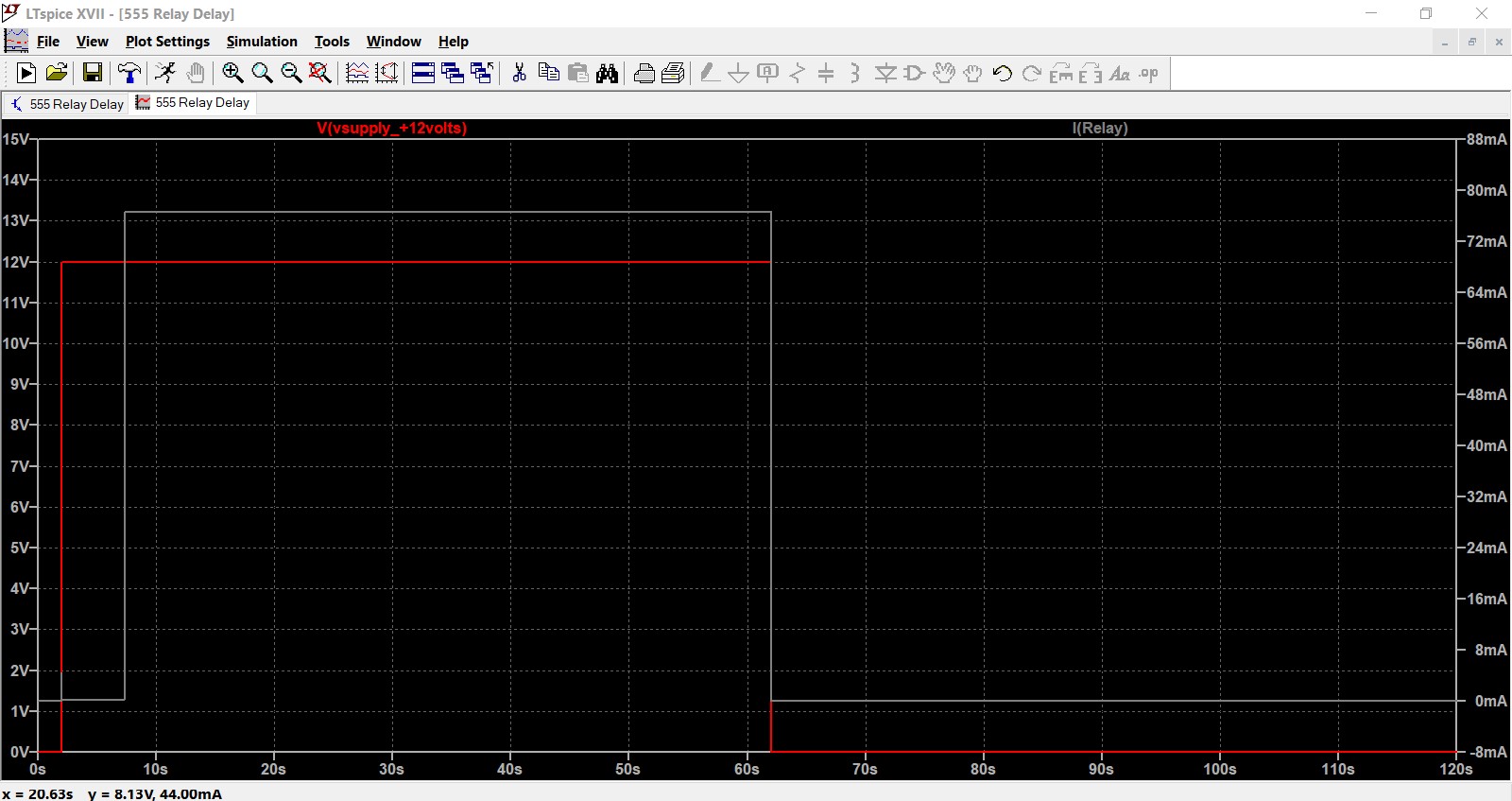

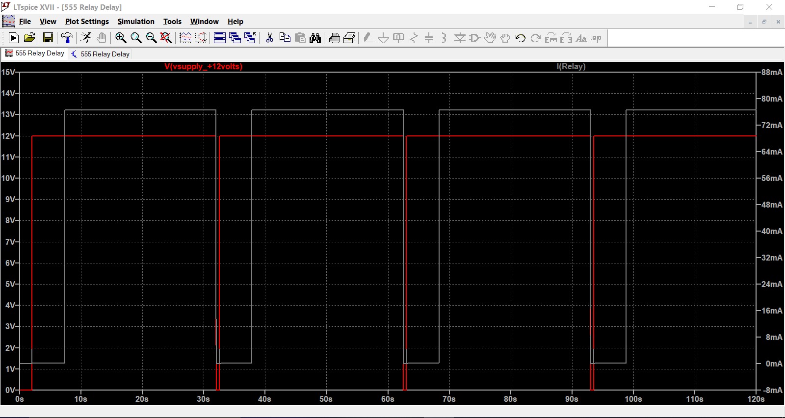

The following images show the circuit diagram, the relay current vs supply voltage in normal operation (the power is on for 1 minute) and finally the behaviour of the circuit in response to rapid cycling of the supply. This is where using a power supply with a small time constant is advantageous.
