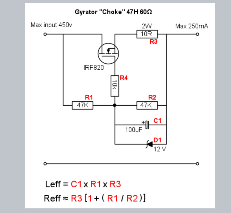

Do you mean the gyrator? A link with an example https://el34world.com/Forum/index.php?topic=21632.0
Yes this is along the lines of what I wanted to play around with. The schematic I was hunting for used an LR8 regulator and was published by a ham guy for the purpose of restoring old radios as a drop-in for the choke. But I think this one is similar enough! Thanks. Maybe I'll run across that LR8 one too.

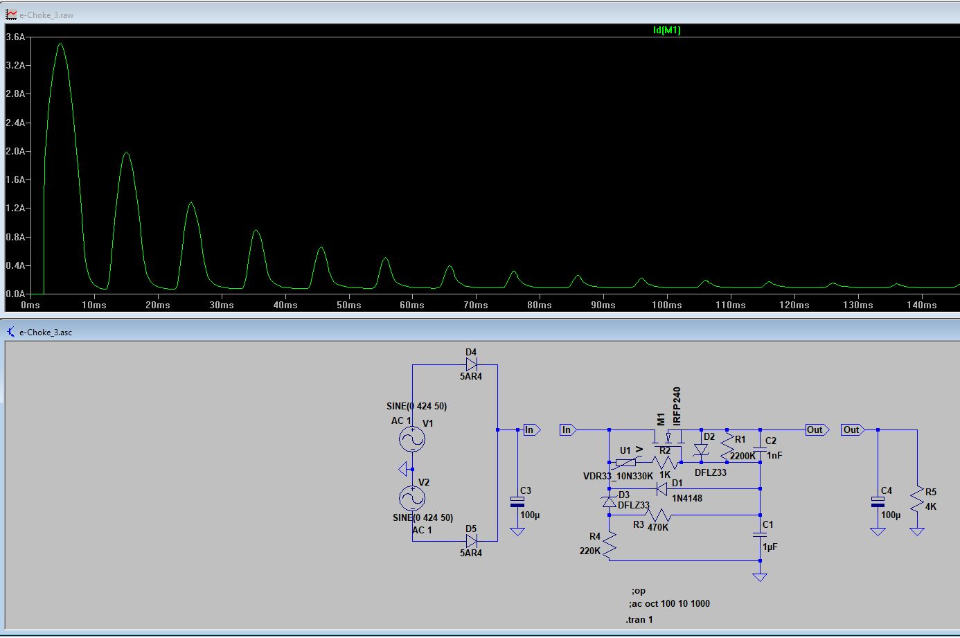

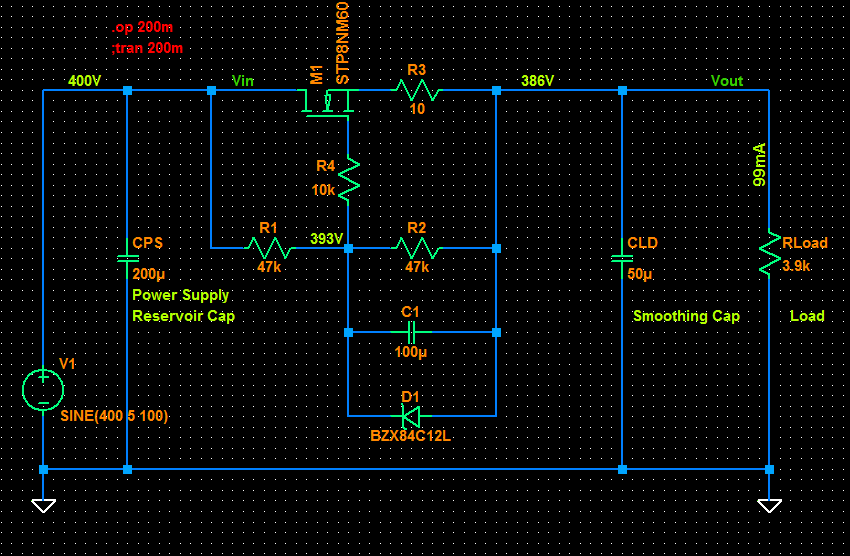

Better to understand when you complete the circuit with caps and load;
In this simulated example the input is 400V with 10V p-p ripple, the output shows 18mV ripple at 100mA of load current.
