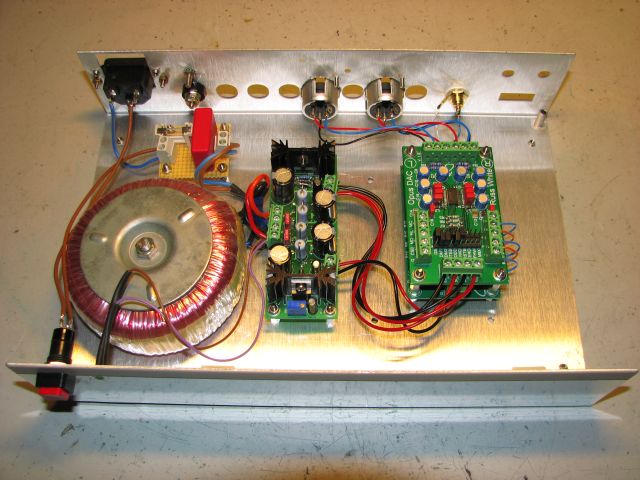

Now that I am at it anyways, I also made the Opus DAC which was just "kind of" finished today. Since I havent decided whether I want a seperate DAC or build it into the CD player yet, its just build into a network box that was lying around.
How it sounds? Simply wonderful🙂

Pretty cool Steen!
Why dont ya stick the DAC right in the pre. You certainly have room!

Thanks. Yeah I might build it into the pre, thats what Russ suggested too. Somehow I find it misplaced in the pre, but I am probably just being oldfashioned.
