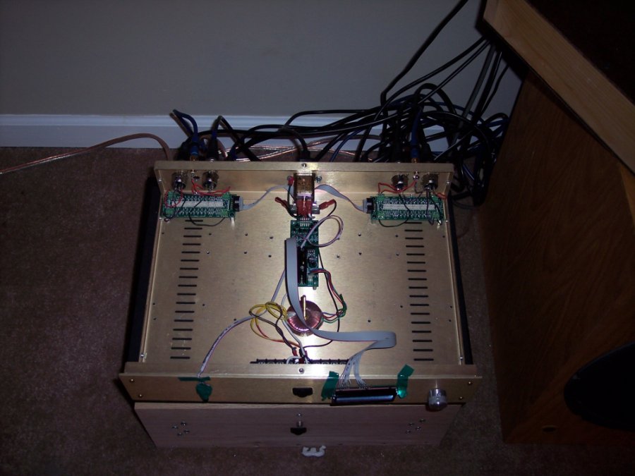

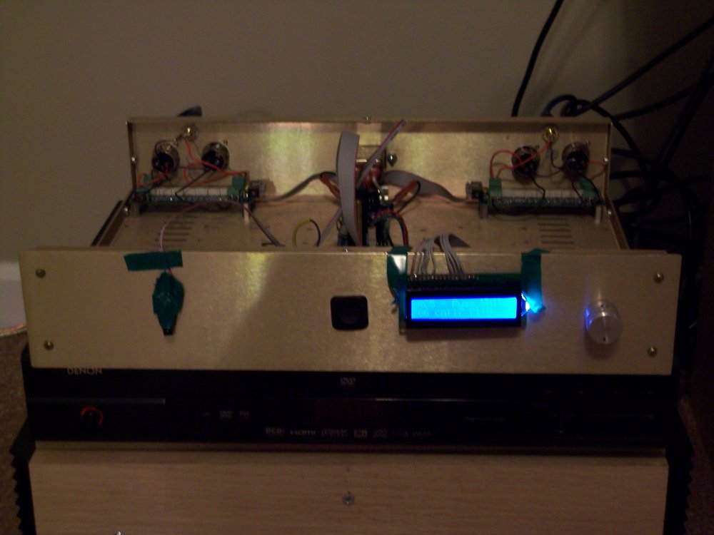

IR controller tested 🙂
Hey folks, grabbed a few hours this weekend to mod a stock JT controller PCB to make this monstrosity.
It can decode RC5 or Sony remotes(selectable) and works perfectly right now. I only have very basic firmware working right now, but it is interrupt driven(the PIC is sleeping when there is no IR command).
Anyway I will post how do it later. 🙂
Cheers!
Russ
Cheers!
Russ

Re: guts...
VERY Nice! Looks good, i love the champaign case 🙂
J'
Russ White said:here are the inards....
J'

Joined 2002
Russ White said:Jason,
Soon we will have a "master" controller with IR,RE,Display, etc and a module that will allow for control of the JT via I2C. It will likely be in the next couple months as there is a lot of design work yet to do, and other projects to wrap up. 🙂
Cheers!
Russ
Perfect, May i ask what type of display ?
