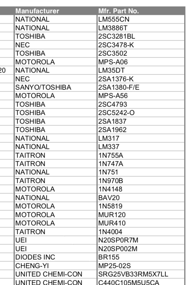

It is for sure needed to know how they selected the fets for mass production in such a "sensitive" working condition.
In its simplicity, I've always found it very musical and dynamic.
The crossover to mass production from DIY one-off project is a bit more of a challenge with FETs. But for hand assembled "small batch" electronics it's not too difficult.It is for sure needed to know how they selected the fets for mass production in such a "sensitive" working condition.
Japanese companies such as Roland, , having local suppliers and being important customers, always had the luxury of buying products preselected at the factory.
Not only Fets but bipolars too.
Notice schematics often specify "2Sxxx"(G) or (Y) (green or yellow or whatever colour) meaning fully finished, encapsulated and marked transistors were tested one by one then being marked by an extra colour dot.
That certainly makes (large) manufacturer´s life easier.

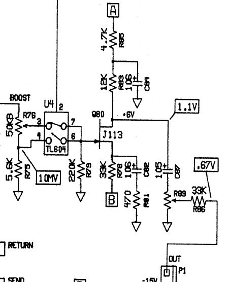

I remember the one I tried it is different, but check this:
GK 400 RB circuito.pdf
over there is a J113 supplied by dual 15V (bit less, due to the 4k7 and Ids), with 12k on drain and 33k on source, with a partial bypass. IIRC I tried another version with 47k on source but don't remember other details.

This is from a '92 GK400RB head.
When driven hard, FET gate gets positive on signal peaks , rectifies, shifts bias so shifts duty cycle, transconductance, gain, etc.
A "poor man´s tube" equivalent with nice grungy tone; absolutely different to cheap diode clipping used in later versions.

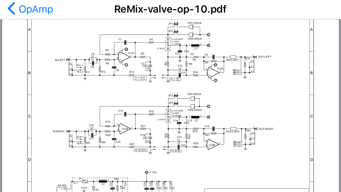

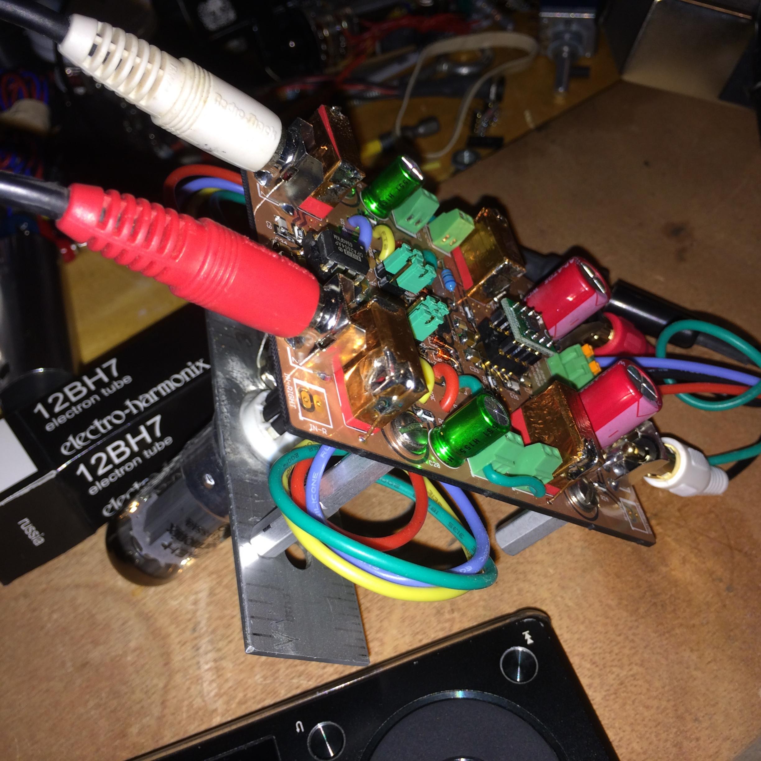

i have used current boosted tubes for years mostly with power fets and bjt.
but now using opamps.
This circuit works 100% perfect. was listening a few minutes ago.
you really only need the first stage , i put a makeup/headphone opamp stage here for connivence in case tone volume used.
u can roll with pentodes too by using screen as plate.
The output is the error signal from opamp driving to tube to linear.
but the linear output is discarded leaving that wonderful tuby sound.
every tube type has its own sound that you can see in fft plots.
30v potential works fine. (+-15v)
Very low current is used so bias is always negative with no positive grid.
The 12BH7 is my favorite sounding so far. I use 700ua.
Clipping is a different story so this is not for effects box etc.
