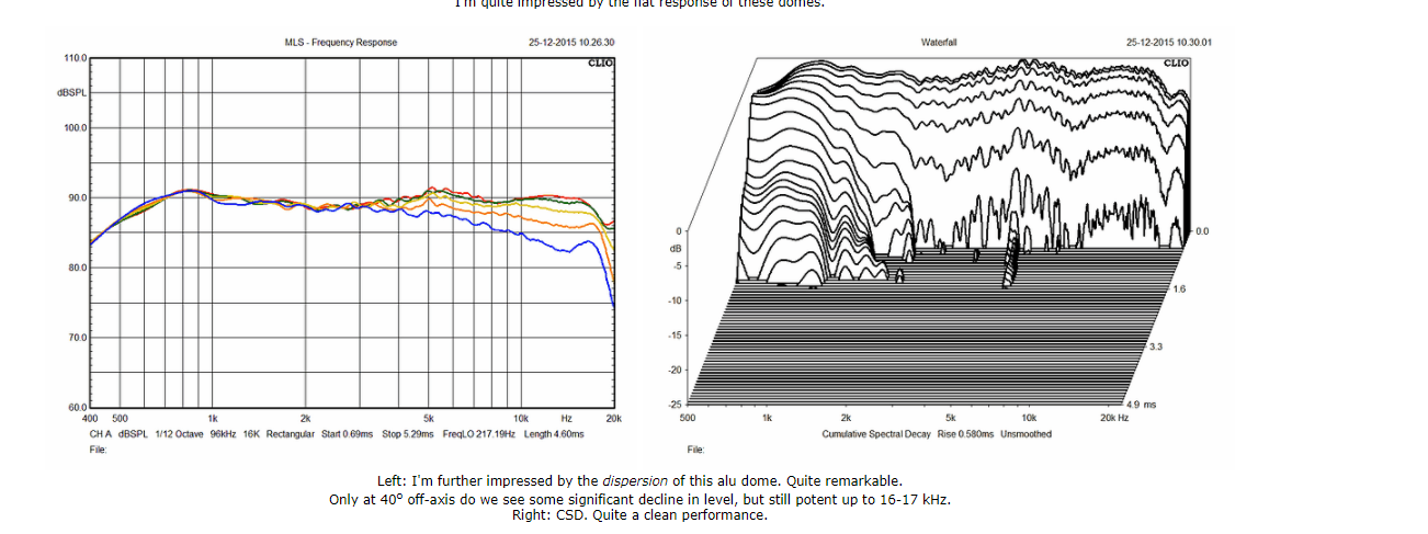

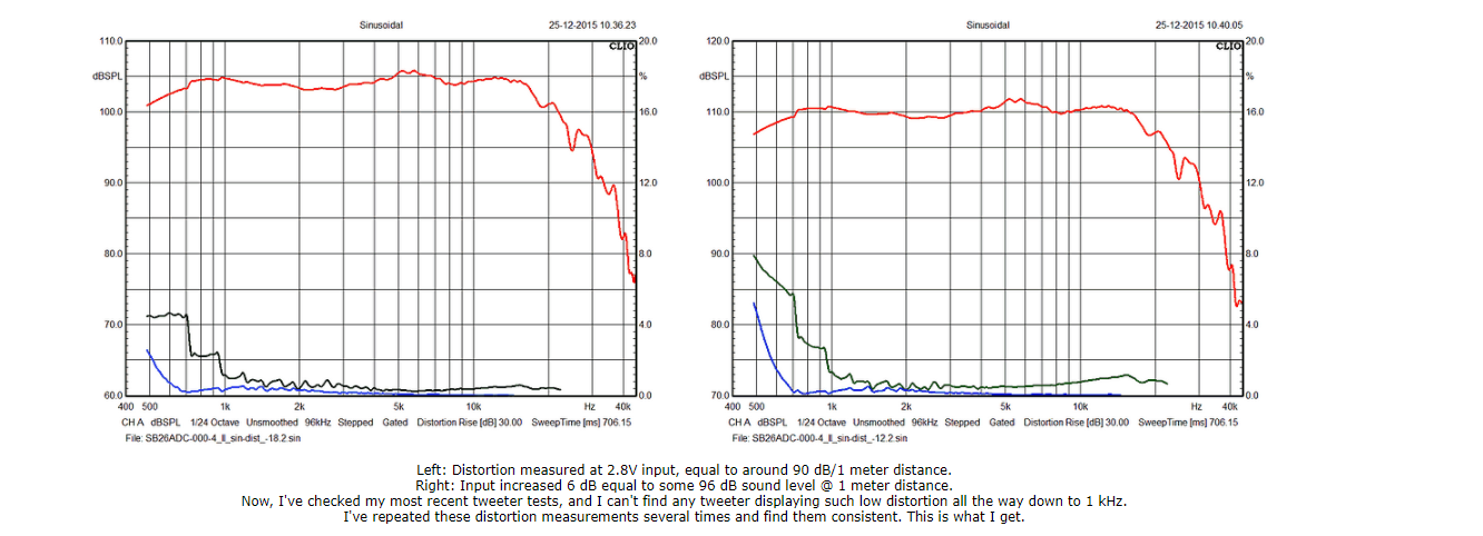

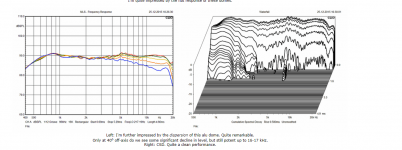

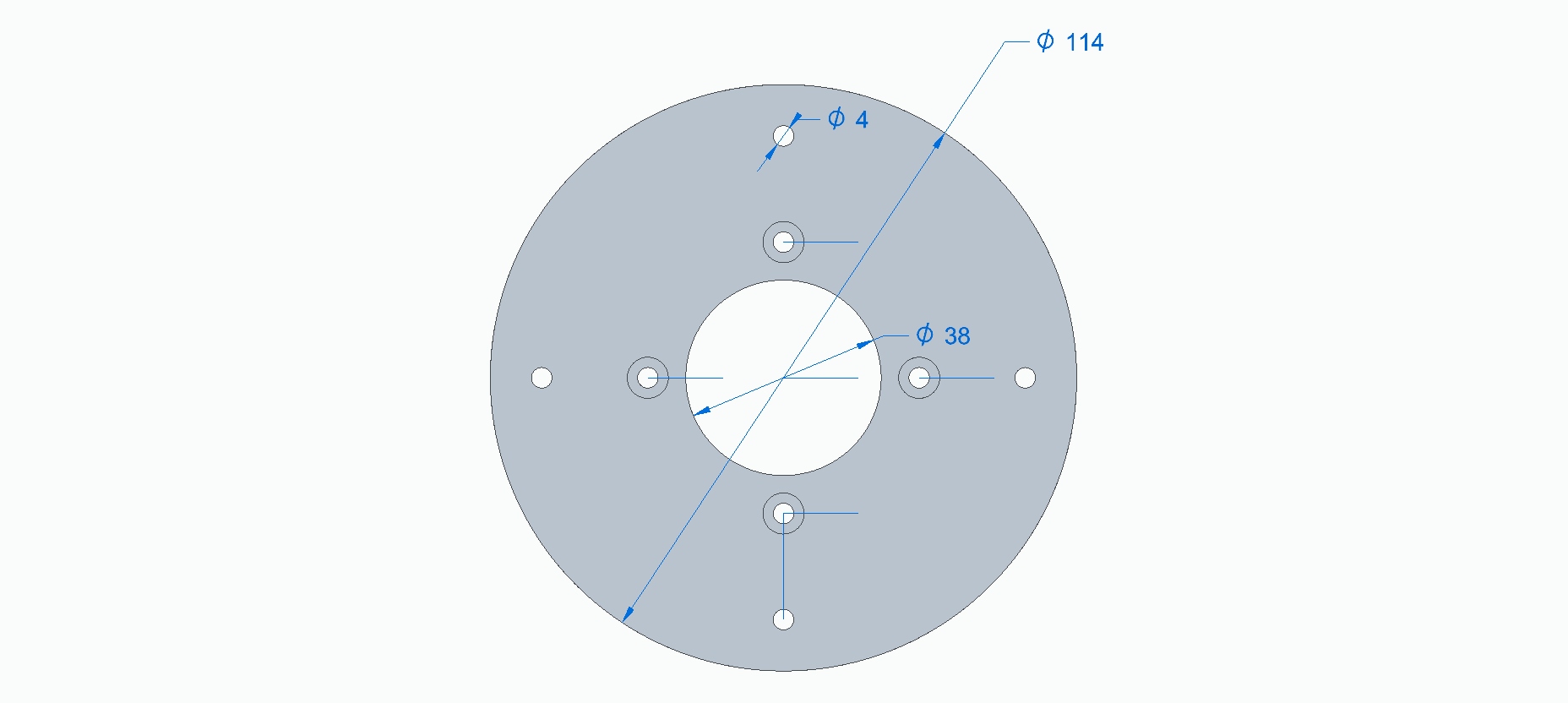

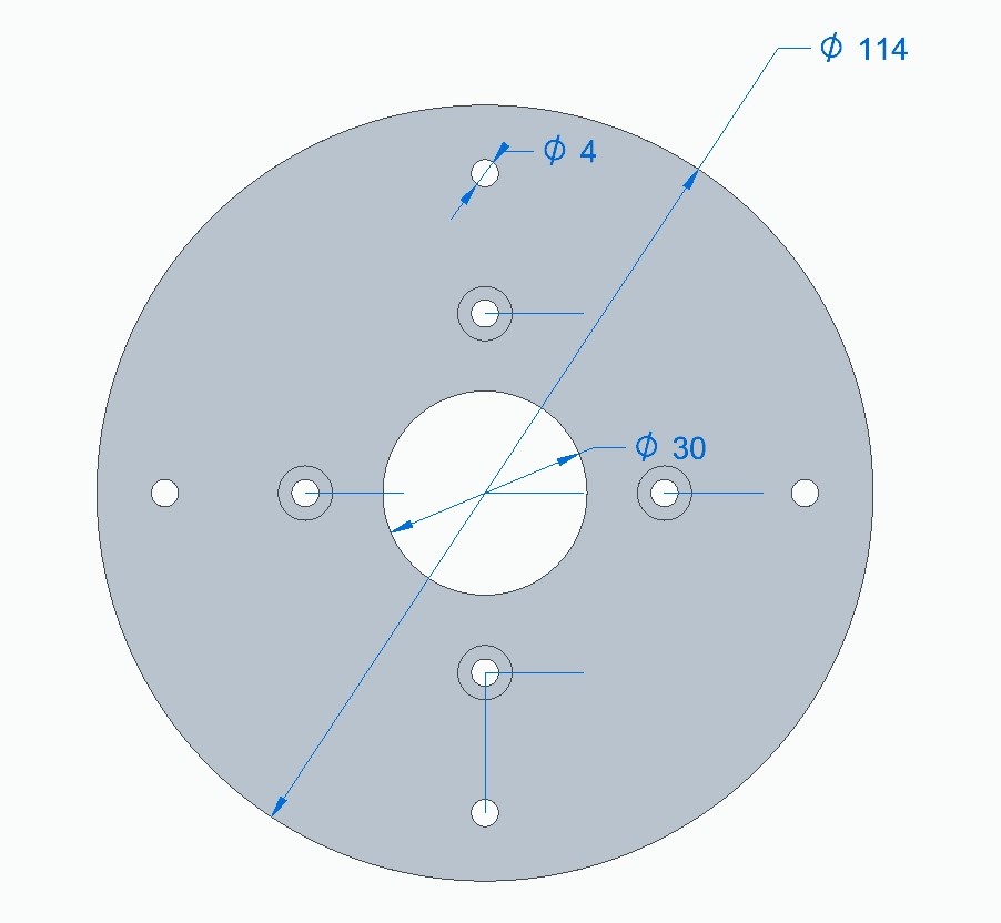

wel, i'm still looking at options. I tried to design an adaptor plate for that visaton waveguide. it will be 4mm thick to fit the screws. is that an issue with this kind of waveguides?
wel, that is what i try to do, i see the frontplate of the SB26 tweeter is 3mm thick, so i'm going to adapt the design to that, but for the rest it looks like i had the same id. I did also enlarge the cutout for the dome to the size of the visaton hole (38mm)
I have the tweeter here so i did measure it in reality, not on the drawings.

If you don't find a way to do this by yourself (or a workshop around you) there is still another option: Schaeffer apparenbau.
I've had them to make multiples racks front plate in aluminium for my gear and some plate in perspex ( plexiglass) for mics and loudspeakers.
It is in no way cheap but the work is top notch quality wise.
I see that there are many 3d printshops that work from online. You just need to send the stp file. Some have a good reputation.
So it's a matter to adjust my design to perfect before i send it. But it ads another 40€ or so to the price of the project. + i need to buy those waveguides. So maybe it's better to just let them print some good waveguides for this. And i also wonder what would be the best material to use to print these waveguides.
