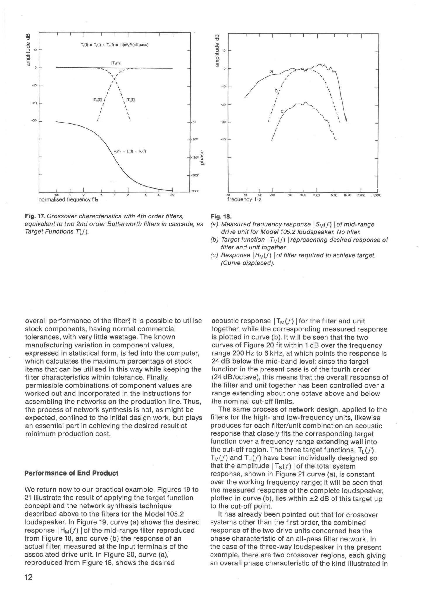

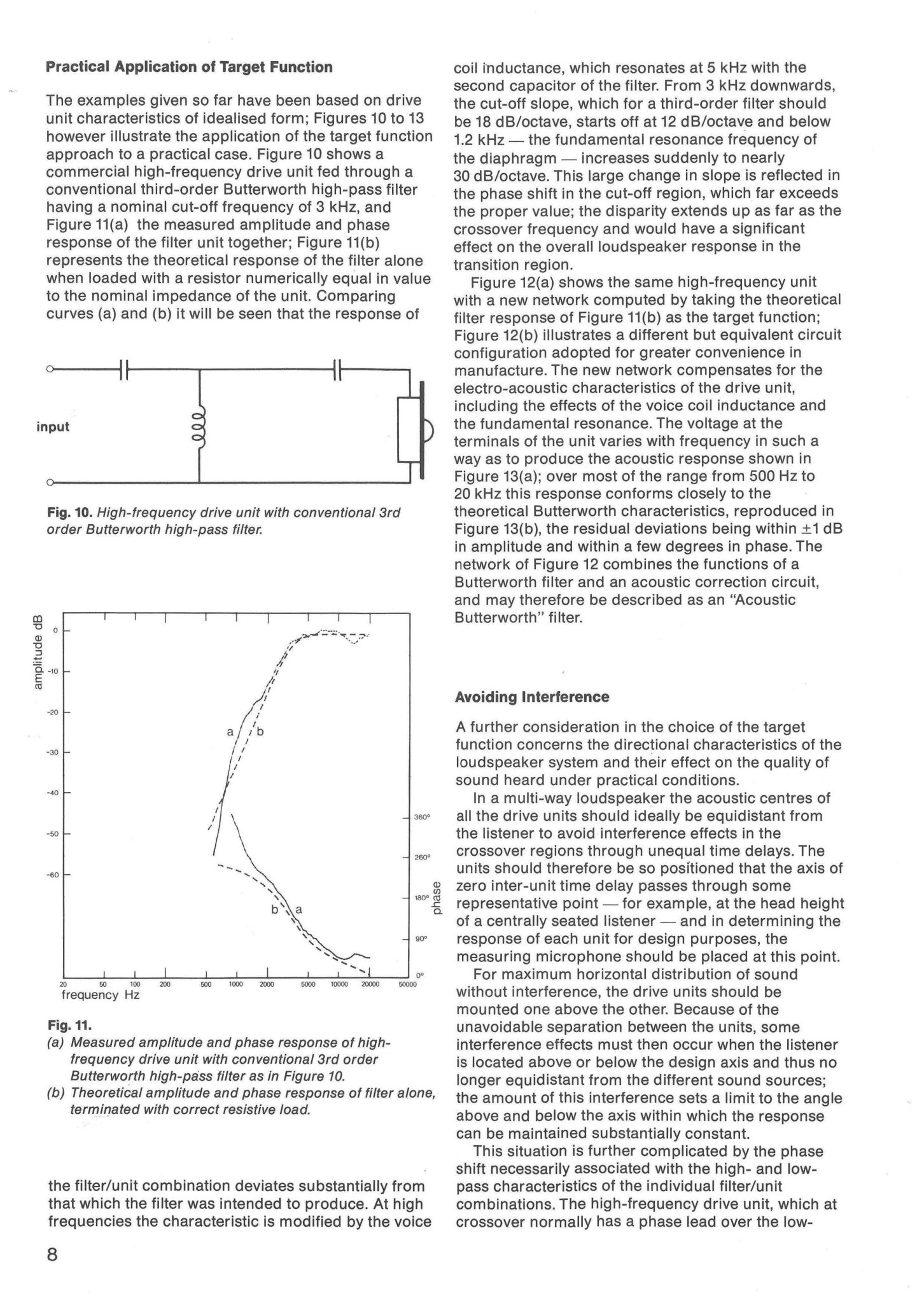

In most cases text book filter slopes combined with real drivers will yield sub-optimal results: the filter transfer function and the drivers' need to be optimized (read: tailored or optimized) to achieve a textbook e.g. 4th order final acoustic roll off. This is what filter simulators that are based on import of driver measurements (.frd or .txt and .zma files) have done for decades now. KEF showed the way as early as 1978.
