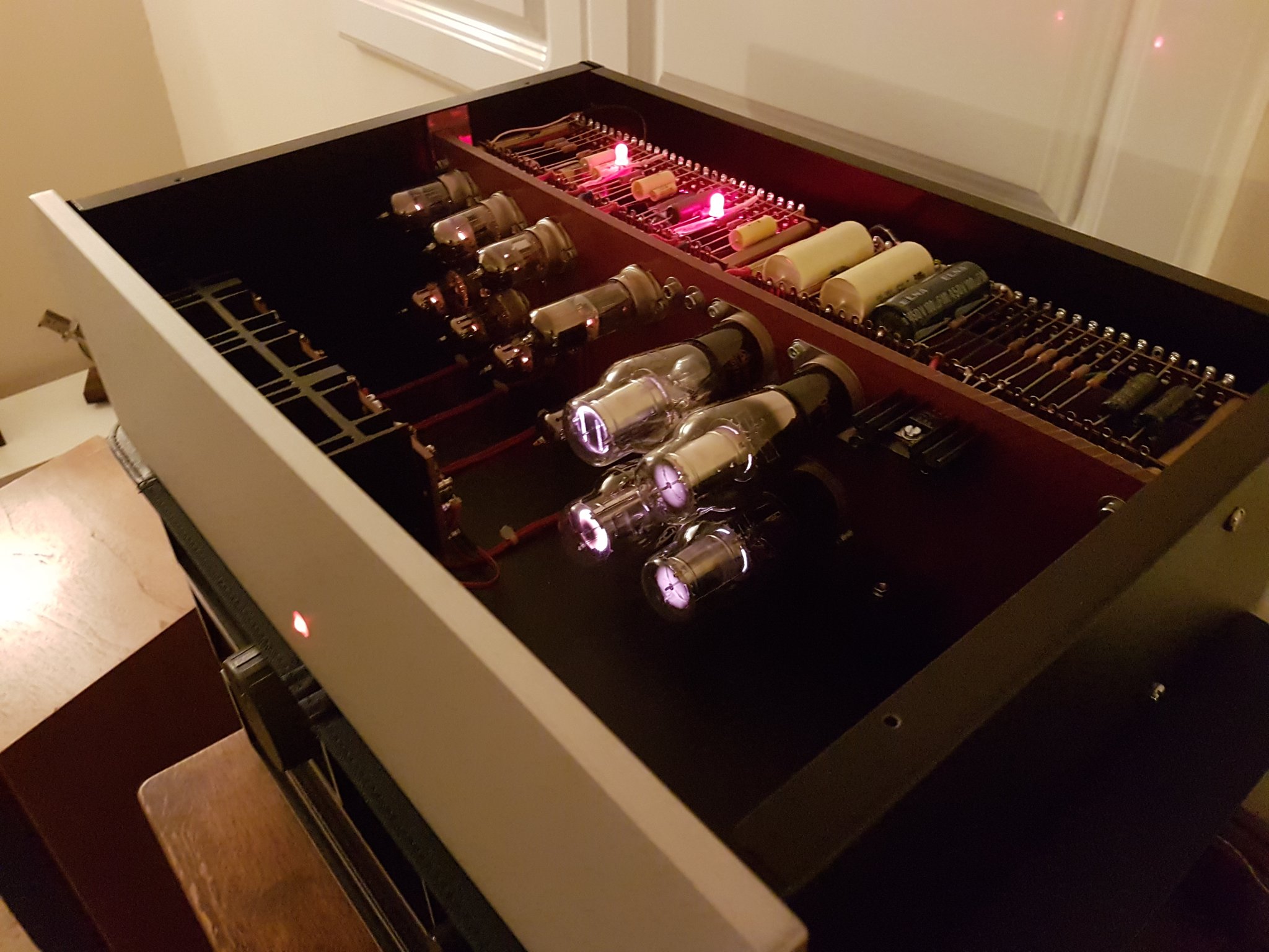

I can’t believe this thread is 9 year’s old! Well, here goes. For what it’s worth, and if anyone is even remotly still interested I did eventually just this year get the preamp fired up. It’s been sat on the things to finish shelf for 9 years.
I took the plunge and ordered a custom transformer with 4 independent heater windings, and a single HT winding. Outboard PS is a simple crcrc HT supply, with 4 dc heater supply’s connected to the preamp via a 12 core umbilical.
Results? Well I can report the single 6c45p input tube is very surprisingly unearthly quite! That’s with a common or garden Denon DL103, overall gain of this pre is a high 65db with ecc88/6n6p or up to 70db with 2x ecc88s. Out of the 8 x 6c45p I have, all 8 are very quiet, no rushing noises, heater crinkles, popping or microphonics other than a dull dong when provoked with a finger.
I have not tried 4 sections of ecc88 in parallel so I cannot compare, but I have tried 2 sections of ecc88. To my ear and memory a single 6c45 is much quieter and much better behaved, even with very quiet music passages noise is totally unobtrusive, well below record surface noise, what noise there is, with ear close up to the speaker is quite low pitch, possibly due to the RIAA eq.
Of course this thread was about a dedicated mc head amp, the 6c45 has perhaps too much gain for a stand alone head amp, but it does make a great mc front end tube.

I am reasonably pleased with it, though i am considering a mk2. No it's not the Sound Practices circuit. Its 3 mu follower stages, with two stage passive riaa.
Input is s single 6C45p with another 6C45p as active load, output taken from anode of lower triode, 75us passive Riaa. Followed by an Ecc88 mu follower but again with output from the lower sections anode, then the remaining passive Riaa, followed by a 6n6p mu follower output.
There is a separate heater supply shared between channels for each valve, all referenced to different voltges, so 4 separate transformer heater windings are required.
Ht regulation is a pair of glow tubes per channel each pair fed from a mosfet/TL431 constant current source.
Its much quieter than I thought possible without parallel valves. For my taste noise levels are quite acceptable even with very quiet records.
At domestic levels, silence from 2.5 meter listening position, just a faint low pitched hiss with ear against speaker.

Can you post a sketch of the circuit? I've been running a little breadboard using a repurposed 12at7 SRPP as input/driver disconnecting the output from the upper cathode and taking it instead from the output from the plate of the lower triode , making it a sort of mu follower though of less complexity than what is usually talked about as one.mu follower but again with output from the lower sections anode
Hi, just an OC3 VR105 and an OD3 VR150 in serise, with a small bypass cap shunting the pair. The driving CCS is set to 43ma per channel pair. The phono draws around 30mA per channel. The glow tubes strike instantly at switch on.
No particular reason for choosing octals other than i have a few to hand and have found them to work well in the past.
I will try and draw up a readable schematic as the original working drawing has been changed somewhat.
