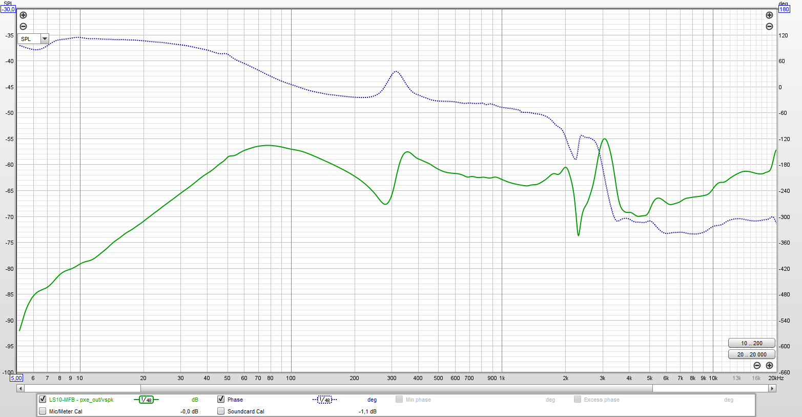

A tiny three way with a twist
Ah now I see how this works. I was wondering how you got the signal out. You basically create a new set of tinsel leads and terminals through the cone and on the basket.
Yes. It was quite a tedious job. The TangBand W5-1138SMF basket and cone are close together, and the magnet is relatively big. No space to put the connectors. No space for the coax wires and no space for anything. 🙄
