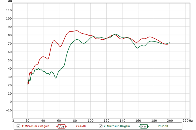

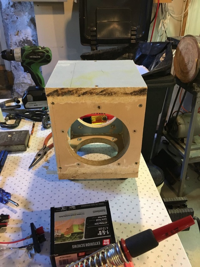

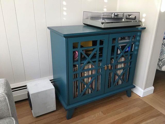

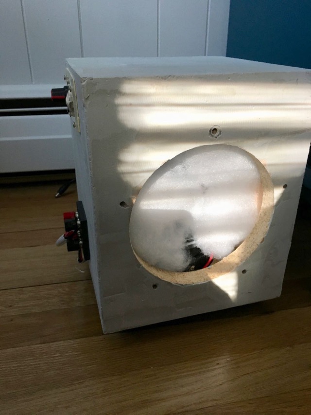

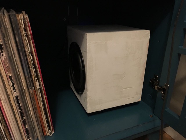

Thanks for all the inspiration. This is my first post in your community, and TL;DR - I built a tiny subwoofer based around the W5-1138SMF. It sounds pretty good, and the wife approves of the size. It uses two 6-1/2" Dayton passive radiators (on opposing sides) to vent the 5-1/4" down-firing driver. With a 100W digital amp board it has more than enough headroom for my listening space.
The sub plays at useful volumes between 60-120hz, relatively flat and extends to below 40hz. It integrates nicely with my main speakers, which roll off around 70hz.
Music sounds smooth with no noticeable distortion at any volume. I made a full write-up on my personal blog, but can expand a little bit more here, and would welcome any questions (especially since I'm terrible at documenting my personal projects).

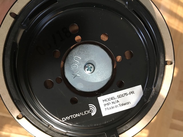

Total volume for the enclosure is 0.19cu ft. I added 28g to the back of each PR, but based on modeling in WinISD I could go as high as 100g. I'm slightly concerned about adding that much weight to a 6.5" speaker, since the spider doesn't seem built for those kinds of forces. There's still a bit of a response bump around 60-80hz that I think would decrease if I could tune the PRs a bit lower.
