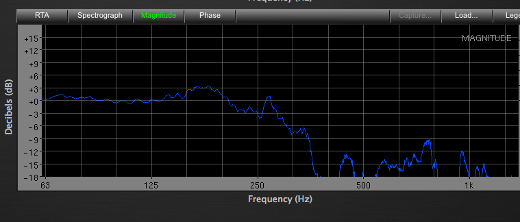

The frequency response chart below is from a 2x15" PPSL with a 7.5" x 15.25" x 15.25" plenum.
Art

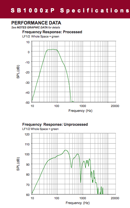

No, the same concept has been used in EAW's SB1000 cabinets for many years, though both cones face the same direction in their cabinets.By having the backwave next to the front wave, won't there be some serious cancellations over a substantial amount of the bandwidth?

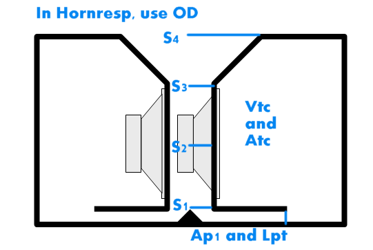

I someone wants to see what this will do, here is the basic layout that can be used in Hornresp for this enclosure:

Adding the Hornresp Simulation

May I just check if that is un-EQ'd, close-mic measured output up to 1kHz?
If so, I presume the roll off above the peak is the LPF-effect of the slot/plenum?
I still haven't got my head round how a plenum acts as a LPF - in my head, bass frequency waves are 'bigger' so would be more constrained within a small slot, but it's the opposite?! 😕 😱

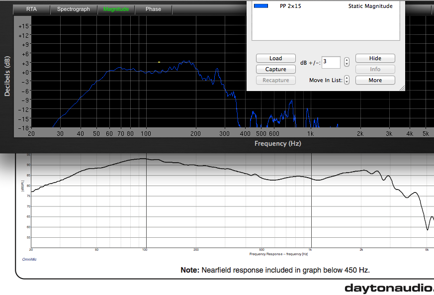

1) Speaker cabinet and mic were outdoors on the ground ("ground plane" measurement), mic is 2 meters from the cabinet front.1)May I just check if that is un-EQ'd, close-mic measured output up to 1kHz?
2)If so, I presume the roll off above the peak is the LPF-effect of the slot/plenum?
3)I still haven't got my head round how a plenum acts as a LPF - in my head, bass frequency waves are 'bigger' so would be more constrained within a small slot, but it's the opposite?! 😕 😱
2)Yes, the roll off above the peak is the LPF-effect of the slot/plenum, the factory response graph of the speaker is compared below to the PPSL.
More details are available in this thread about the cabinets:
http://www.diyaudio.com/forums/subw...using-dayton-pa385-8-drivers.html#post3898842
3) Low frequency waves are too long for the plenum to have any effect, it boosts the upper bass response of the speaker up to around 160 Hz, then band passes above. Even though Hornresp models circular enclosures, it still gives a fairly good prediction of the location of the peaks and dips which are specific to the plenum volume and depth which react like a stubby horn.

My Posts #529 and #532 are wrong. This is not the way to simulate the enclosure from Post #522. Sorry. but that will not work.
