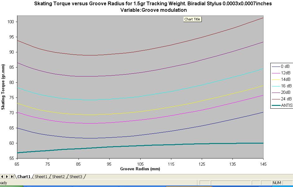

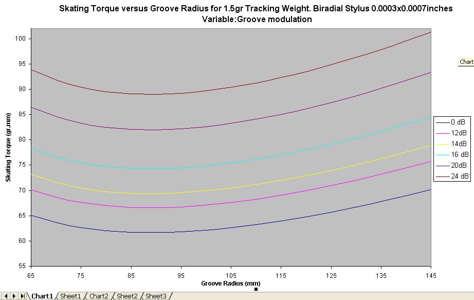

Hi all
Trying to adjust the antiskating force of my “SME 3009 II Improved” to suit the needs of my SHURE M97xE which is equipped with a brush damper, a few theoretical questions arose. Surfing around for answers three articles caught my attention:
1) B.B. BAUER: “Tracking Angle” (ELECTRONICS March 1945) [http://www.helices.org/auDio/turnTable/bauer.pdf]
2) J.K. STEVENSON: “Pickup Arm Design” (WIRELESS WORLD May-June 1966) [http://www.helices.org/auDio/turnTable/stevenson.pdf]
3) JOHN WRIGHT: “Bias Correction and Dynamic Conditions” , HI-FI NEWS October 1969
[archived at 09 March 2004 at www.Vinylengine.com]
In 1) Mr. Bauer provides the means to calculate the skating force across the arm’s travel, provided coefficient of stylus friction "mu" is known (he estimates a value of 1/3).
In 2) Mr. Stevenson estimates the lateral thrust (i.e. skating force) as 20% of downward pressure.
In 3) Mr. Wright explaining the results of his experiments, he comes to some conclusions, which seem to contradict Mr. Bauer theoretical calculations, like ” Bias force is therefore substantially unaffected by the surface speed” and “Bias force is therefore substantially unaffected by the playing radius”. The reason of the discrepancy is that these results (as also Fig. 5 and Fig. 6 of Mr. Wright article) are based on experiments conducted on unmodulated record grooves. At the end of his article Mr. Wright deals with modulated grooves and their effect on skating force. He concludes that “Bias force is therefore substantially directly proportional to modulation velocity-at least for sinewaves” . His Fig. 7 provides experimental data for friction coefficient ”mu” .
Combining formula from 1), and ”mu” data from 2) the attached drawing was produced. The 6 thin curves represent the skating torque produced when an elliptical 0.0003x0.0008in stylus hanged on a radial arm with the geometrical data of an “SME 3009 II Improved” is reading a record with grooves modulated with signal of varying modulation levels (0dB refers to 1cm/sec at 2 kHz).
Two things become easily evident:
a. The skating torque variation due to modulation variation is 30%.
b. The curves follow the form of the well-known tracking error curve.
Both smell trouble.
Practical antiskating mechanisms do not adapt automatically to increased skating torque due to varying groove modulation.
Practical antiskating mechanisms do not provide an antiskating torque, which follows such a curve.
(Continues)

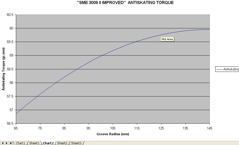

I measured the antiskating arm length and the antiskating weight of my “SME 3009 II Improved” (arm 22.225mm/hanging weight 2.75gr). I did some calculation and a diagram of antiskating torque versus groove radius for 1.5gr tracking weight was produced (see attachment).
(Continues)

Combining the two diagrams in one the following attached diagram is produced.
The antiskating torque of SME arm is shown by the thick green curve. It shows that antiskating mechanism under-compensates the theoretically calculated skating torque produced by an elliptical stylus 0.0003x0.0008 inches.
(Continues)

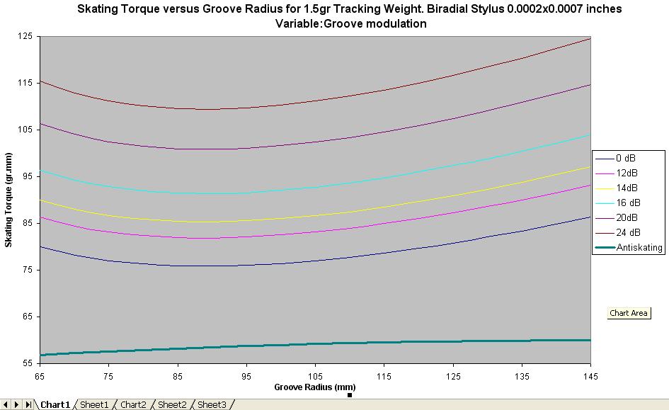

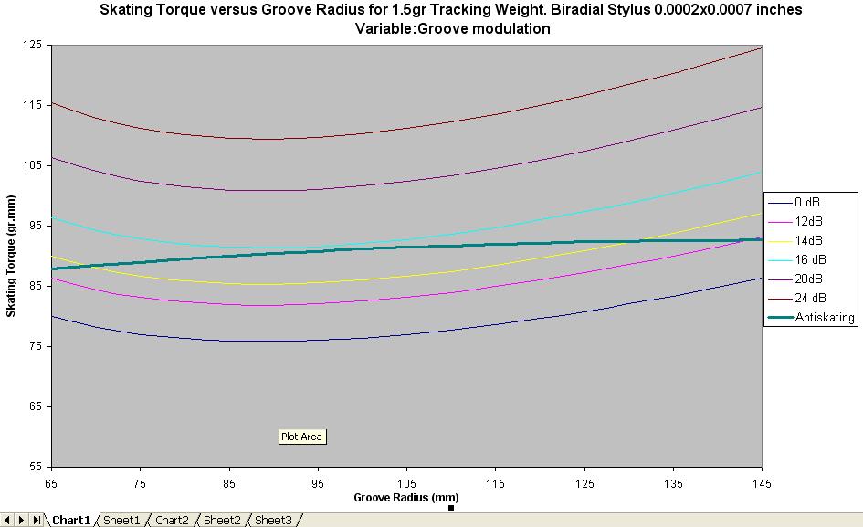

This under-compensation becomes more severe when in the theoretical calculation of skating torque, man plugs in the friction coefficient for a stylus 0.0002x0.0007inches as is the case for my SHURE M97xE. The attached diagram shows this.
(Continues)
