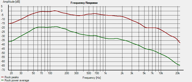

I ran another analysis of music tracks. This time mostly 60-90s rock, about 100 tracks. Below you'll see peak values of the tracks (red) vs average (green). I've smoothed it 1/3 octave.
Average level is about 20dB below peak, which indicates that the recordings are fairly dynamic and not overly compressed. You'll also see that the peak values have a somewhat flatter response than average levels.
For a three-way system with you crossover points, I'd say that if all sections had equal sensitivity, the bass section crossing at 250Hz would need 4-6dB more headroom than the mid and tweeter sections. The tweeter section will certainly see the least overall power thru the voice coil, but down toward 1100 Hz the peak values will be the same as the midrange, so you need just as much headroom to play them clean.

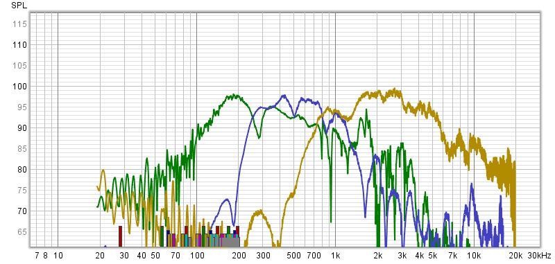

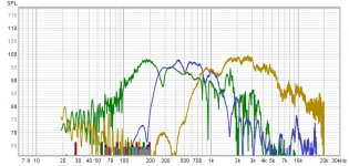

Hi Pano,
Managed to get my midbass horns out in the garden on top of a table with the meh horns sitting on top. I'm a bit frustrated with the measurements (the midrange measured a lot smoother on their own the last time I measured, and the midbass horns measure a lot nicer with a groundplane measurement than up in the air....)
Anyhow, these are the plots for midbass / mid / tweet with no EQ/XO and the exact same signal given to each section.
Looks like the tweeter will be the weak spot once it's EQ'd flat to~10k..
Rob.

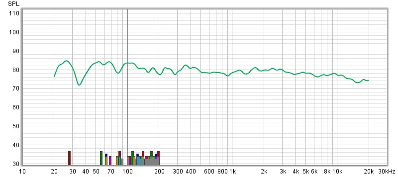

Hi Pano,
Have started setting up the speakers in room. Only the left channel connected. Played Pink Floyd Comfortably Numb at 2am Party levels and measured the voltages at the speaker terminals with the 2 test tones.
Crossover points are 80Hz and 270Hz on my speakers. I've posted an in room 1/6 octave smoothed response of the setup so far.(I've lowered the tweeters a couple of dB since the measurement but that won't affect the results here..)
I measured the sub/midbass at 120Hz, and the midbass/midrange at 220Hz.
The test tones were quite loud! I thought they'd be quiet ....
120Hz : Sub 0.1V, midbass 2.3V
220Hz : midbass 2.26V, midrange 1.18V
Rob.
