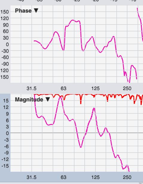

OK, a bit of a voltage test goof I hope folks find amusing/interesting.....
I needed to do a little glue repair, spider-to-cone, on an 18" driver from a double 18 sub.
Pulled the driver, glued it, and set it on top the sub, which is physically located about 10ft away from the other double 18" in the room.
Started cranking some tunes using just the one good sub, but began wondering if passive resonance would move the driver under repair any, to the detriment of the glue setting up.
So I put my finder on the cone, and felt next to no movement. But I noticed the other driver in the sub cabinet was resonating quite a bit. Cabinet works I thought happily!
In fact, the in-box driver had so much passive resonance, I decided to measure the voltage it was putting out while cranking Red, Red, Wine 🙂
Over 3v rms peaks at least 50ms long...along with an average rms right around 1v.
Coming out of the driver, not going in LoL

😱 Wow, the driver was moving that much from just the airborne bass?
Yes, a full volt output !!! Crazy huh? I only measured it because the resonant vibration felt so strong to the touch.
I even took a transfer function Lol....
this is the electrical output of the driver, vs the reference signal going to the sub that was playing across the room (loudly 😀)
Obviously ignore the relative levels. But one interesting thing was the transfer function was stable...note the coherence in sub range LPF @100
