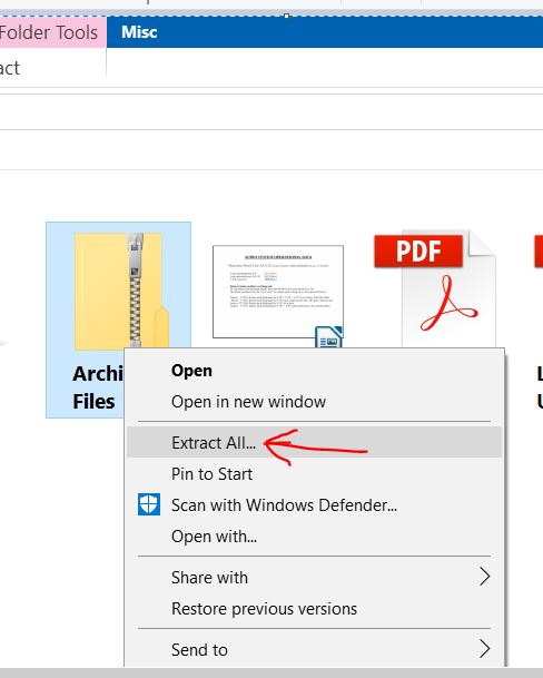

(the zipped files just need unzipping in Windows. Right click the file and select 'extract')

Aha, I don't have Windows on my chromebook. Will the wav file be ok? Do I have to set the level by listening to some music on a wav file as well then?
