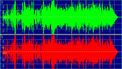

Thanks Mooly and Vladimir. You have seen the old rule that classical music needs a bigger amp. 🙂 Why? Because it's recorded at a lower average level than most other music, but the peaks still go all the way up. To play that lower recorded level up were you want it, and not clip the peaks, you need a ton of headroom.
Heavy Rock has always been recorded with a high average level, very little dynamic range. You won't need a lot of headroom, but you will need an amp with a good power supply to keep rocking along at that level all the time.

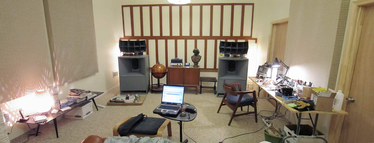

It does seem that "loud enough" is fairly consistent from room to room, tho. I know that I can stand a much higher SPL in a big space than a small one. My room is about 300 cubic feet and with decent sonic treatment. 105dB peak is about all I want. In a bigger space, that might go up 10dB.
See room below.
See room below.
Thanks Gazon. You should have seen it before I remodeled it. A ratty old garage. It could be classier, but I feel uncomfortable if it's too neat and clean. 😉 The mappemonde (globe) is a bar. Great place to hide the booze.
