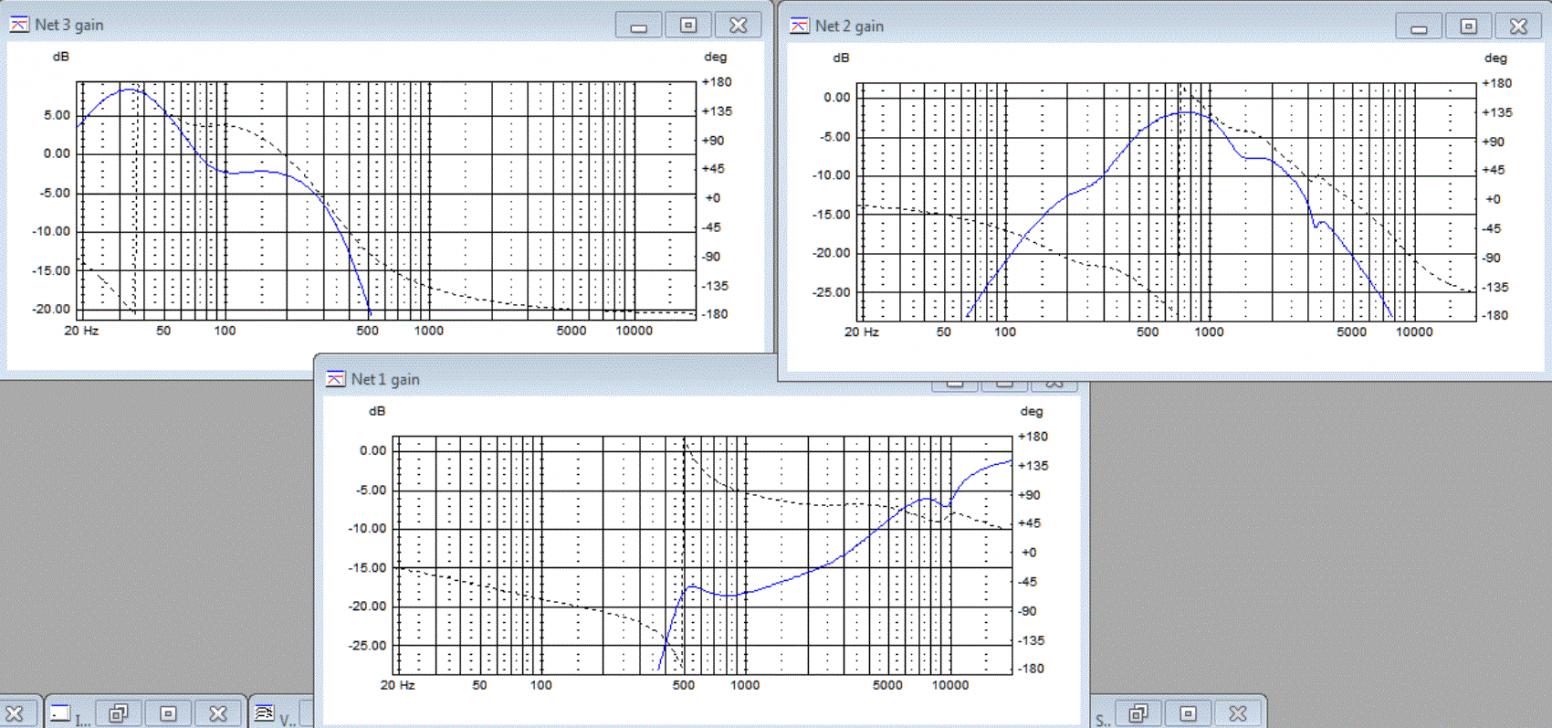

As we've had active loudspeakers mentioned quite a bit here it's worth examining them in a little more detail perhaps as my loudspeakers are active too.
Below you will see the transfer function/gain of the individual networks within the main three way part of the loudspeaker.
attachment.php
As can be seen the gain varies by a huge amount vs frequency over the bandwidths that the drivers are asked to reproduce and as a result the voltage the amplifiers will be asked to reproduce vs 0dBfs will also change considerably depending on the frequency. So what do you do?
First lets look at the midrange driver (net gain 2) as this is the easiest one to make this work for. It can be seen that the point of maximum gain for the midrange is at around 750hz. This is useful because music easily has the potential to contain a lot of energy at this frequency. As a result it would make sense to run this test for the midrange driver at 750hz and it would give accurate results.
Next lets look at the tweeter (net gain 1). Here we've got a huge problem. As you can see the gain goes up as frequency increases (and by a large amount too), but at the same time we know that on the whole music contains less and less energy the further up in frequency you go. If I wanted to play this on the safe side I could measure at 20khz, but by doing this I would probably oversize my amplifier requirements considerably. If I did the measurement at 10khz for example I would need an amplifier with half the voltage swing then if I had done the test at 20khz.
It's similar for the bass driver too, here there's a LT circuit in place that adds a peak of gain at 35hz. But once again most music doesn't have a lot of content down that low, but then again some will. Here I am saved by the laws of physics though because in its specific cabinet that driver runs into xmax with around 28Vrms, which is what the amplifier can provide, so in that sense it's an easy enough task to size the amplifier for the driver.
For the tweeter however this test is showing one of its limitations and a scope really is required. In this case it is more informative to play a wide variety of music through the system, at the max volume, with a scope hooked up and see how high the peaks reach. Don't get me wrong however, using the test at 20khz would have given me an absolute 'worst case' requirement for the tweeter amplifier and would be the 'safest' bet, but it would also oversize it for the vast majority of music.

5th-E. Thanks for the 3-way system plots and explanations. This is where I hoped we would be about 25 pages ago. 😀
Yes, and active crossover system is going to be much harder to calculate, especially at the top end. You explained that very well. :up:
