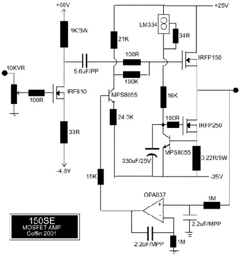

It works!
Just add a resistor at the base of Servo BJT to gnd.
Only left some huss and hum problem to fix......
