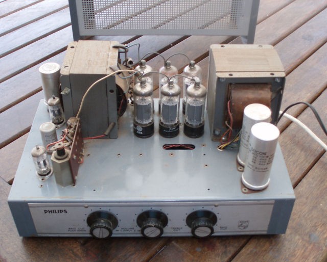

A good buy
Not to thread jack but just an example of what you can pick up cheap if you don't obsess over the "correct" tubes etc.
I paid AUS$60 (US$67) for this yesterday. 3 pairs of 6CM5 in parallel push pull.
Ian
