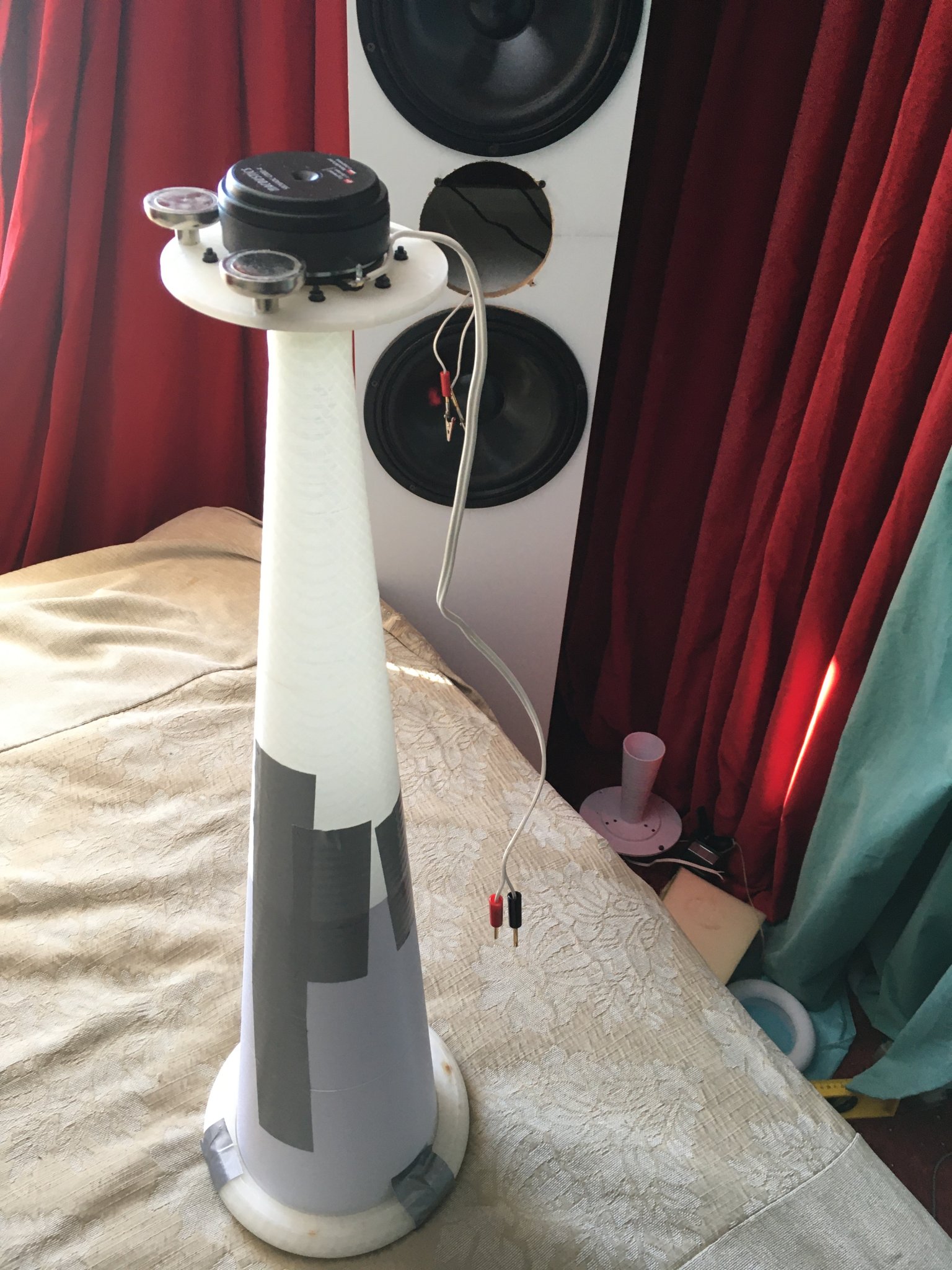

A tale about non-constant directivity waveguide and horns
This thread has the purpose to investigate non-constant directivity waveguide and horns.
I got interested since it is inevitable to avoid the transition from high directivity at high frequencies to omni-directional at low frequencies. I wish for this to happen over a large frequency range to avoid any abrupt change in directivity.
Much has been done on constant directivity waveguide and horns, so I thought to explore the opposite. Some has been done in this area too, but I'm curious to find out how it sounds like.
Take 1
A slightly modified Kugelwellen horn. It starts at 70 degrees and the overall all curvature is stretched to get a bit more in the wg and less back-fold. I did the calculations some 10 years ago (before kids, 3D-printing and the genius tool ATH was available).
Print is 30 cm wide.
Was also 10 years I did some measurements...need to freshen up...

Sorry, I forgot to mention "in relation to constant directivity waveguides". A CD wg should have constant directivity, and if so, the dispersion in the lower treble is small compared to what I'm trying to do. I wish to have a smooth transition from something like +-35 degrees at 10-20 kHz to +-180 degrees as low as possible. Final speaker might be 90-120 cm in diameter.
So controlled beaming is what I aim for sort of speak...

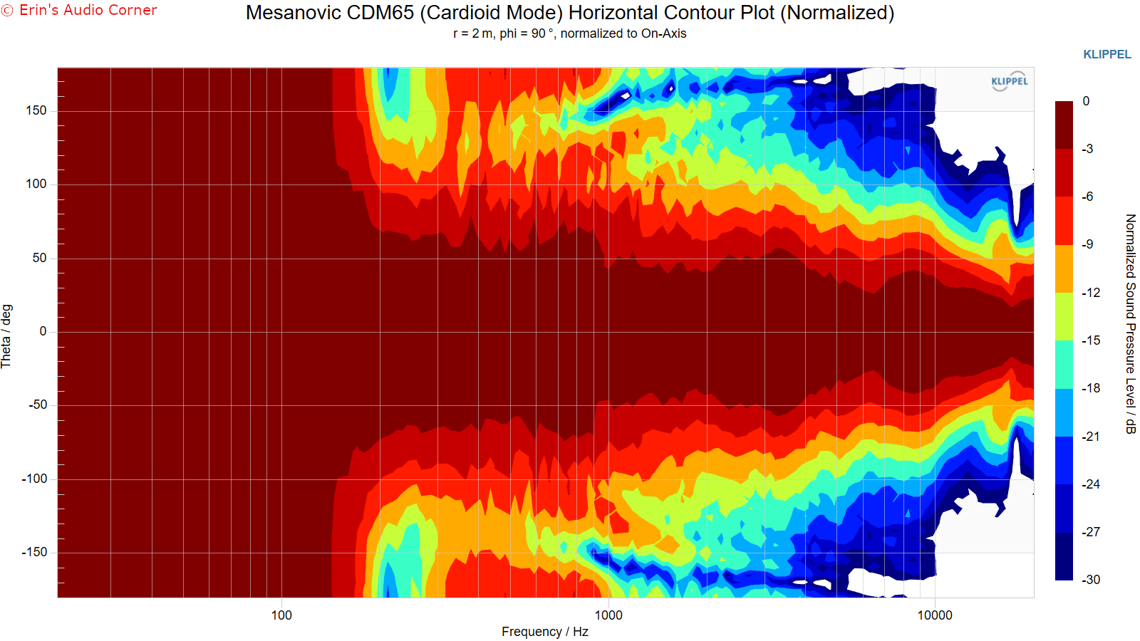

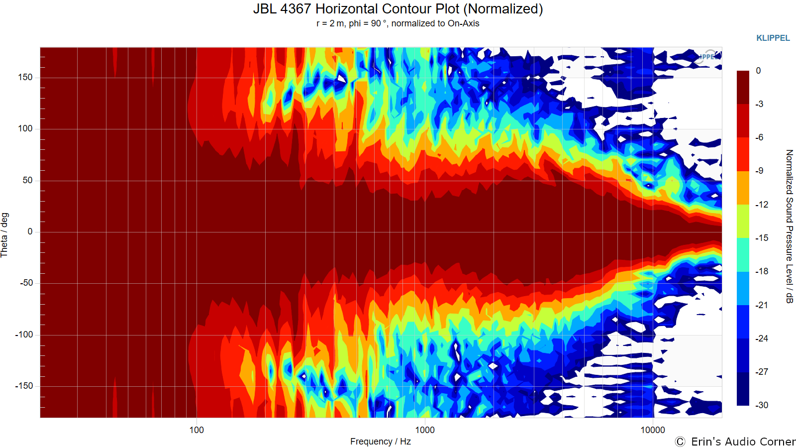

I find it very useful to study Klippel NFS measurements and analyses by Erin and Amir. Pay attention to speaker construction and crossover points to see common traits of how to achieve the result.
Typically DI and "radiation angle" is defined by -6dB level. But that is very insufficient info - IMO we must go way beyond -6dB and way beyond 90deg off-axis horizontally, and also study vertical dispersion.
https://www.erinsaudiocorner.com/loudspeakers/
https://www.audiosciencereview.com/forum/index.php?pages/Reviews/
