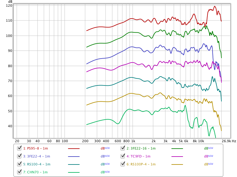

As a reminder of what the frequency response from Round 1 looked like, you can expect slightly better response in Round 2 as many of these are very high quality drivers. But just to remind you why things sound different, it's because their FR signature (or voice) is different.

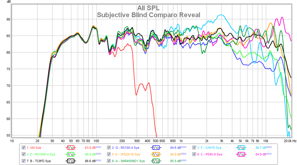

Another way to look at it once gated to 4ms and put on same graph with offsets (as provided by pnix):
