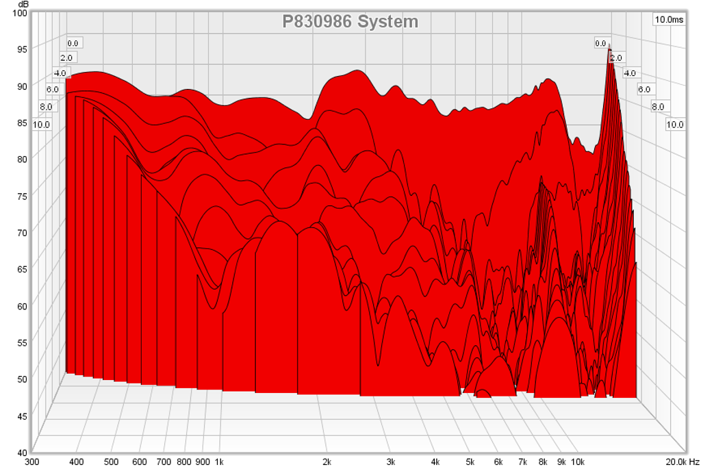

1. How much of a bump does the Alp 7.3 have between 2-3 Khz range?
2. The 20 Khz "zinger" on the P830986 - what about folks who don't have hearing that doesn't go that far? There's a null area below the HF bump. If people with hearing topping out ~16 Khz still perceive "air" on this driver, which part of the FR spectrum is likely to be the source?
xrk971,
Couple of questions:
From the graph it looks like A7.3 has a plateau from 1.7kHz to 4kHz of about +8dB or so.
For P830986 the rise at about 10-12kHz may be what is giving sense of "air".

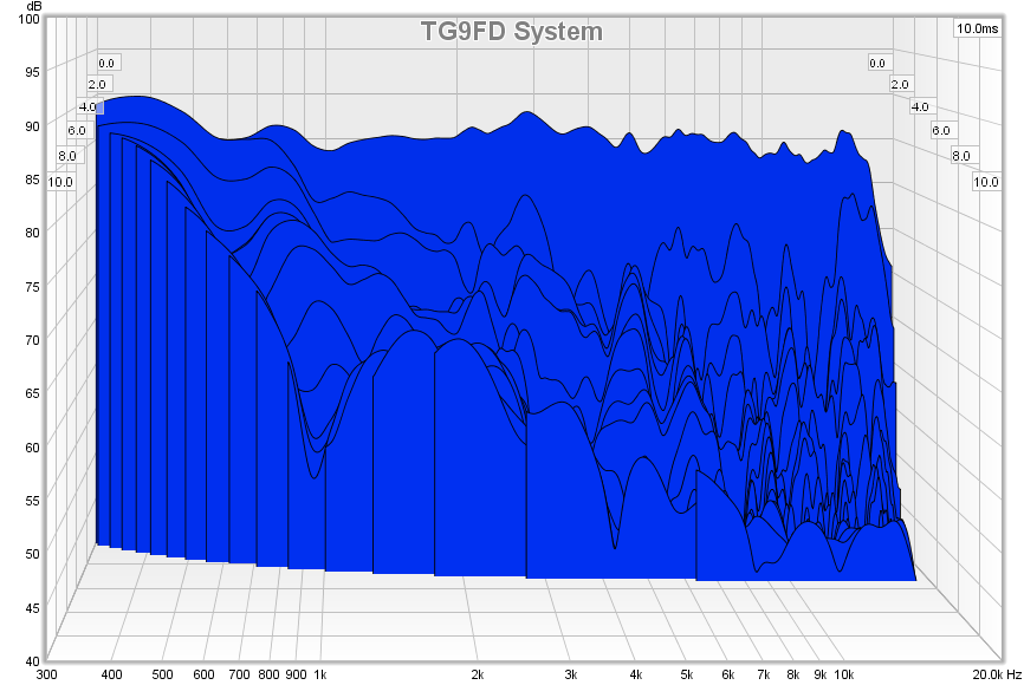

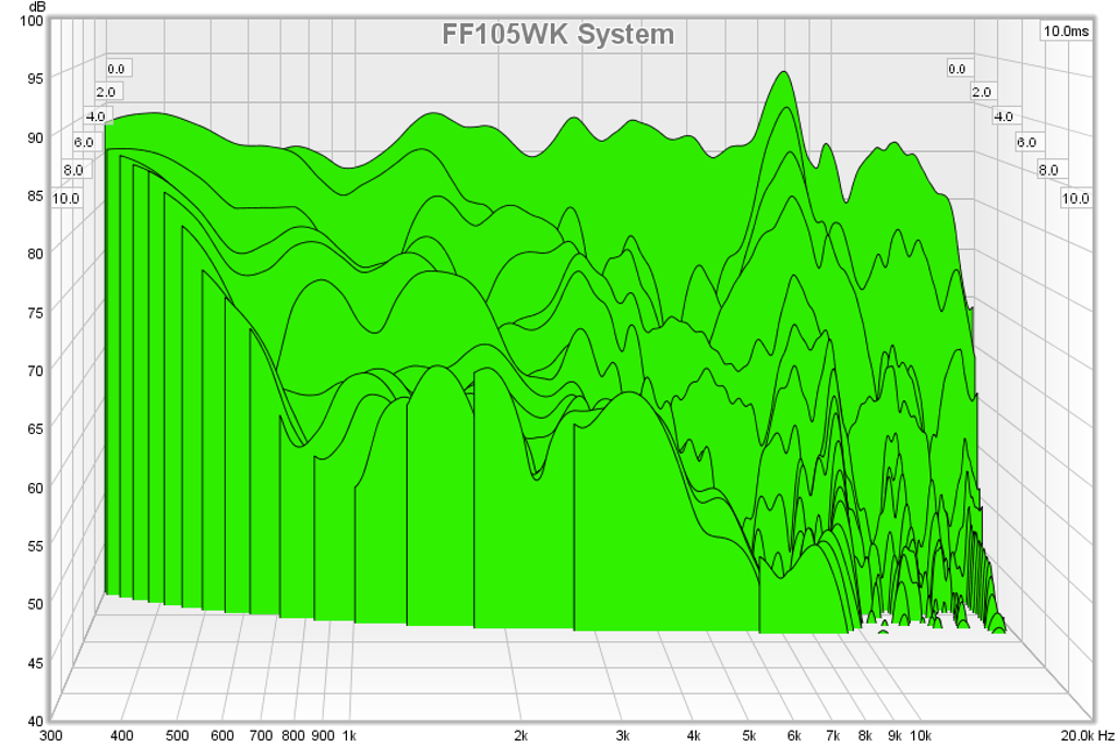

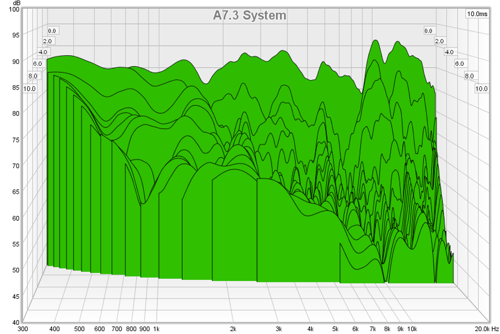

CSD Plots
Below are the cumulative spectral decay (CSD) plots for all the drivers in Round 2, plus the winner from Round 1 - the TC9FD.
Note that the CSD includes the inherent CSD of the driver combined with the enclosure that it is mounted in, which is the same enclosure for all cases (Nautaloss sealed spiral TL with polyfill stuffing). The CSD here may not be as good as that obtained by a bare driver in an IEC open baffle. However, for the purposes of relative comparison, it is good as the rear chamber enclosure and baffle are identical in each case. Furthermore, the impulse responses show that there is no reflection under 4 ms and I have set the window (gate) to 3.7ms to avoid picking up any room effects.
The CSD was calculated in REW using the following parameters in the "Controls" dialog:

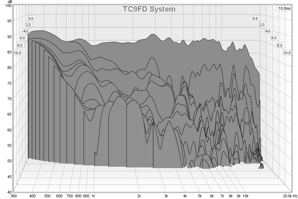

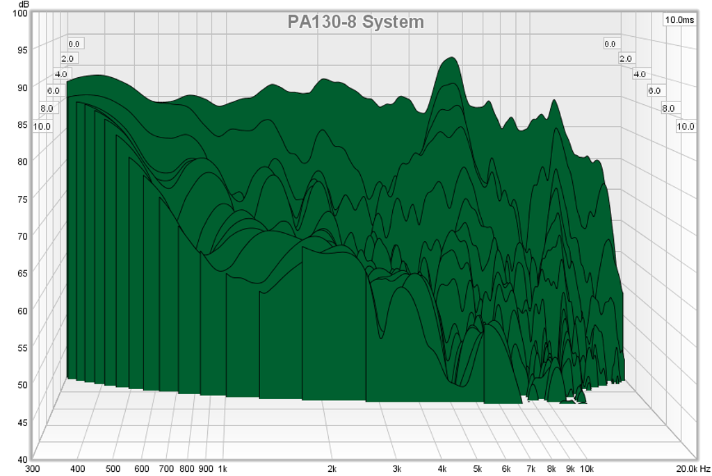

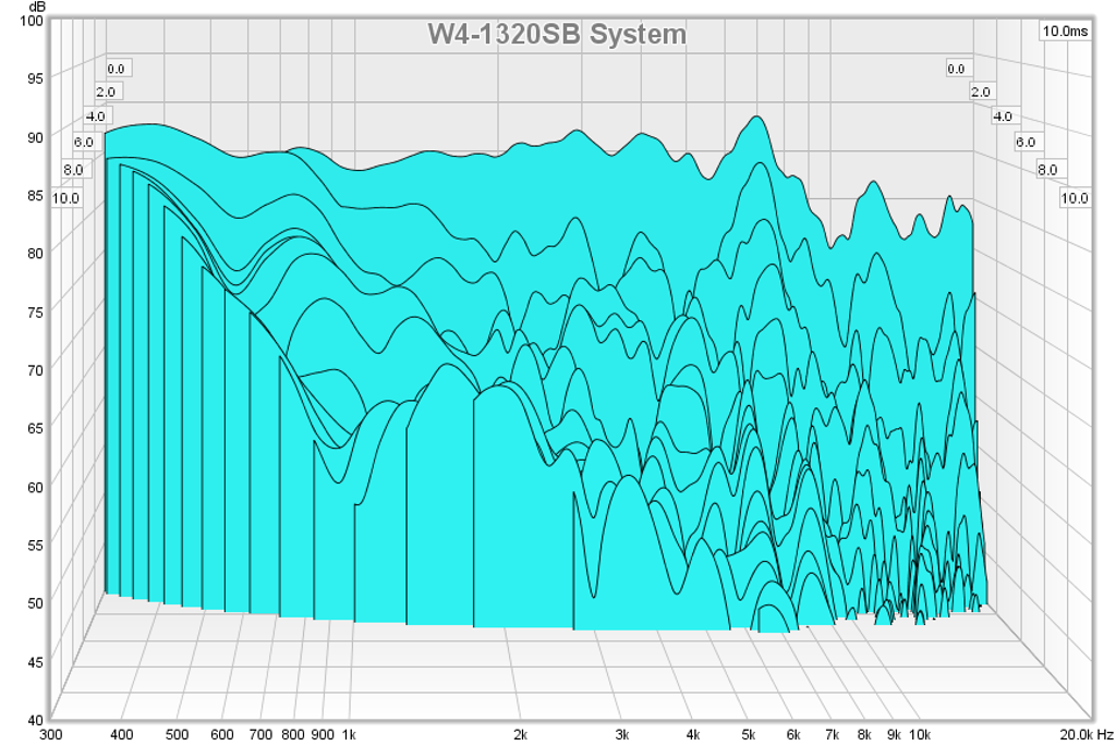

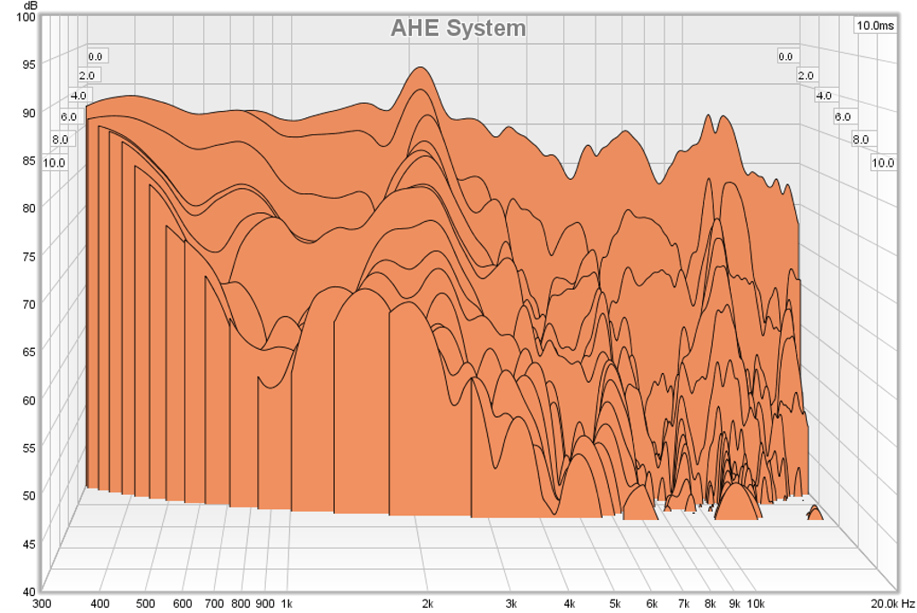

- Total Slices=51
- Time Range=10ms
- Window=3.7ms
- Rise Time=0.2ms
- Smoothing=1/48th oct
- Use CSD Mode = YES
- X view angle = -6
- Y view angle = 62
- Z veiw angle =161
TC9FD:
P830986:
W4-1320SB:
FF105WK:
TG9FD:

AHE:
A7.3:
PA130-8:

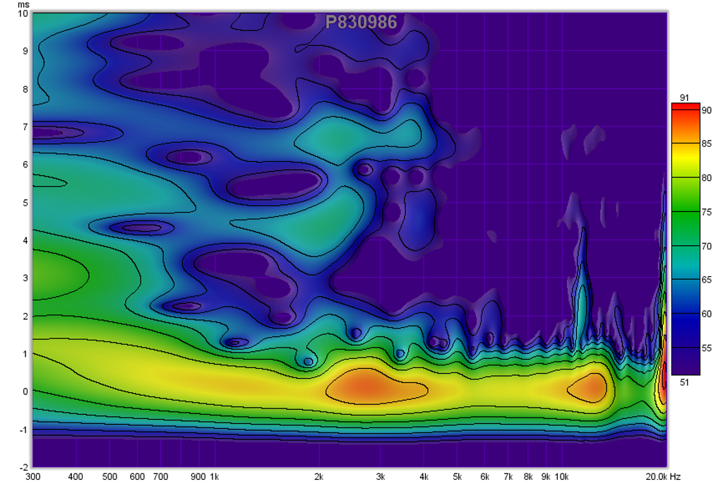

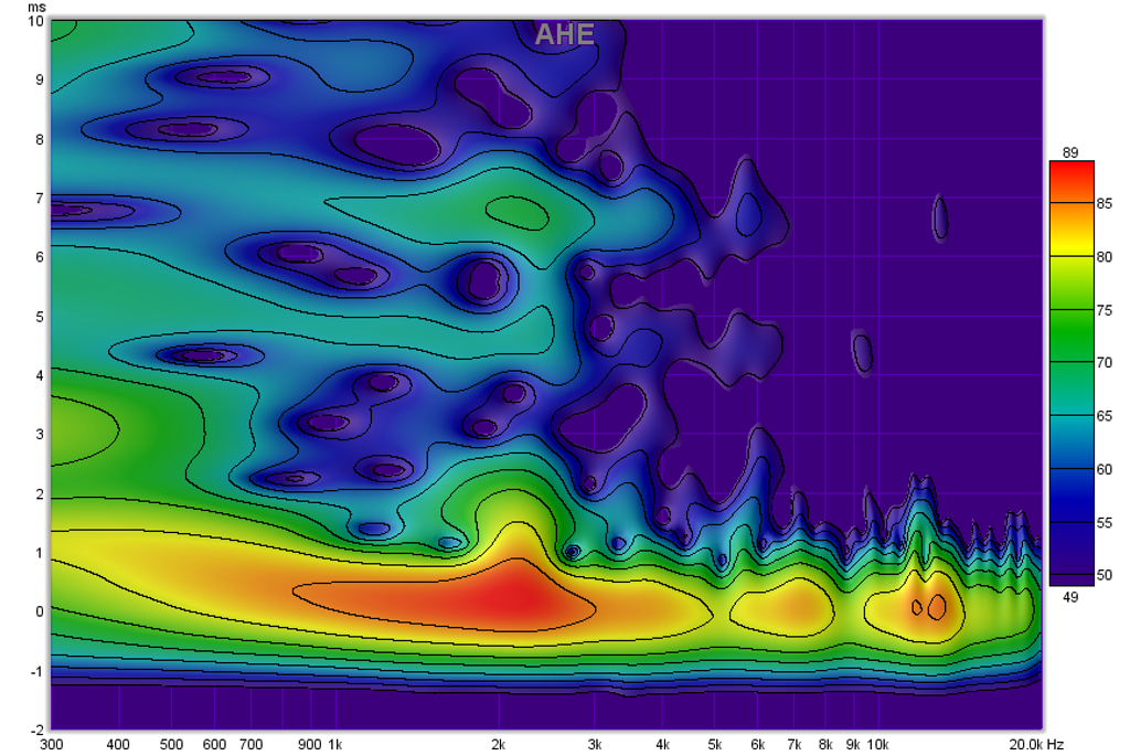

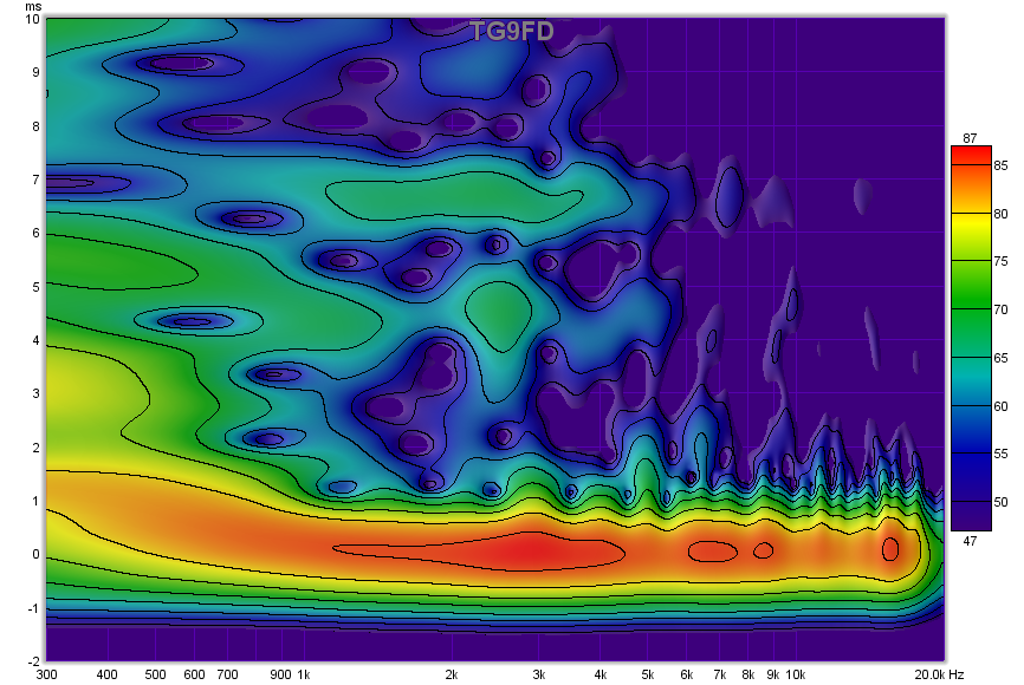

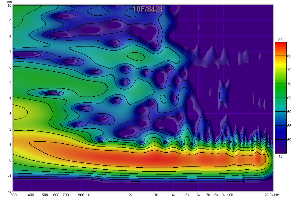

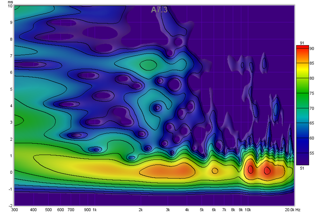

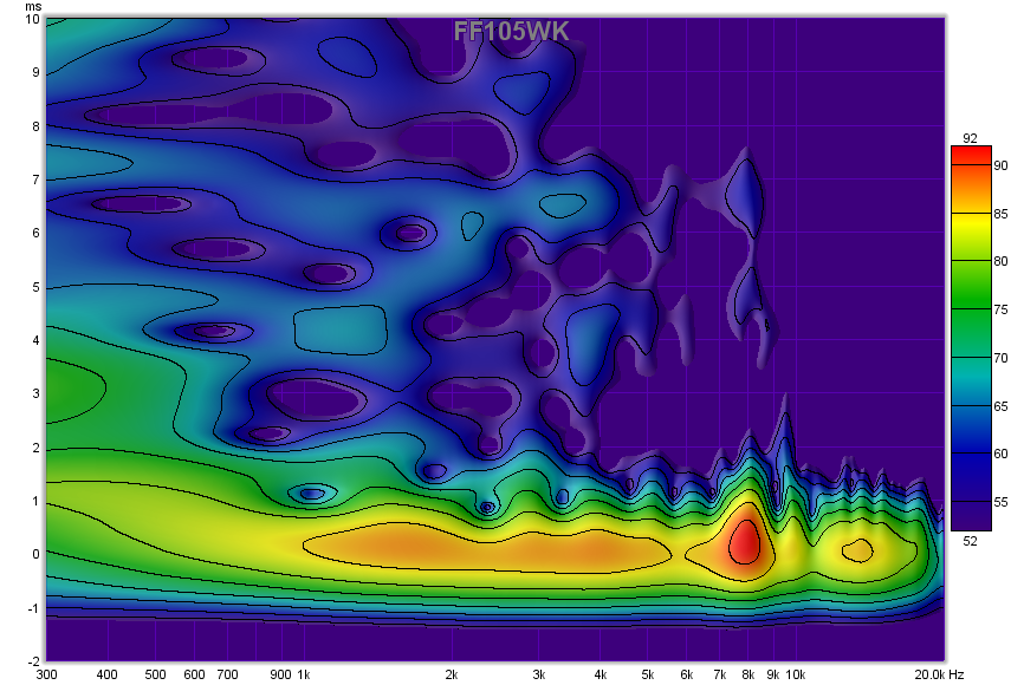

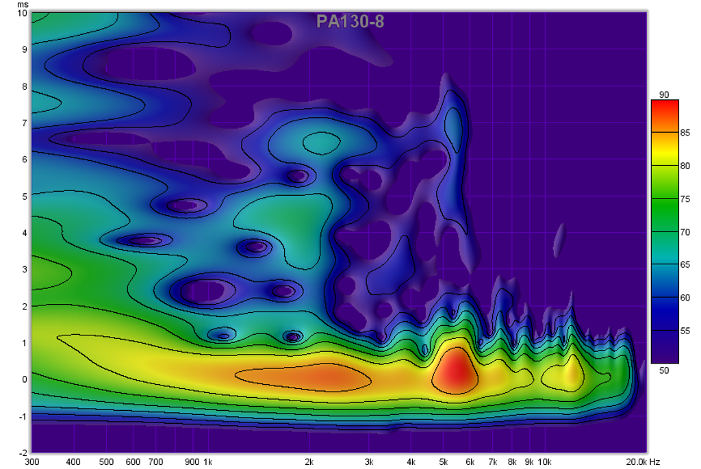

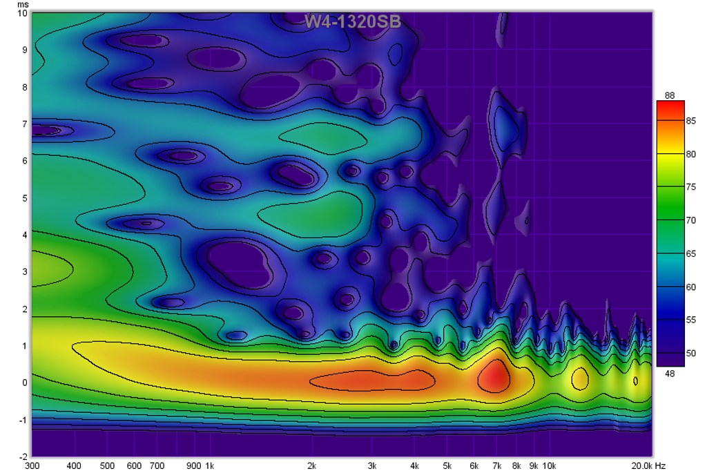

Spectrograms
Another way of looking at the energy distribution in the sound and how fast it decays is the "Spectrogram" contour plot. Here using 3.7ms window and 10ms range, with contour colors normalized to peak SPL value.
TC9FD:
P830986:
W4-1320SB:
FF105WK:
TG9FD:
10F/8424:
AHE:
A7.3:
PA130-8:

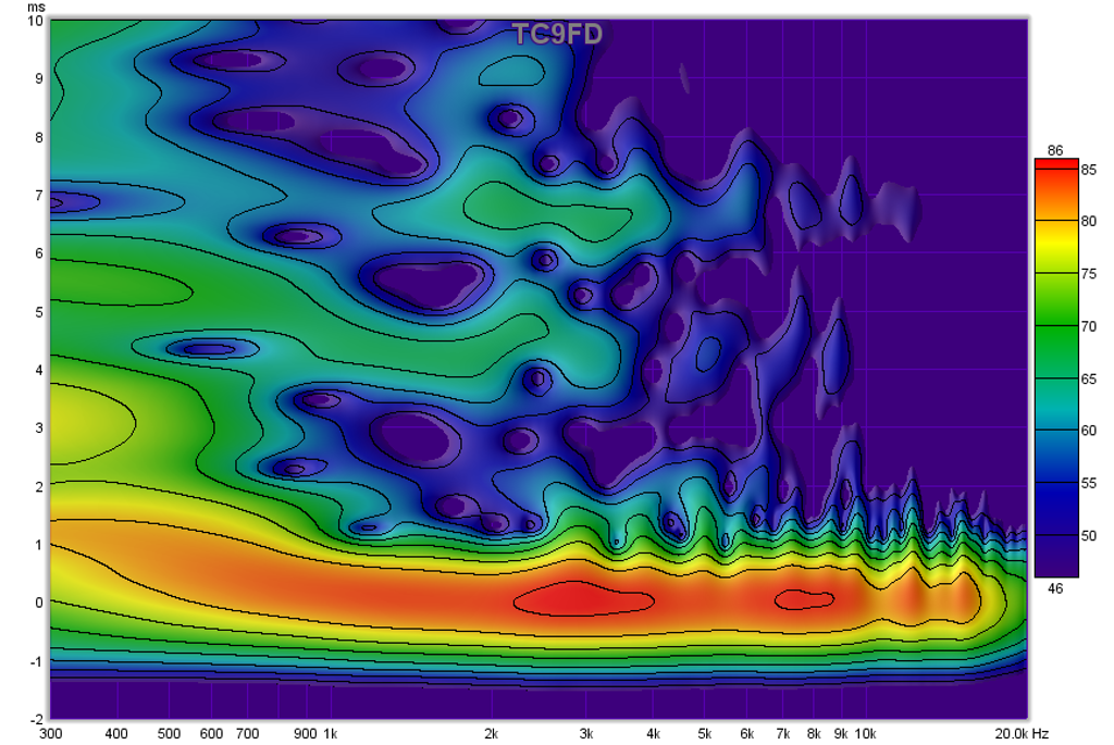

TC9FD:
P830986:

TG9FD:

AHE:

FR is not the only thing that make up a driver. You will find out that many other things are "right" in the product that provide "right" FR. May be it is just about "right" manufacturer? 😀
I sincerely doubt this is about the right brand! After all, this was blind, despite some people wanted to derail the outcome by unwanted comments;o)
If the response is even AND MLSSA is good, people will fall to their knee's and pay homage to the superior driver. No matter what brand! Also I believe that MLSSA have to be done in an infinite baffle in order to get rid of possible internal reflections. I.e. not a boxed driver!!
Peter
I sincerely doubt this is about the right brand! After all, this was blind, despite some wanted to derail the outcome by unwanted comments;o)
Peter
If you look in this thread, I show how the Nautaloss sealed spiral TL has essentially the same response as an open baffle - that is, it has very little back reflections to affect the frequency response. With that said, it will have (some) effect on the CSD. However, this effect would be the same for all drivers tested as they all have the same enclosure - which is not a "box" but a slowly tapering spiral, kind of like B&W's Nautilus - which serves as an acoustic "black hole".
http://www.diyaudio.com/forums/full-range/270094-objective-comparison-3in-4in-class-full-range-drivers.html
In the overview of the Spectogram plots (the little attached thumbnails) it's pretty easy to spot the former family members. Remarkably similar in behaviour despite the difference in materials used.
I agree that this should not be viewed at as a pure CSD test but still it is a useful comparison.
