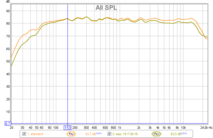

Very nice! FIR filters for XO and system HP work very well. You could possibly get away with a bit of base extension and associated phase work and get good square wave down at lower frequencies.....
If understand right you mean little more IRR bass frq amplitude extension and then by FIR super linear flat phase down at lows too. A more linear flat phase down there i could try soon but regarding IRR frq amplitude i have problems. Probably because of speaker placement on a shelf up against a wall, then if measurements at that mic spot in space i up the low end frq spectre power reponse and bass get boomy out in room probably because of placement and this rooms mode (4,25x4 meter). At plot it looks like have no very deep bass at mic spot in space but out in room it goes lower. Could also as wesayso do measure from 3 meter but then phase gets a mess and published square waves look alikes probably ruined. To have power response fair right i use headphones to comepare with room sound but could also try pink noice and a RTA and see how mic at different spots look like, any suggestions and experience is welcome. Attach a plot psychoacoustic smoothing to see how little a bass boost at that mic 0,54cm on axis spot in space it takes to sound boomy and bad power response out in room, gold trace is the good one from post 607 orange is bad even it actual also have lifted flatter top end. Had been a nice learning exercise subjective it performs better than any speaker i had and next will investigate a box where 10F is closer to woofer for getting XO frq point inside 1/4 wavelength rule and also try pair 10F with woofer from Discover series to hear if same cone material will benefit sound. After the sealed ordinary squared boxes then LXmini right : )

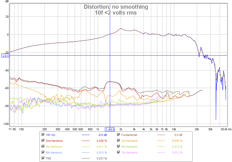

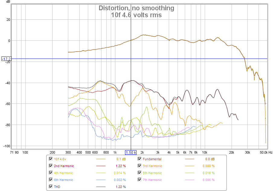

.....I've done some survey measurements of 10f running as naked dipole.
I started with 440Hz sine wave, and was immediately taken to task for earlier post about audibility of HD at low levels. By ear the level didn't seem very high at all, but a distinct higher frequency signal was present that at certain points in room where fundamental has standing nulls really stood out. I set up a track with 440Hz and track with 5th harmonic and adjusted mix for hearing lowest level, and found this was with 2200Hz mixed -62dB to 440Hz. Respeating with 3080Hz, I could discern this mixed in at about -55dB. OK, hat eaten! With music signals these levels have little impact on perception, or according to Geddes no impact. IMD and transient IMD play bigger role in roughing up the sound.
A full range sweep at less than 2 volts rms (didn't get the volt meter out!):
Then sweep at 4.6 volts rms:

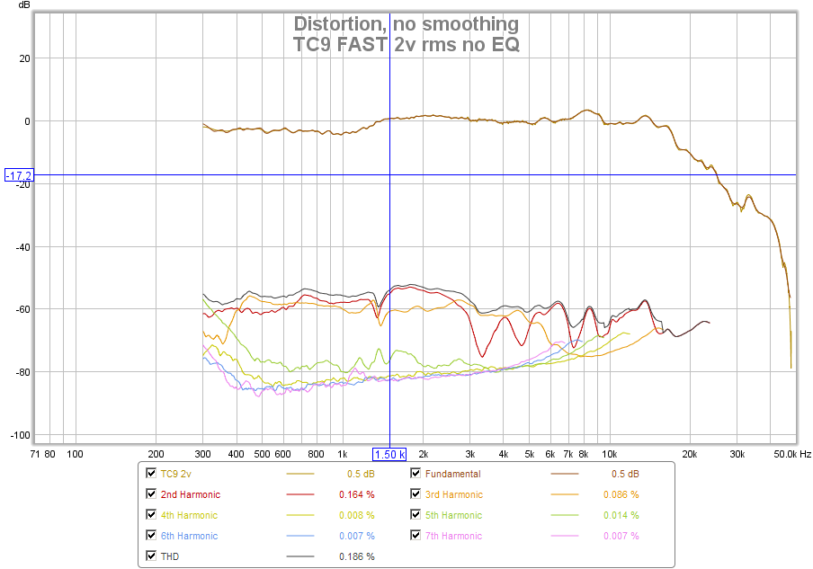

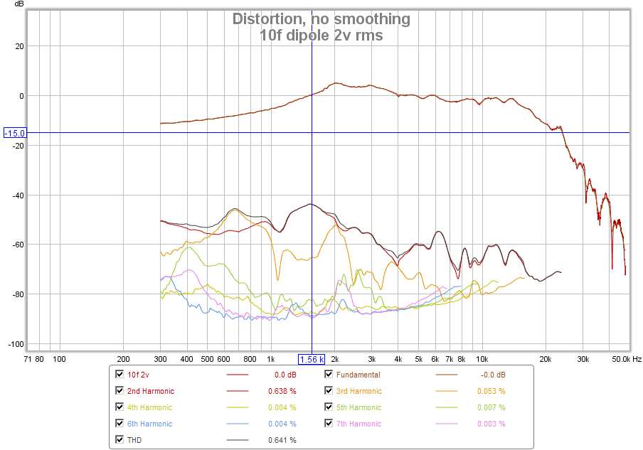

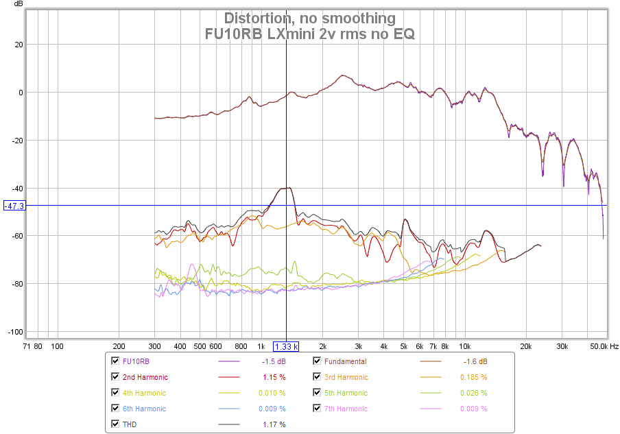

Next sweep at 2.0 volts rms, followed by 2 volt sweeps of TC9FD in sealed 4" diameter pipe, and of FU10RB in LXmini setup with driver mounted in front of well stuffed 3" diameter pipe 5" long.
10f:
TC9:
FU10RB:
Dipoles seem to incur 2nd harmonic peak below dipole peak. It will be interesting to see results of 10f mounted LXmini style. In a new thread.
Do you measure with another program than REW and then import IR to use REW for publishing, ask because noticed measurements frq resolution run out to 48kHz and as far i know REW is limited to 16bit/48kHz, plot frq resolution 24kHz.
Thanks the survey and TC9/FU10RB plots too, may one use those on axis plots to compare performance their HF part and roll off up there or should that be avoided because they don't sit in same baffle arrangement. TC9 looks really good on axis compared those two more expensive ones.
BYRTT; REW was used with ASIO drivers. Sample rates supported are dependent on soundcard and drivers.

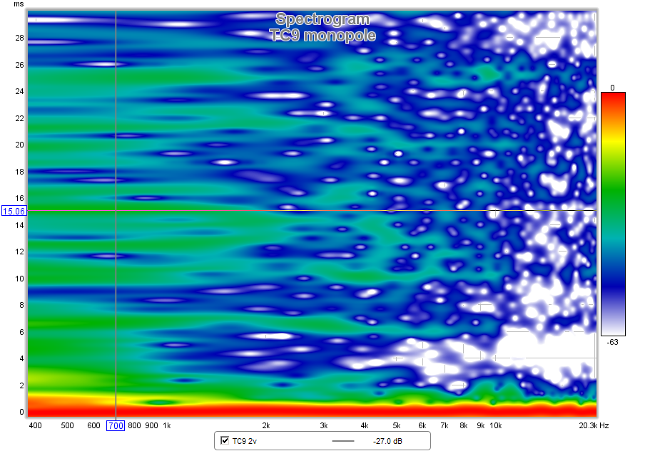

Survey measurements of prior post were made with microphone 9"-12" from driver and was moved between measurements. Microphone is only approximately on axis. Overlays of 10f FR plots show how prone 3-4" drivers are to beaming effects due to changes of a few microseconds in arrival times of sound from all points of driver surface at microphone.
Current REW spectrogram view has frequency response normalization feature that makes it easy to demonstrate difference between monopole and dipole speakers:
10f as dipole:
TC9 as monopole:
With the normalization feature both plots show uniform intensity across spectrum at t=0. TC9 has highly omnidirectional radiation below 2kHz. Loads of timing information and sound formants occur in this region, and are reflected from walls, ceiling, and floor. With 10f as dipole, a strong reflection is seen at 14ms, corresponding to wall 7 feat behind speaker. Set up with monopole a cardioid pattern may be achieved that would greatly reduce this reflection as well.

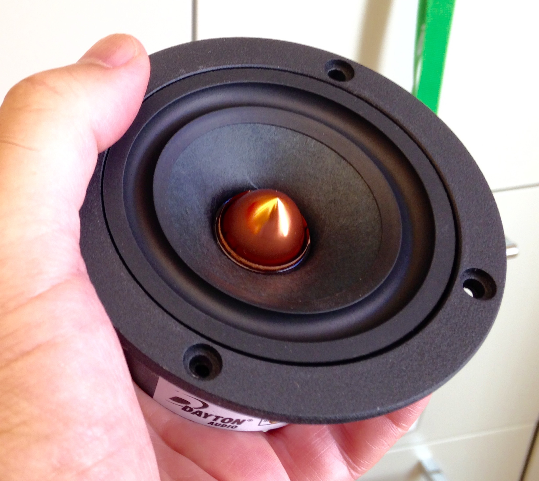

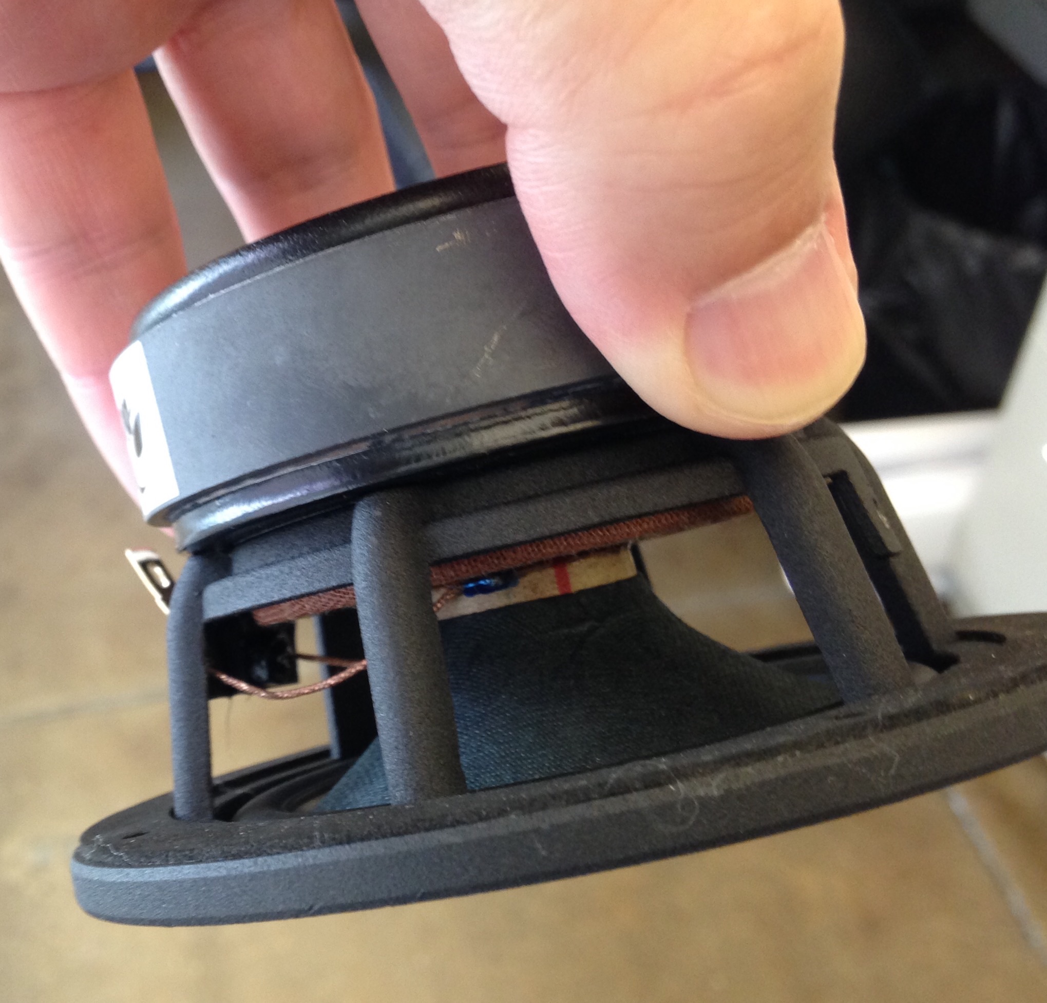

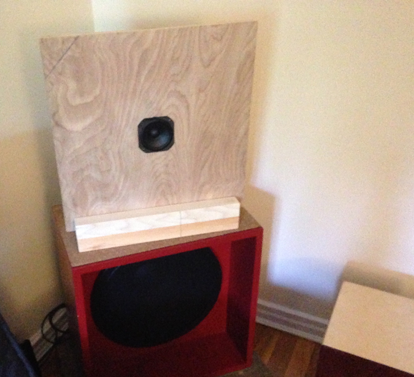

This driver is super cute! The Dayton PS95 looks like a TB from the front but I've never seen a basket like this from behind. Very open and airy. It appears very well made and feels substantial. I wouldn't be surprised if TB makes the driver.
I can't wait to get it onto an open baffle.
not sure why I can't upload more than one image at a time

The PS95-8 is a very well made driver - sourced in Taiwan I believe. Super value for $24 if you ask me. The basket is nicely made and comparable to the much pricier Visaton B80 in design. Both have similar traits of airy cast basket, paper, and phase plug. The included pre-glued foam gasket is really nice too.
I know they guard the source factory of these drivers because Perceval, whom lives in Taiwan, can't find it or get it there!

The PS95-8 looks like a substantial driver. Cosmetically it's among the best I've ever seen more in line with the expensive Fostex Sigma series than the rest of their lesser expensive line (which all look and feel inexpensive). It doesn't look like a TB from behind (some TBs are well made too). I haven't compared it directly yet but the TC9 did not impress me as much when I first saw it. The PS95-8 looks like an expensive hi-end driver regardless of price. Perhaps the prettiest driver I own.
I didn't realize even the Scan Speak isn't terribly expensive at around $65 but I'm content with the TC9 for the time being. I hope the PS95 sounds like the TC9 but with stronger treble (where I think the TC9 is slightly lacking). The TC9 sounds very smooth and relaxing but I have to aim it directly at the listening position to get more satisfying treble. At 49 years young I wonder if my hearing warrants a driver with stronger treble?
I agree that the PS95 is one of the prettiest drivers I have. That copper nose cone really adds some bling to it. 🙂
The performance is enough to garner substantial votes despite elevated HD levels relative to 10F/B80/TC9/TG9:
Truth be told, maybe it's the pleasing 2nd order HD that makes it sound good and "tubey" 😀
The $65 is the 10F/8414 (higher 0.51 Qts) vs the $95 10F/8424 (lower 0.37 Qts). For OB, the $65 is probably better.
