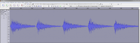

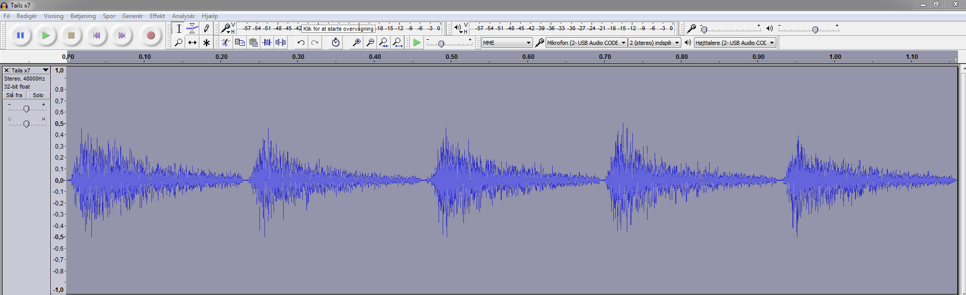

Below is blacksmith five different hammer on the anvil when looking into Barleywaters shared file with free Audacity, took the first knock of the seven and united them side by side 🙂.
