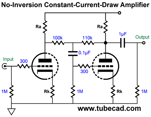

I was looking for a simple tube preamp schematic and found in one
old Italian electronics magazine an amp with this circuit
tube input, which they call CASCODE, so it would be
the classic SRPP.
But this pattern is totally different from the others I've seen
and it is not a printing error because the connections are also in the PCB
they are the same, so that's it.
So what is the TRUE CASCODE / SRPP ??
Sorry for any google translate errors...

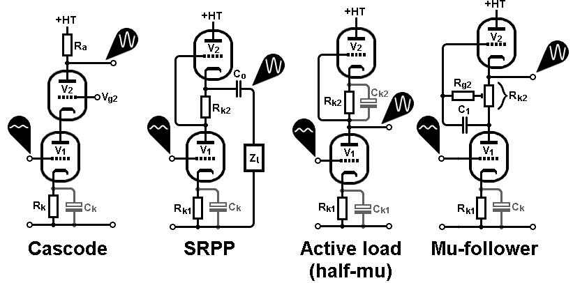

A cascode is a common-cathode stage with a common-grid stage on top (or the equivalent with transistors). It has nothing to do with an SRPP stage.
The behaviour of a cascode circuit with two triodes is in many ways similar to a pentode common-cathode stage, but without the partition noise. It was used a lot in high frequency circuits.

I suppose the tube is ECC83/12AX7. An SRPP will have lower output impedance and lower gain than a cascode. It also needs a better filtered PSU, because it has low PSRR. A cascode is usually followed by a cathode follower to get low output impedance, while an SRPP inherently has low output impedance. The cascode has less maximum voltage output than an SRPP.

Just for my benefit, what is an SRPP? I have seen almost every circuit topology in existence including tubes, transistors and fets, but all these abbreviations drive me nuts.
Series regulated push-pull or something like that. It's a circuit where a common-cathode stage is connected to a load via a resistor and the voltage across that resistor drives another valve that's connected between the supply and the load. Together they work as a push-pull stage. It used to be used in transformerless output stages driving 800 ohm loudspeakers, for example.
