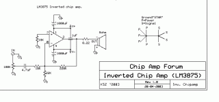

jaudio said:Ok
You tested the drv134 by itself?
You could try disconnecting the 22k resistor from ground?
Is your layout is basically like this?
I'm really confused since this is not the first time for this DRV134 board. I used this drv134 board with "hard-wire" LM3875. All boards worked very well. Then I created the PCB for LM3875. The LM3875 PCB alone works well too. Anyway, I will try to remove 22K.

jaudio said:check it
Sorry, I've sent the wrong pics to Mrpong.
It's actually NO connection from LM3875 output to ground.
( 3875 has no -out put anyway ).
Shouldn't one of the LM3886 be in inverting mode and the other be in non-inverting mode? As I see it if there both in inverting mode then you'll get nothing from the amp (or am I incorect?)?
As for the hiss (ignore this if it's been asked already) have you put good de-coupling caps on the all of the op-amps?(that means buffer and lm3886)
