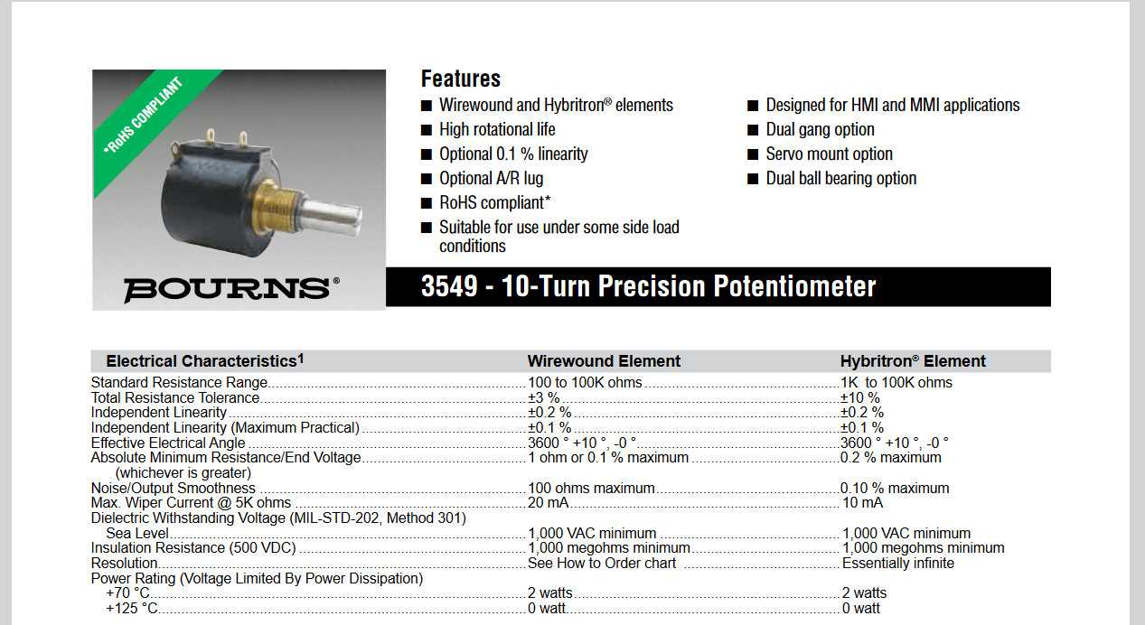

I have looked into the voltage ratings of 10 turn potentiometers, and the good ones made by Bourns are sometimes specified up to 1KV working voltage. There is no need to level shift the control voltages.

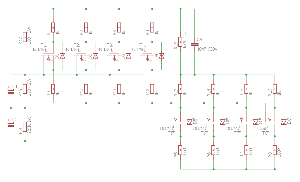

About the pass transistor secondary breakdown problem, my idea is to use a FET cascode made up of 2x4pc BUZ80 Mosfets, BUZ80 is a very old part from the 80's that i can get in quantities NOS, that has good SOA graphs and is from a time when FETS where not only designed for switching in mind.
