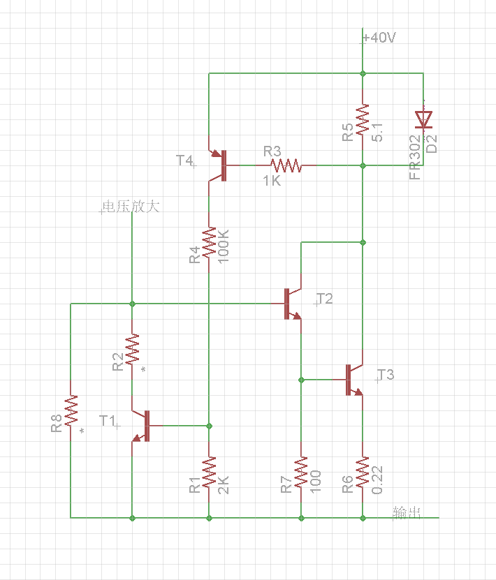

A special Super-A class amplifier
This is up-side out-put part of the amplifier, down-side is similar.
R5 T1 T4 limit the minimum current of T3 at 100mA.
D2 is a fast diod limit Vbe of T4.
