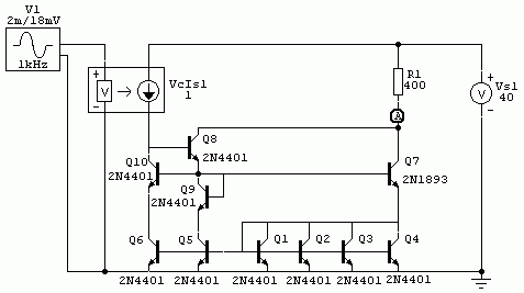

Hi Peter,
I have an alternative as suggestion. I didn't simulate yours, so I don't know how these two compare.
This alternative has an accurate 5x ratio between input and output, with a gain error of order 1/hFE^2. All base currents are compensated for.
The circuit is simulated with an input current of 50-150mA sine wave. The output has a 250-750mA sine wave current, which translates into 2.5-7.5V at the output due to 10 Ohm loading. The THD is very low, all harmonics lower than -132dB. The transistors in this simulation have a hFE of 100.
I did not use emitter resistors as the transistors are completely equal in the simulation. In practice it will be a good idea to add small resistors for the bottom line transistors to reduce the effect of Vbe mismatch.
Minimum voltage at the output is approx. 2V above the ground.

Hi Steven,
Thank you for looking into this.
I simulated your topology using
the same BJT choices (BD139/BC547c) using the same Fairchild models.
This made the results somewhat mixed:
Not having identical Qs puts the balance off, so I needed 49.963mA
to balance the 10mA input (that's
49.991mA for the other circuit).
You indirectly pointed out, that emitter resistors were uncessarily large and making them just large enough to balance the devices would save 500mV voltage swing.
This worked fine for my original circuit too, with some some reduction in output impedance (from 6 to 1MOhm, which is still fine) and a
welcome reduction in K3.
Your circuit has only half the output impedance, about 0.5MOhm.
Doing the distortion analysis driving
a high impdecance load (I should have clarified, that this is the intention), your circuit has visible K2 (which may be no problem) and some reduction in higher harmonics:
Your circuit, driving 8Vpp into 1MOhm:
Harmonic Frequency Normalized
Number [Hz] Component
1 1.000e+03 1.000e+00
2 2.000e+03 2.280e-02
3 3.000e+03 2.486e-04
4 4.000e+03 1.098e-05
5 5.000e+03 6.564e-06
Total Harmonic Distortion: 2.280050%
The original circuit, driving 8Vpp into 1MOhm:
2 2.000e+03 4.730e-03
3 3.000e+03 3.106e-04
4 4.000e+03 4.381e-05
5 5.000e+03 4.051e-05
Total Harmonic Distortion: 0.474181%
(These are the numbers with 50Ohm emitter resistors, they remain consistetnt but reduce somewhat for smaller Rs).
Thanks again for your suggestions!
Peter Jacobi

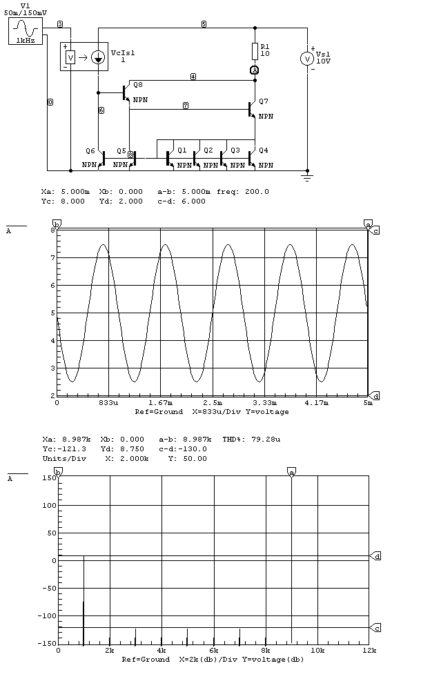

Hi Peter,
Your observations are right; I was too quick posting the results befor properly analyzing.
I used default NPN transistors in the simulation and liked the results. I should have been more suspicious. Warned by your results I looked to the models and it appeared that the default NPN transistor in the simulator does not have the Early effect modelled, just as some other non-linearities. So I changed that into more real transistors, the 2N4401 (I only have a limited library). For the output I used the 2N1893, that has a factor 4 lower hFE. Now it became clear that the current ratio was not exact 5 anymore due to the Early effect of the lower rail transistors. This has been improved by adding Q9 and Q10. Now the Vce of all current determining transistors is almost equal, and the current ratio is quite accurately 5x. The fact that the 2N1893 has a lower hFE does not have much effect on that, since its base current is added to the output again via Q8. The circuit is quite insensitive to hFE changes of the output transistor. And because all transistors carry a reasonable current, the high frequency behaviour is quite good. Actually all transistors carry the same current, except for the output transistor. Above 1MHz distortion increases. My simulation showed that the output resistance is approx 450kOhm, not extremely high, but workable. It lacks a cascode. Adding emitter resistors to the lower rail transistors makes no significant difference to the output resistance.
I found THD (1kHz) to be around 0.04%, mainly second harmonic, higher order very low. At 1MHz THD is 1%.
Steven

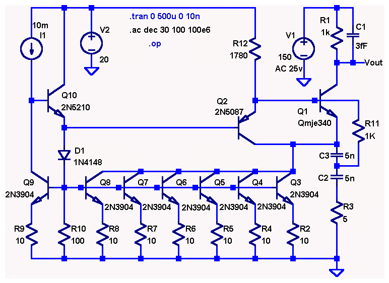

further possible improvement is available if the super-pair works as well in the real world as it does in sim, the voltage burden is about 3 diode drops like steven's circuit but D1 isn't strictly necessary so the circuit should still behave down to 1.5 V with D1 shorted
> 10 MOhm Zout to ~30 KHz, 2nd -96 dB @ 10 KHz 50 Vpp, 3rd ~-120dB
the mje is from power amp VAS sims in the symmetrical amp thread, rework the compensation network for different pass Q by watching step response from I1 to Vout
(oops, the AC gain is 6x, i just balanced the 10 mA dc bias of Q2 ( from R12, V2) against an extra current mirror cell - just delete one for 5x ac gain, if R12 or other current source biases both top and bottom symetrical current mirrors its current is 1st order canceled out)

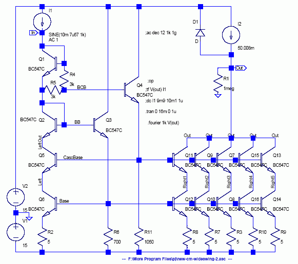

wide-swing cascode current mirror
Steven + jcx:
Thanx for your (updated) suggestions. I'll model them with matching devices and try to make a comparison table.
To try a different approach and get a significant improvement in voltage swing, I made a BJT version of the wide-swing cascode current mirror, popular in CMOS VLSI.
I tried this before and failed, but now I have a sort-of working version:
http://www.linearaudio.de/scratch/new-cm-wideswing-2.pdf
This topology gets the output voltage within 1.5 times Vbe of the rails, i.e. only about 1V is lost!
Output current matching is fine impedance adequate (300k), but problems remain:
- There is a pole near 10MHz
- Noticeable K2 (3%)
- K3 and up somewhat higher than in the other designs considered.
- not forgetting: component count
Peter Jacobi
jcx 🙂
