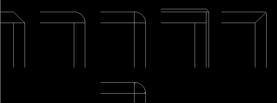

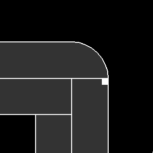

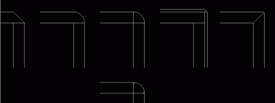

What about this.
Chamfered joint with a large 25mm (1") round over bit, then the join is given a groove that is filled with Builders Bog - 2 pack filler (shown as white solid hatch).
Has anyone tried this or similar, and does anyone think it will work or not work?

paulspencer said:What about this.
The problem with most glue joints is lack of clamp pressure. Apply ample glue, then us LOTS of clamps and LOTS of pressure. It is virtually impossible to apply too much pressure with ordinary clamps. You don't need to worry about squeezing out all of the glue.
I have only ever noticed this problem when I was a bit slack about clamping.
I think adding another filler material with it's own expansion/contraction properties is just going to create problems.

The idea behind using builders bog is that it has strength to hold together, being 2 pack.
I think I may have to do some trials before I paint - make a mini box!

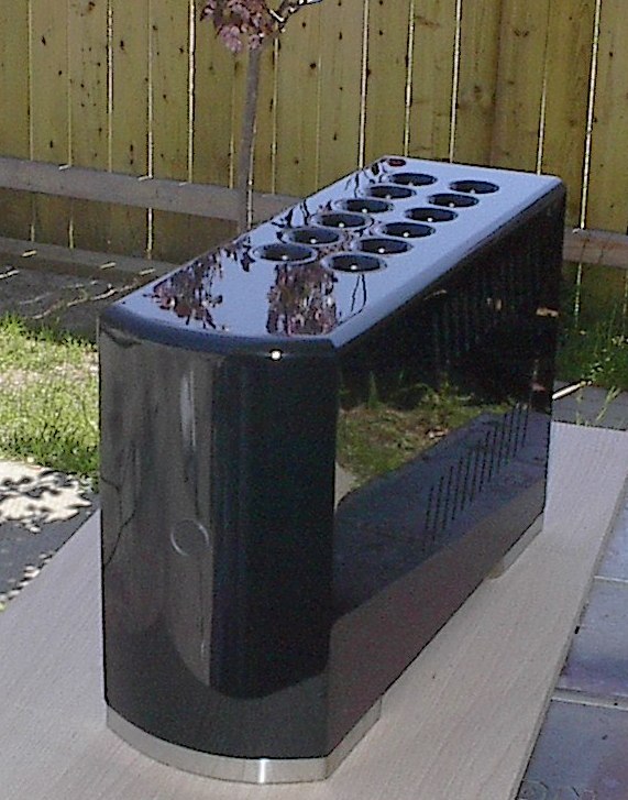

I have done it several times, on several different things. Pic below is a HDF and MDF amp case. No lines anywhere.
I use yellow carpenters glue, BTW. This is PVA glue with aliphatic resin added to increase strength. Remember, don't be afraid to clamp it as tight as possible.
