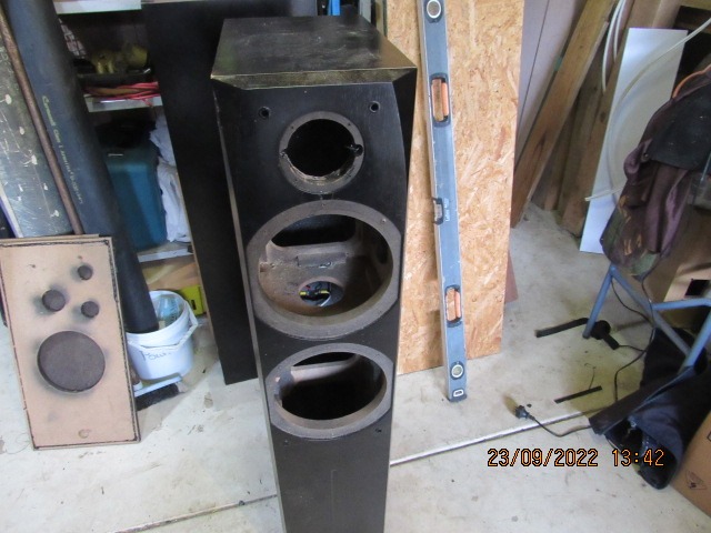

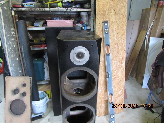

I have a nice pair of Sansui floorstanding speakers here that I wish to convert from a 2-Way into a 3-Way.
The Sansui has dual 8" woofers in a tall box
I have a pair of the Hi-Vi TN28 given to me by rabbitz a while ago to top mount.
I intend to use the existing tweeter position in the top of the box to place a small midrange.
What I am looking for is a driver with an integrated can type assembly that will fit in the existing tweeter hole position,
I have a pair of Foster drivers here but they are 5.5" and too large.
Before I start mucking about with coffee cans and mounting from the rear does anybody know of an existing 100mm midrange with a can of about a litre or so that isn't your typical sealed back mid?

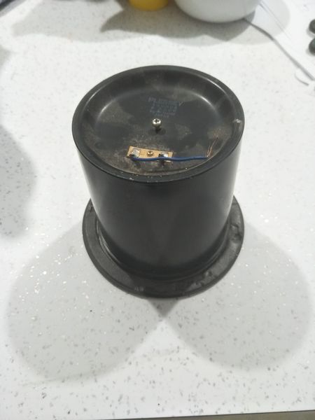

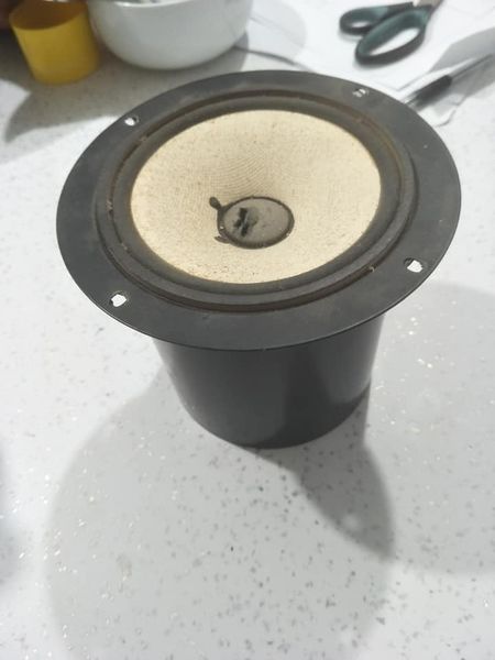

I'm not after a sealed back midrange; rather i am after an open back midrange with its own integral "Canister" type enclosure of around a half litre or so.
Like these Foster drivers in the attached pix

Looking closely at the picture - I don't see anything "open back" about it, it's a sealed midrange though it does have a larger volume like the old Peerless rather than an abrupt "ending" near the spider (..maybe that's what you call "sealed-back"?).I'm not after a sealed back midrange; rather i am after an open back midrange with its own integral "Canister" type enclosure of around a half litre or so.

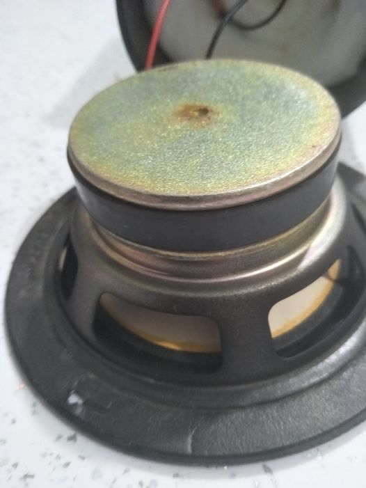

Here are pix of the back side of the driver to make it clear.
These were available on clearance at Jaycar when Plessey Australia went out of business.
96dB when crossed over and went with a 15" woofer in a 3-Way
I was hoping to find the 100mm version of these which are nominally 5" but need a 5.5" hole
If I could find some thick cardboard tubes of 110mm internal that would also work but I've been looking for weeks and found nothing suitable. Sewer pipe I think won't glue properly to the MDF of the box in question

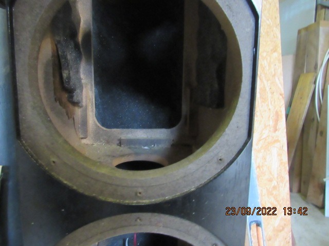

That would work if it fitted the box, but as the 8" woofers are Peerless clones and mounted in the vertical orientation [ I must post pictures] the biggest driver i can physically fit are these 100mm units. Actual size 105mm Nominal driver size is 90mm
