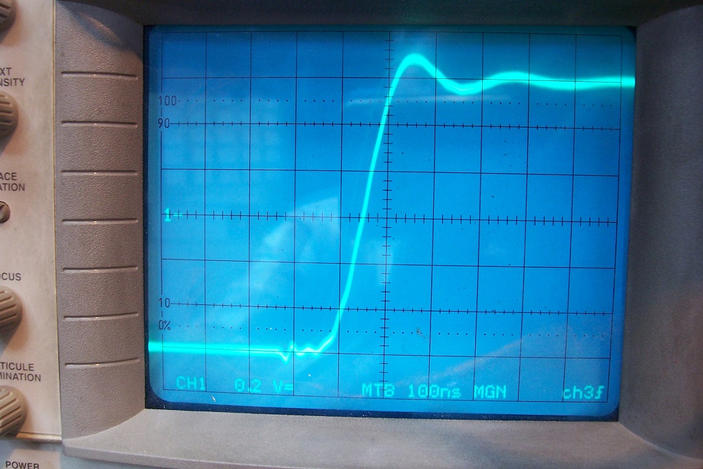

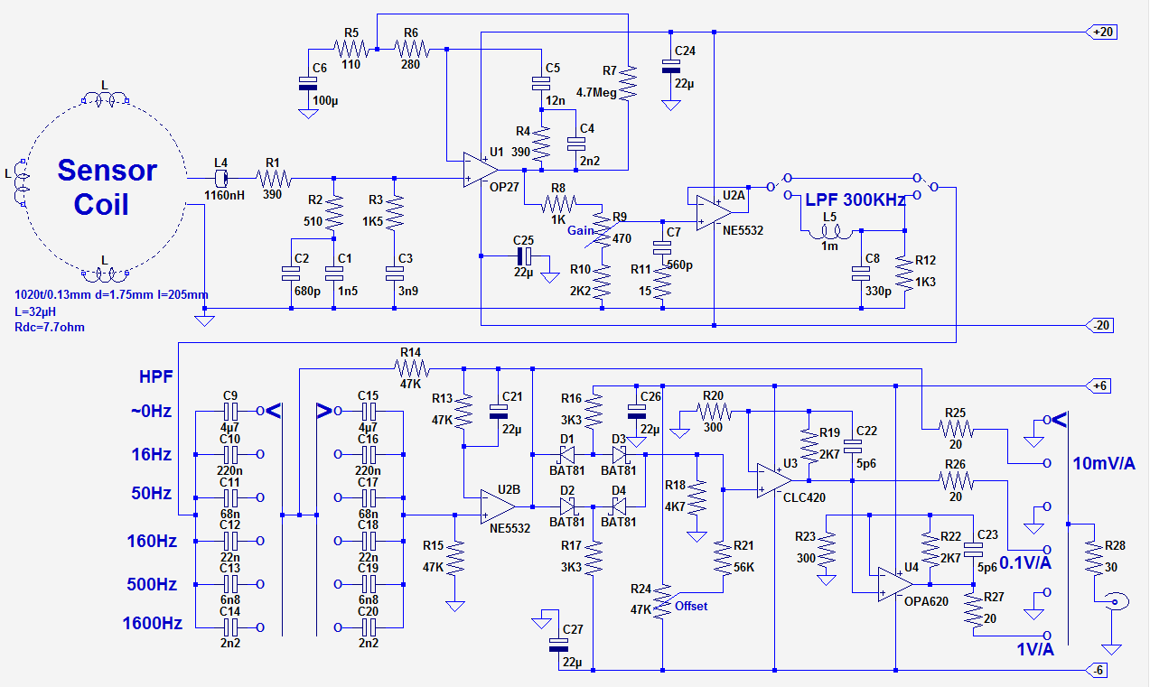

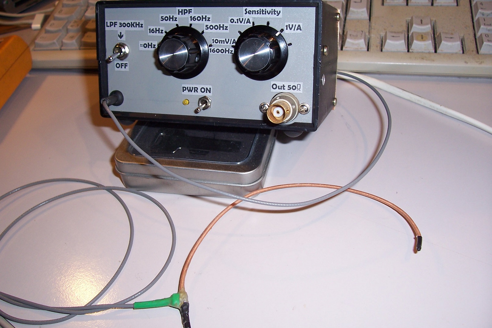

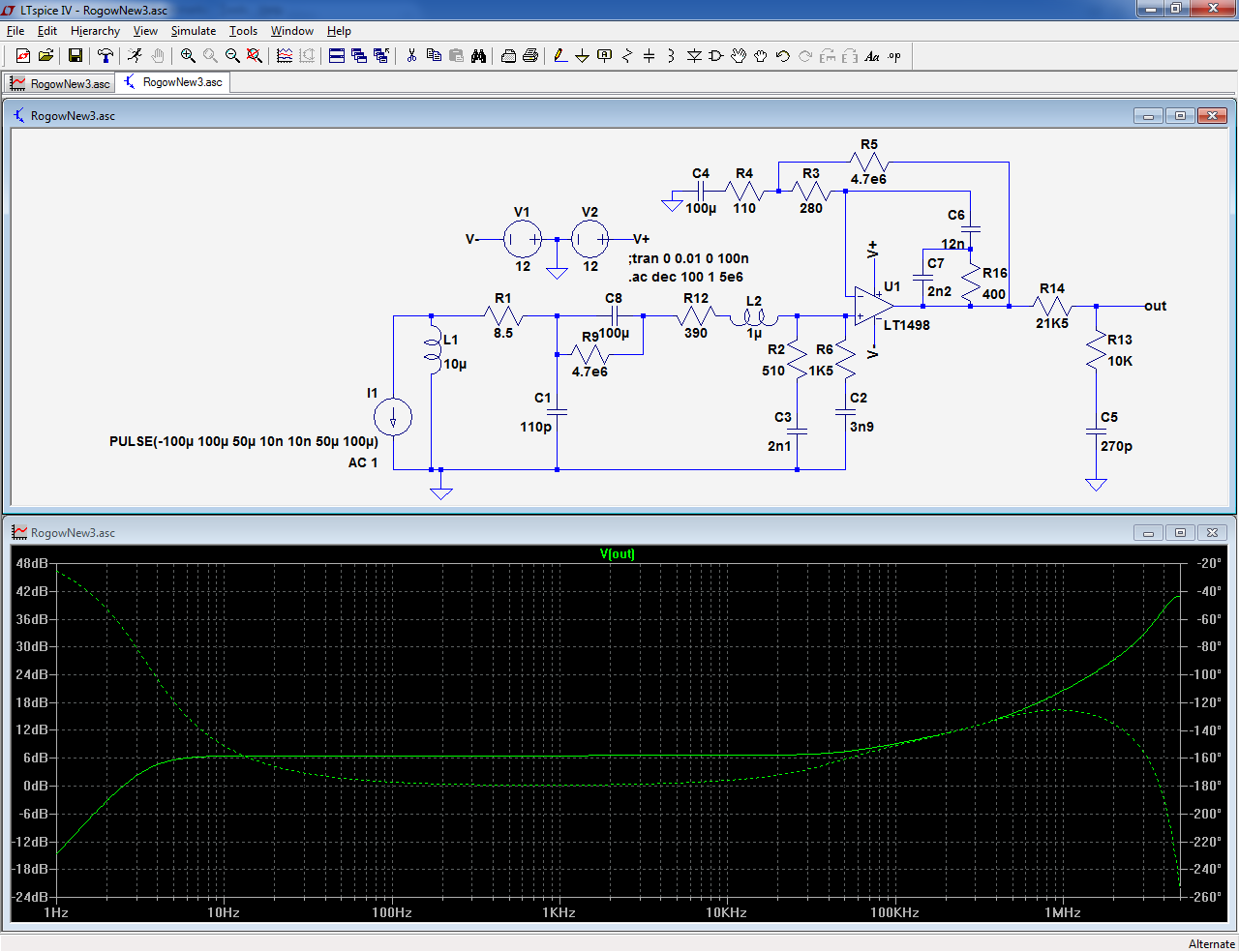

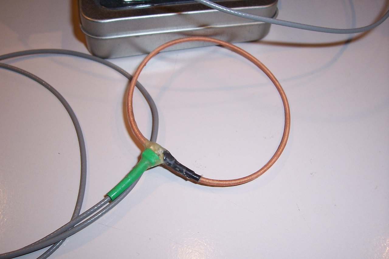

A slightly unusual Rogowski sensor
I'd like to try this sensor with a bridge amplifier but the problem is finding a good design done right.
I had thought of an opa1632 that drives two power amps in parallel but the electronics experts have sent me papal excommunication stating that it doesn't work 🙂. Maybe Nelson has some nice plans.
