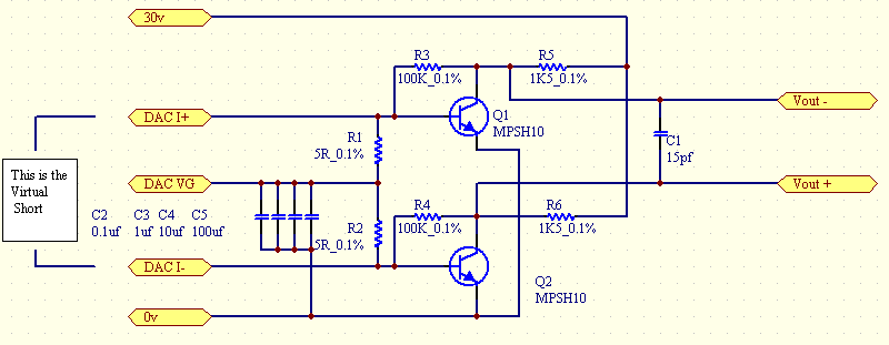

A single supply, 2 transistor DAC-IV stage.
Here is my first bread board draft.
The power supply is meant to be floating compared to the DAC supplies.
The virtual short is between DAC I+ & DAC I-. As for the DAC VG (virtual ground), It may be useful to connect to so some DACs VG's, or the DAC's may perform better without it.
For the DAC's with Voltage out, add a series resistor on both DAC Vouts (+/-) & connect them to the DAC I(+/-) on this circuit.
The outputs still need to be buffered. I making a 4 JFET solution which connects right to this design & it will create both Balanced & Unbalanced outputs.

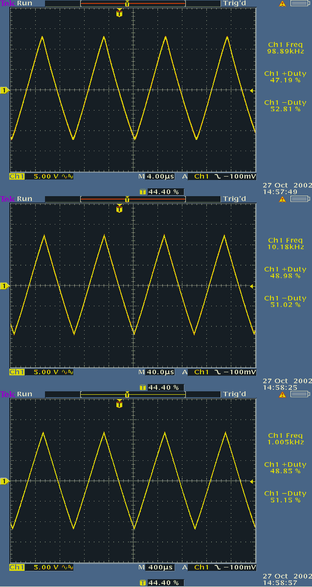

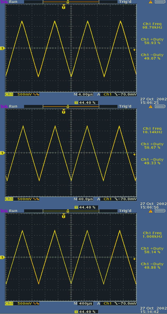

Here are the first tests.
Test equipment:
Lousy BK Precision 3011 function generator.
Good BK Precision 1786 DC Regulated Power Supply.
Great Tektronix TDS 3054 DSO
The scope was operated from battery pack & it was floating.
The DC supply was also floating.
The function generator's ground pin was cut & it was also floating.
For these readings, the source current was at 6.666ma p-p.
A triangle waveform was chosen to verify linearity.
The output voltage is a little overkill, to fix this, R1 & R2 just need to be lowered to 2 Ohm, or 1 Ohm making a terrific virtual short.
Sorry for the squished/scaled scop shot, forum maximum size was reached...

hatasa Wrote: (on my dual transistor page)
diyAudio Prophet
Hi Brian,
I would like to know is it possible to connect with the +/-15 supply.
And I would like to ask is the Vout in balance mode if I connect the GND to VGGND?
1. Yes, as long as this supply is floating. The problem here is the location of the DAC's 0 current. My DAC_VG is balanced right between the 2 transistors BASEs. If you were to power this design with my 0v at -15, the DAC-VG will be at around -14.3 volts.
2. With the +/-15v supply & balance calibration, the GND should be fine for the frame ground of output. Yes, this output is balanced.
My additional JFET buffer solution also does a sum inversion improving further the output SNR & it can then be used for both balanced & unbalanced. It also created a new shield GND for balanced.
Using just 2 JFETS, 1 for + & 1 for -, or none at all, now rely's more heavily on you amp's / pre-amps CMRR.
For pure minimalist design, if you want to drive a pre-amp directly, no buffer, in place of the MPSH10s, use the dual transistor LS325A, & shrink R3, R4, R5, R6 so that the circuit will draw 100-200ma across v+&v- instead of the 20ma in the current design. Also, increase C1, the gain BW of this new configuration with C1 at 15pf will be in the 100MHz range.
Which DAC are you using.
Typically, the DAC - input should go to your DAC common, the DAC I output should go to the DAC + input. My DAC VG input should not be used. Remove the C2,C3,C4,C5. R1 & R2 may be replaced with 1 resistor.
A good minature way to test this circuit with an existing DAC PCB would be to power it with 2, or 3 x 9v batteries.

Re: Virtual ground?
Jocko Homo said:
Uh.......seems to me that it has 0.7 V DC on it. Do you really think that your DAC is going to like that?
Jocko
Correct. This is why the 30v, or +/- 15v supply needs to be isolated from the dac's supply. In other words, FLOATING!!!
YES, A SEPARATE DEDICATED TRANSFORMER, or ISOLATED TRANSFORMER TAP. This 0.7v to the dac will appear to have no current in any direction.
Otherwise, you would need to add a third transistor & diode to drive the emmiters on Q1 & Q2 at the DAC's so that they are 0.7v lower than the I-dc reference of the DAC. The separate supply allows the DAC I to be anywhere & it's load will be balanced dead on. This removes additional calibration of the circuit.
Minimal transistors is the theme of this circuit.
Minimalist approach?
I suspect you enjoy doing things the hard way, just to say it is "minimalist". Minimalist does not automatically imply better.
And everything in else in your system after the I/V is going to run off off this isolated supply. No way it is going to be accidentally connected up to the other ground.
