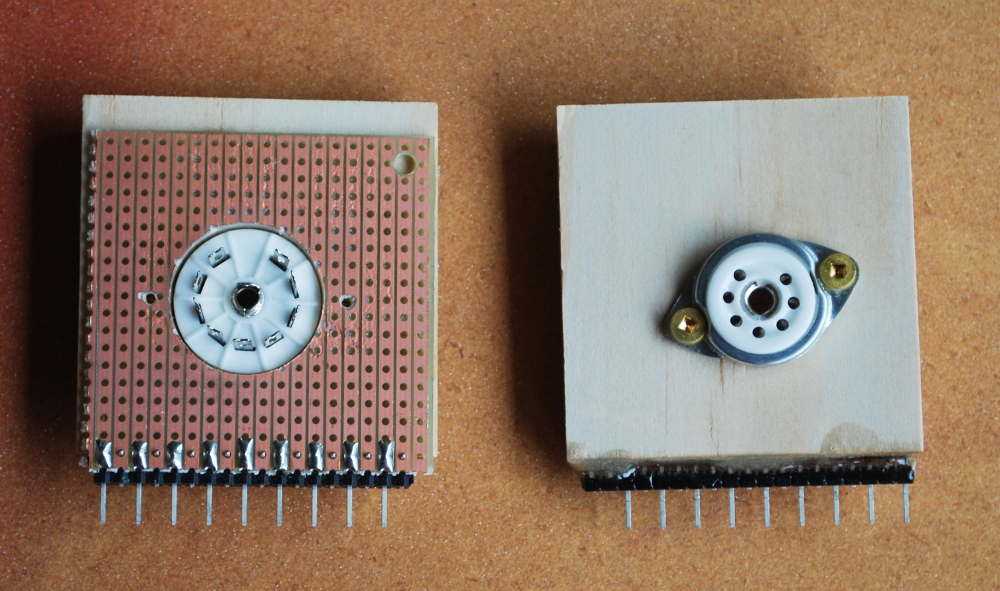

A few days I had an idea that might be useful to other tube-tinkerers, so I thought I'd share it here.
Solderless breadboards make tinkering with solid-state circuitry so much easier than the days when we had to solder everything. I wanted to see if I could make it just as easy to tinker with tubes - at least, small, small-signal tubes run on relatively low B+ voltages.

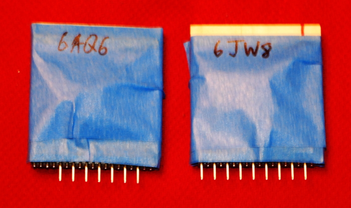

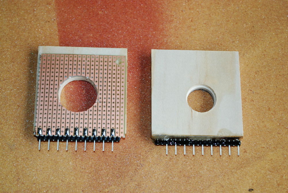

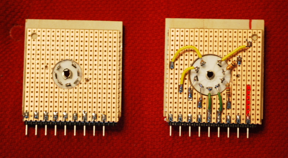

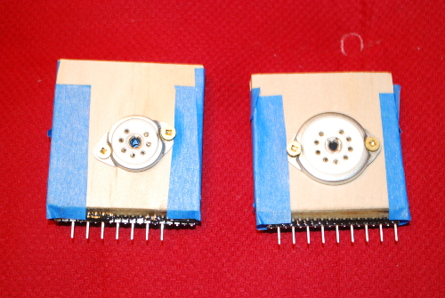

So I came up with the adaptors shown in the attached photos. The basic adaptor is a 90-degree straight pin header cut to appropriate length, and soldered into a square of stripboard. Since tubes run on much higher voltages than stripboards were ever designed to accommodate, I snipped off every other pin, creating a little more room between adjacent pins at different voltages.
To strengthen the little 2"x2" squares of stripboard, I epoxied a same-size square of thin plywood to each one.
The final step is to decide where pin 1 is on the adaptor, and then wire the socket to the appropriate copper strips.
The photos show one adaptor with a 9-pin socket, and one with a smaller 7-pin socket.
I haven't yet used either of these with an actual tube in them, but the first tube I plan to tinker with is a 6JW8 (9-pin base). It is a triode-pentode, so there are three grids that need grid-stoppers (one screen grid and two control grids). You can see two of them in one of the pictures. I forgot to solder in the 3rd grid stopper, an omission I will correct before using the adaptor.
Both the triode and the pentode in a 6JW8 will run pretty happily at B+ voltages from maybe 120V up to 250V or so. I guess I'll soon find out if a typical solderless breadboard will cope with that range of voltages.
These tube adaptors are pretty cheap and simple to make, so anyone who plans to do a lot of tube tinkering might want to make up several, pre-wired for specific tubes, so you don't have to add and remove grid-stoppers, etc.

Solder less bread boards are rated at a maximum voltage of 50volts as the insulation is pretty poor. To put north of 100volts on them is risky and the nominal anode voltage of 250volts is dangerous.
All true. However, there are a few diyAudio stalwarts who have been putting tube voltages on solderless breadboards for years, and I've taken the additional step of doubling the distance between pins, so you get double the insulation thickness.Solder less bread boards are rated at a maximum voltage of 50volts as the insulation is pretty poor.
The breadboard I dissected had about 1.5 mm of plastic insulation between adjacent metal bus-bars. By skipping alternate bars, there is about 3 mm of insulation. I think this will cope with the B+ voltages I have in mind. (And I will report here if I turn out to be incorrect.)
The exposed underside of the tube adaptor is by far the biggest safety issue, and should be treated with the same extreme respect you would give any other tube circuit that's been powered on.

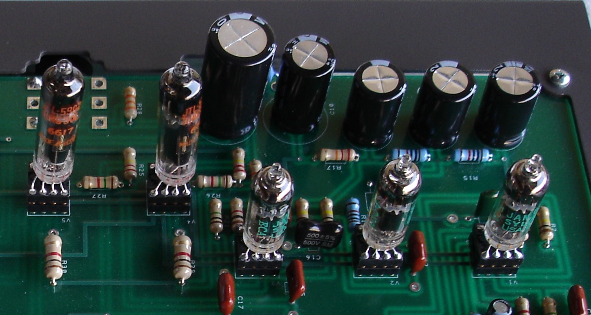

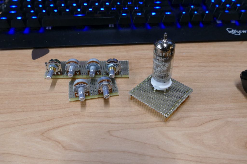

Thanks for your input! I've seen that trick done a few times on various tube forums.I've used IC sockets for sub-miniature tubes, specifically 6122 and 5902, without issues. These run about 170V.
I myself have a few 5902 beam tetrodes squirreled away for a someday project, along with a couple of other less popular subminis. I will confess that the thought of cutting those irreplaceable wire leads short is one of the things that's kept me from using these little subminiatures.
For the moment, I'm tinkering with 6JW8s and 6AQ6s. The beam tetrode in the 6JW8 is easy to operate with as little as 100 volts B+, and the anode will saturate down to 10-20 volts, so it will probably work fairly well even with a 60V B+.
The triode in the 6JW8 triode can work with a 100V B+, but you can use more of its characteristic curves, and it works more like a half-12AX7 (with usable curves to Vgk=-4V) with 200 volts B+.

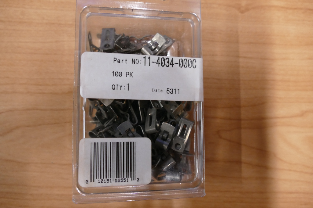

Back in the 1960's I had an electronics kit that used little spring connectors to make connection to leaded parts. I made adapters to use vacuum tubes on this board since the pegboard base was quite large, about 18 X 24 inches with holes on 1 inch centers. I used it well into the 70's when it just finally fell apart. I have searched in vain for those little spring connectors for years, finally finding something similar at Sparkfun. I bought a bunch of them and started designing a new breadboard that's more high voltage friendly. It got packed up in a partly finished state when I left Florida 4 years ago. It still sits in its box, untouched for years. Sparkfun has since discontinued the little spring thingies, but they are still available on the web under the old Sparkfun part number (PRT-11822). I'm going to get some more while I can for the next generation Tubelab vacuum tube breadboard since I know that the little white breadboards DO have a voltage limitation, and it's only a matter of time before I find it. Here is a video that shows the little springies.

Great idea! I have seen those pictured on the outside of some beginner electronics kit decades ago, but forgot about them long ago. I might get a few to try....little spring connectors...
Some of the first electronics books I read when I was about 8 years old mentioned Fahnestock clips, used to assemble a crystal radio. I've never seen one of these clips, but to my surprise, they are still available on Amazon: Amazon.com : Pack of 10 Fahnestock Clips Electrical Brass with Nickel Plating : Other Products : Everything Else

I used to use the Fahnestock clips when I was a wee lad in the 70's. I think I bought them at Radio Shack. I also bought all of the Engineer's Mini-Notebook by Forrest M. Mims III (attached) from the Shack too. It's what turned me on to electronics.
A couple of years ago I bought more Fahnestock clips on eBay. I like 'em 🙂
Fahnestock clips...but to my surprise, they are still available on Amazon
My first Tubelab prototyping system (the source of the Tubelab name) used Fahnestock clips, I got them at Mouser maybe 15 years ago. They are no longer stocked there or at Digikey. I still have half the box......somewhere.
