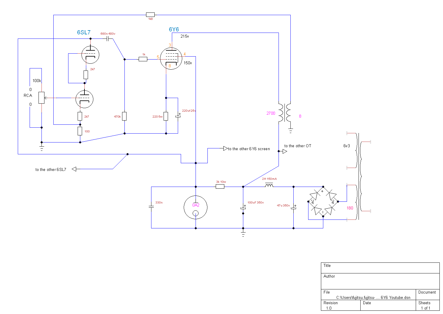

Wait, you are using a shunt regulator for a sweep tube screen grid?
I was also wondering if it makes sense... does a VR tube make something similar?
Yes, 150V 5-30mA stabiliser tube is called 150C1/150C2 or 0A2
But I need 135, not 150 or 105, so I tried to figure out a different way.
There are three methods that lead to three different reactions in the event of a voltage surge ... VR tube would leave the voltage constant on the screen and not on the plate, the resistance would lead to a constant ratio between screen and plate, the shunt instead would be a middle ground. I would like to understand if it is worthwhile to shunt to the ground what is superfluous, complicating the circuit, or if it is not productive.
... I could raise the anode voltage to 215 and let the screen work at 150 ( Someone has done it successfully), but they would work above their characteristics...
That is the project...
There is also an error in the schematic, anode of the SSRP? is coupled into the output tube.

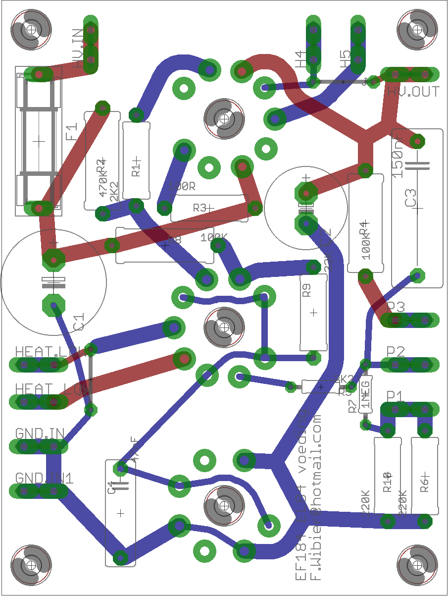

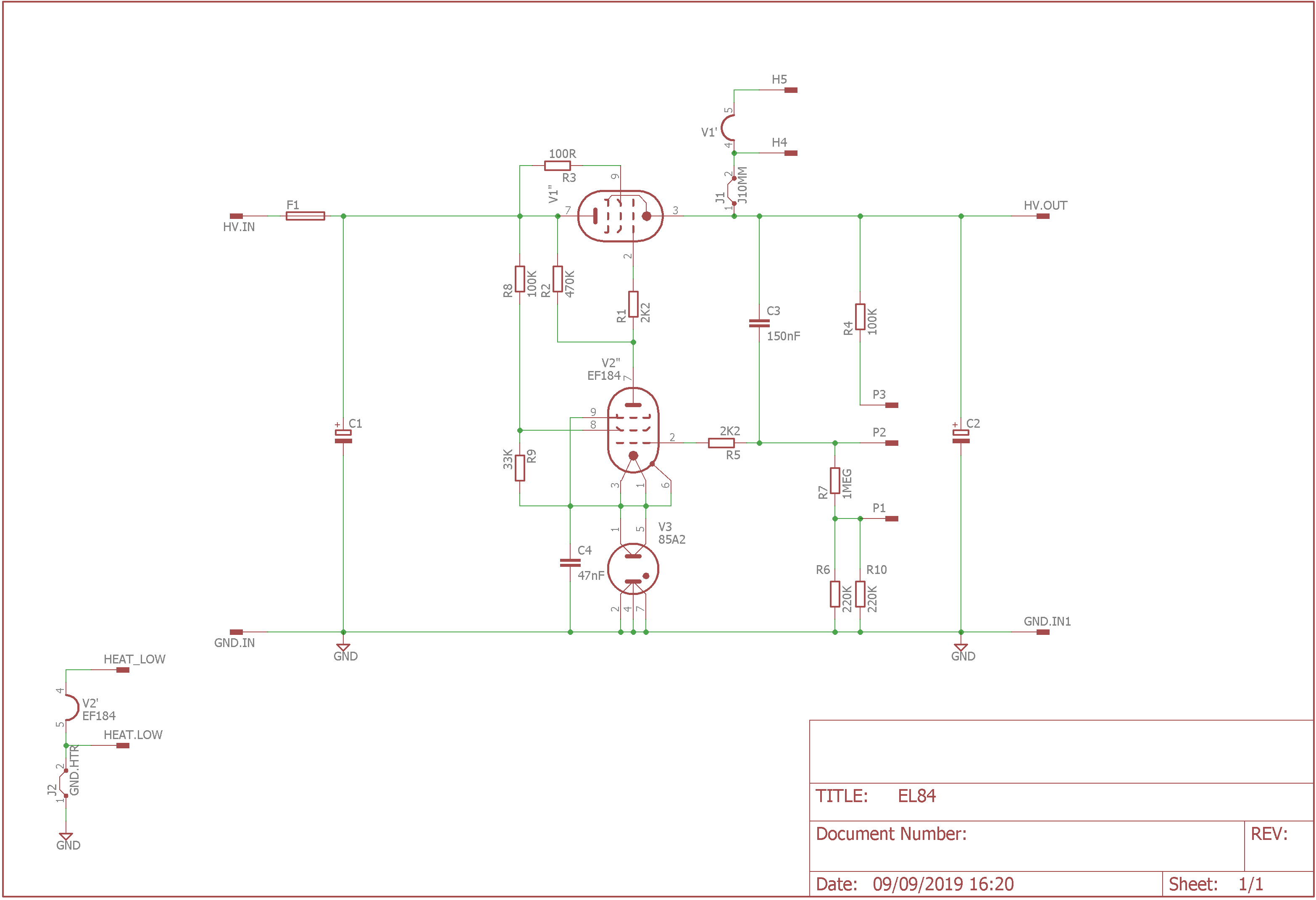

If you just need regulated screens, you can order some boards from my design.

Perhaps VR tube would have higher noise than a regulator.
fyi - Shindo used a simple FET based cap multiplier on screens. If you’re not adverse to using a FET, this would be simplest and possibly the best approach.
There is also an error in the schematic, anode of the SSRP? is coupled into the output tube..

(the original was like that)
