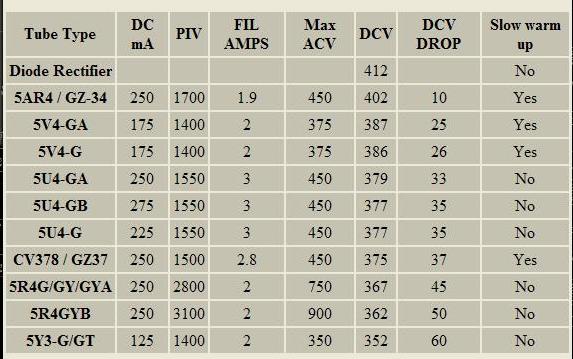

There is a further problem - at these low B+ voltages, the 6AX5 voltage drop compounds the problem: I could not find a 12AT7 in my stock that would perform acceptably well in this configuration. A 6X5 has a lot less voltage drop, but, in theory, can't supply the needed current even with the current boost allowed by an LC supply.

This got the B+ acceptably low, but presented another significant problem - there is a voltage floor, below which the front end just won't work without alteration. That floor is right around 245 volts, and, at these very low voltages, 12AT7's have to be hand selected. Most won't work correctly and show horrific distortion numbers - it takes a large pool to draw from to find an example that will show low distortion. At 255-260 volts, a few more will work correctly, and as voltage increases, more and more will work. Obviously, this is tedious and wildly impractical if one does not have a large quantity of tubes on hand.

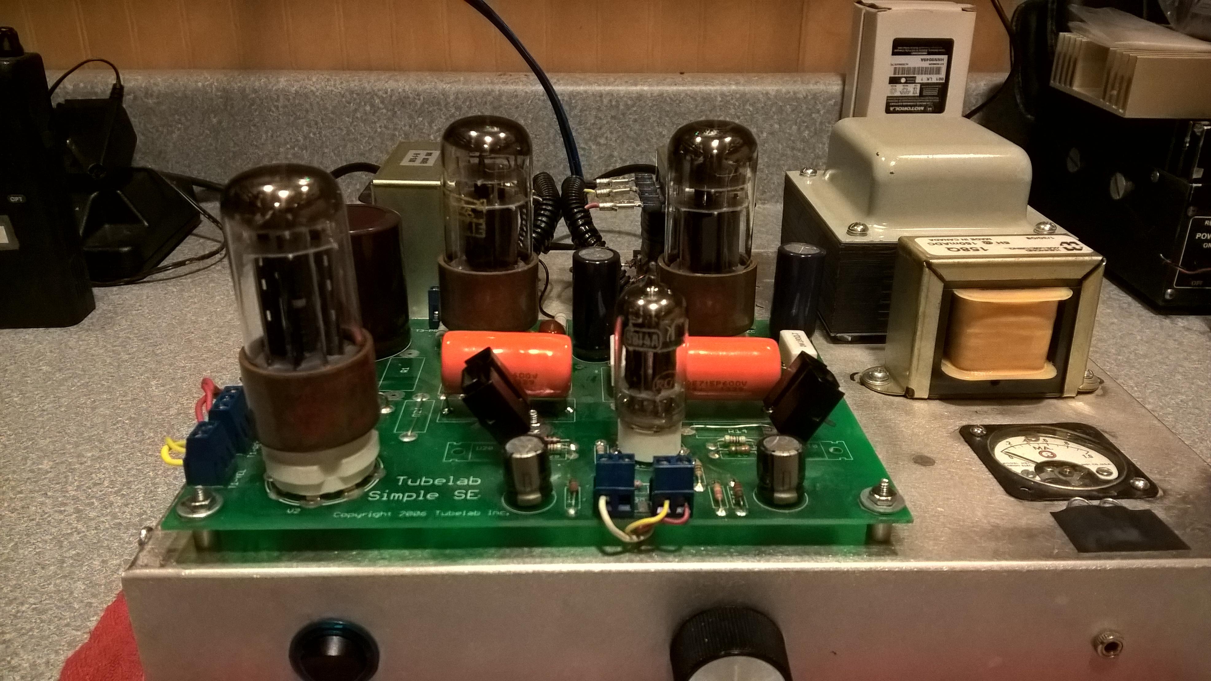

Here are a few pics of the latest iteration, dressed out in righteous cold war tube glory.
Interestingly, the 5992 seem to have higher distortion than other 6V6 types. I remember when I was playing with 6889, they had a very apparent audible distortion drop after a half hour or so. I haven't really had the time to let the 5992's just sit on the meter for an hour to see if they have the same characteristic.

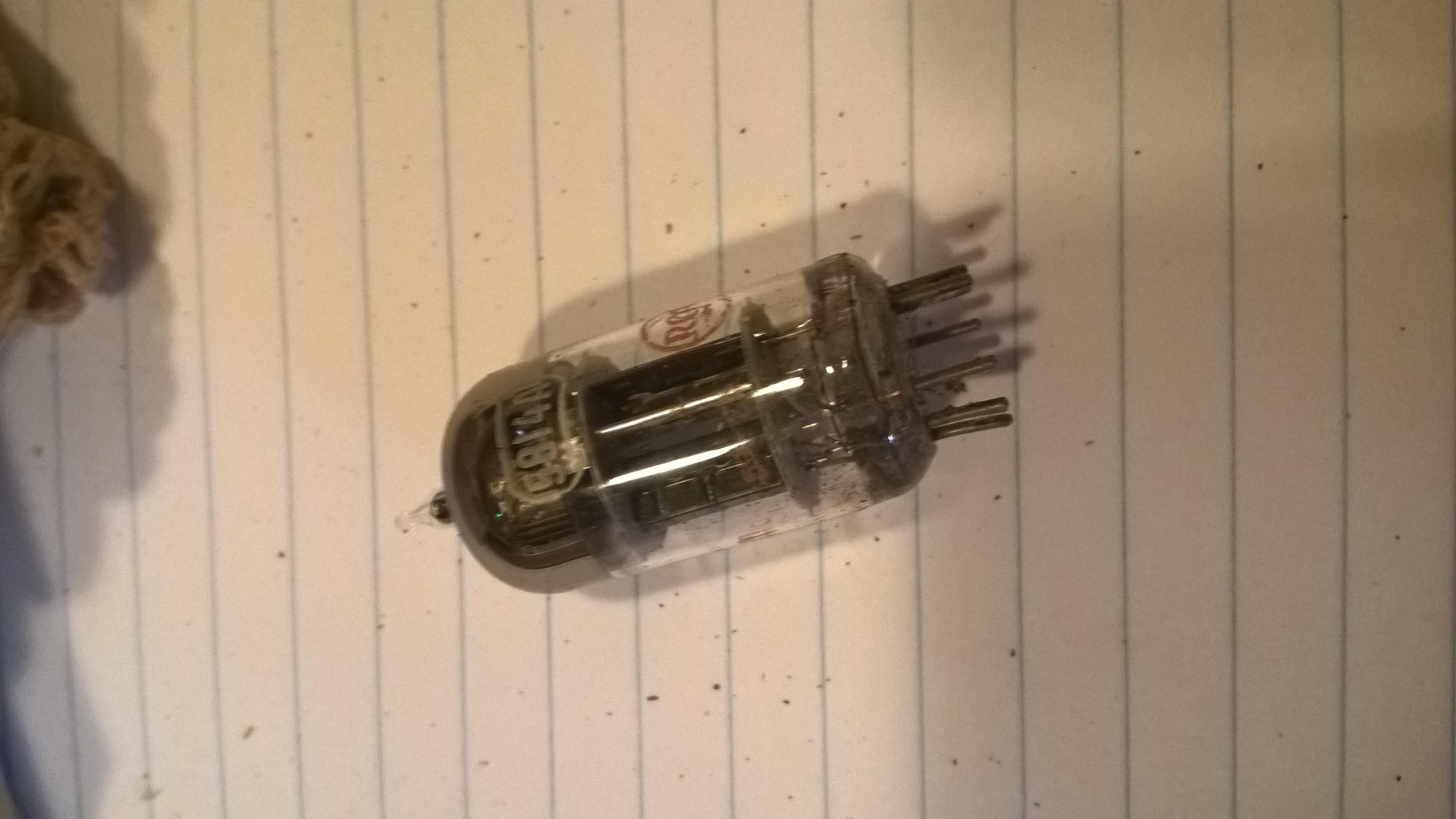

Also are some pics of the extensive packaging that the RCA 12AU7 came in. I have quite a lot of these tubes. You may not be able to see from the pic, but the pins were snaggle toothed, and I am sure it had never been out of the packaging - removing one destroys it.

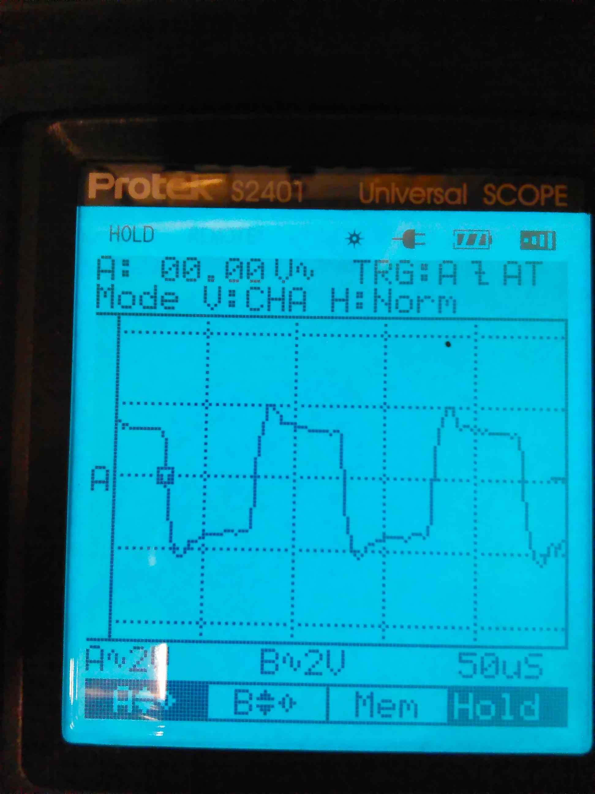

The power supply changes have helped. Here are some pics of a 10 kHz square wave with 2E26 and the current power supply configuration. Much better, but still not pretty. There is something wierd going on in the right channel. It has always looked the worst of the two.

I've attached a chart that shows the voltage loss and ratings of common U.S. manufacture vacuum rectifier tubes.
The current ratings shown are for a CLC ( capacitor input ) power supply; in most instances, an LC ( choke input ) power supply will allow more current to be safely drawn from the rectifier tube.
A couple of compatible octal types not shown on the chart: 5T4, almost identical to 5U4, except it is in a metal bulb, and has a 2 amp filament. Common, inexpensive, and AFAIK, all were made by RCA. At least all of mine are.
5W4, somewhat similar to 5Y3. Slightly more voltage drop, slightly less output current. Not all that common, but not hard to find, either.
As to the input capacitor: U. S. made rectifier tubes are rugged and hard to kill, even if you try. I would use whatever value capacitor you need to get the voltage that you want, and lose no sleep over it. Tubs and tubs of good, used, U. S. made rectifier tubes at hamfests are clear evidence of their toughness and longevity. I don't recall ever seeing a bad one. Others may disagree; this is my experience.
As to old stock Russian, Chinese, and Eastern bloc rectifier tubes, and current manufacture rectifier tubes; I have killed almost all of them I have gotten my hands on, usually without trying. If you can find a datasheet for one of those tubes, I would closely follow their ratings.
8K probably is too high for EL34, especially at these low voltages. But it won't hurt anything at all to try them, and you may like the way they sound under those conditions.
edit: I don't know what tubes are available to you - 8K would be very well suited for 6K6; a little less power than a 6V6, but a true pentode - it sounds different ....
Win W5JAG
Win W5JAG
