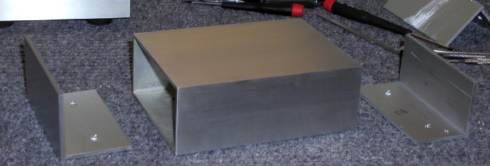

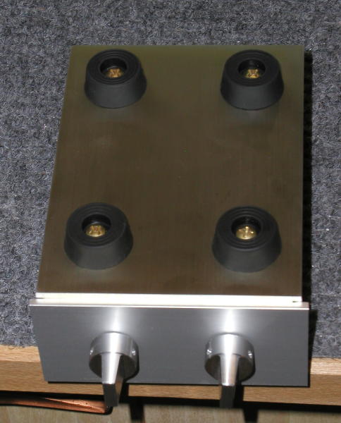

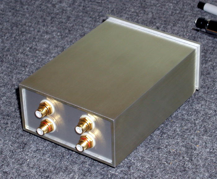

A simple chassis idea

Besides, I wanted to have it done the same day. I would spend more time driving to the anodizing place than doing it myself at home. Preparing a drawing for a CNC machine would take me probably more time than cutting it myself in my workshop. And applying alodine is not more dangerous than etching PCBs.😉

In the same manner that you can order PCB's online, wouldn't it be cool to be able to order a chassis from various stock rectangular extrusions, being able to specify the length (all the case people whould have to do is cut it in a chop saw)
The spec the front and rear panels using Autocad or just specifiing the location of various stock selections (ie: hole center mark for 1/4" shaft with sunburst #4 reference marks, and label underneath saying "volume"
A lot of the fun of designing this service would be to figure out an efficient way to spec the various options. The truth is that there realy aren't that many options needed! The maker could state that they only put labels 3/4" below the knob hole for example, Everything could be laser engraved on the front and rear plates. Holes would only need to be marked, the actual hole can be drilled by the user.

The alodining process is very interesting as this results in a finnish that are non insulating so you get a better enclosure with this than the anodized aluminium when you put the parts together.
Now Peter tell us how to do this magic Alodining.🙂
I just pour the alodine into a flat bottom container and then immerse the part into the liquid. Usually 2 min. is OK. The longer you keep the part in a bath the stronger gold color it acquires. Then I just clean it under running water and I'm done. To make even better there are two more chemicals you should use before actual alodining (they clean and deoxidize the part) but since I don't have them, I don't use them. Alodine finish doesn't prevent scratching (like anodizing), but it's good protection against oxidizing and fingerprints.
