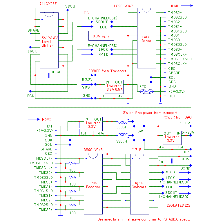

I'm surprise this connection even works as it does not seem like the HDMI LVDS drivers have enough voltage swing to match the wider TTL voltage level inputs on the RJ45 input. Plus the LVDS drivers are differential where 3.5mA of current passes one direction or the other for digital 1's and 0's. This means the negative side of the LVDS pair is required to complete circuit. And LVDS has a voltage offset above ground. But I take your word for it but would like to see the resultant waveform on an oscilloscope before declaring victory. If the o'scope reveals not so perfectly square signals you are probably introducing jitter which is whole point of LVDS in the first place.
He is grounding the LVDS- leg. So it basically forcing the LVDS to run unbalanced. The reason it works to spite the voltage mis-match is because I2S is rather low bandwidth and very forgiving.

A solution could have been to change the input connector of the QLS QA-100 to a HDMI one with LVDS receiver putting out plain I2S signals. OP found the proposed solution in 2015 so things already work one way or another. Despite having used I2S over HDMI I ended up still working with the inferior SPDIF because ease of use and not needing to operate every new device I get my hands on.
http://www.diyaudio.com/forums/digital-source/237690-ps-audio-i2s-interface.html

New techniques are easily accepted here so market acceptance of I2S over HDMI is no issue contrary some more conservative areas. First experiences were with the RAKK DAC that used the PS Audio protocol/system. I2S over HDMI wins from SPDIF hands down and in many cases also from USB. If the ears detect it measurements should easily prove the same results. There are many projects of DIYers adding I2S over HDMI to existing sources, also here on diyaudio.com. The list of manufacturers using it on products is growing too if that says something.
The I2S over HDMI interface must be doing something good:

Like always in life one standard was not enough so I2S over ethernet also exists. No experience with that one.
I was wondering about all the digital interfaces including USB, as all methods have a mix of people for and against... The trouble is not just the sending of the data, the quality of the receiver would also have to be factored in, so comprehensive measurements would be a big task.
A good example of "problematic" parallel interface would be the DDR memory interface. Though I have worked on high speed cable based interfaces, using double sided FFC cables, signals one side return (GND) on the other, but there is a length limit depending on the signal, and its not as cheap as a LVDS serial interface, though the data input can be very impressive.
Actually putting signals down wires using LVDS is often done, especially for some high end test gear, usually custom, but for a simple interface to a DAC it just seems overkill to me....
....Like always in life one standard was not enough so I2S over ethernet also exists. No experience with that one.
Well one version of that is nothing more than RS422 or LVDS over RJ45 CAT 5 cable. 4 pairs fits the application nicely.
But note what I said above about skewing. In CAT5E cable the pairs are deliberately set at different twist lengths to minimize crosstalk. Specifically what you don't want for an I2S application.
If somebody wants to do this right, I would suggest a FIFO and control logic be placed at the receiver that will re-align the edges back to the I2S spec. That can easily fit in a low cost FPGA these days.
