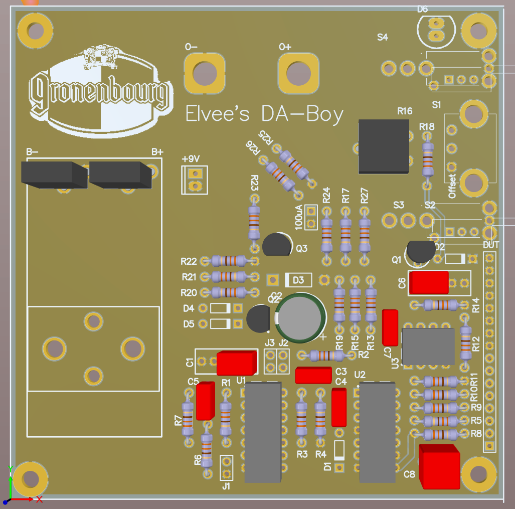

Would someone volunteer to produce a PCB artwork for this project?
It raises interest, but the lack of a PCB is holding it back.
I may do one myself, but it will take ages to complete
I entered the schematic in Altium, can someone double-check?

I've done most of the routing.

OK, done.
I've put a trimmer and a pot for offset, if you put both you get coarse/fine.
No wire mess: battery clips, and 0.1" headers for the capacitor to test.
If the user wants an enclosure (I wont), all the knobs/LED/etc are on the same side, so that'll make a front panel. Except the output, but inside an enclosure, 2 wires should not make a mess.
Ground plane, with reference ground in the middle of the right side (GND pins of DUT, R11,C6, R14). Should I make a cutout? There should be no current flowing in ground anyway when the oscillator doesn't switch...

I can't find the hole diameter for the 3/4" banana plugs, can you get me a part number?
I'll put holes for male plugs (to plug it into the multimeter) and female plugs (to plug banana test leads) so I'll need a part number for both.
Do you want a logo on the silkscreen? Like your Groland avatar? 😀

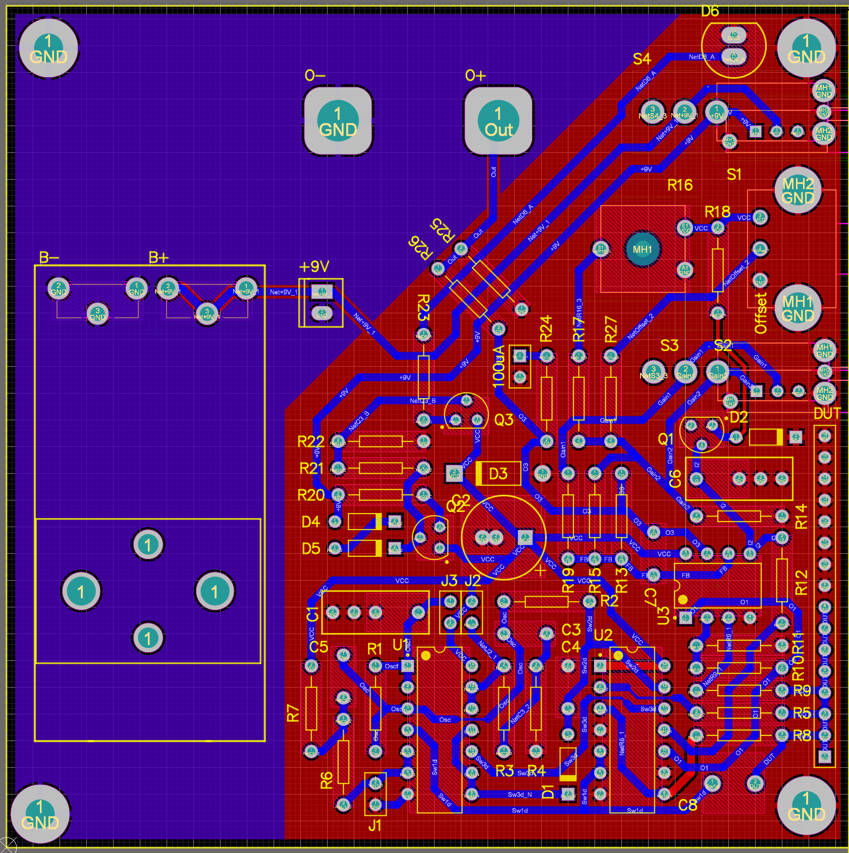

A good shielding is essential, but if the PCB capacitance is large, it risks creating an initial DA, because PCB materials are very poor in this respect.Is ground fill under all the traces and parts associated with CUT a disadvantage?
Here, the extent of the tracks seems reasonable and shouldn't be problematic

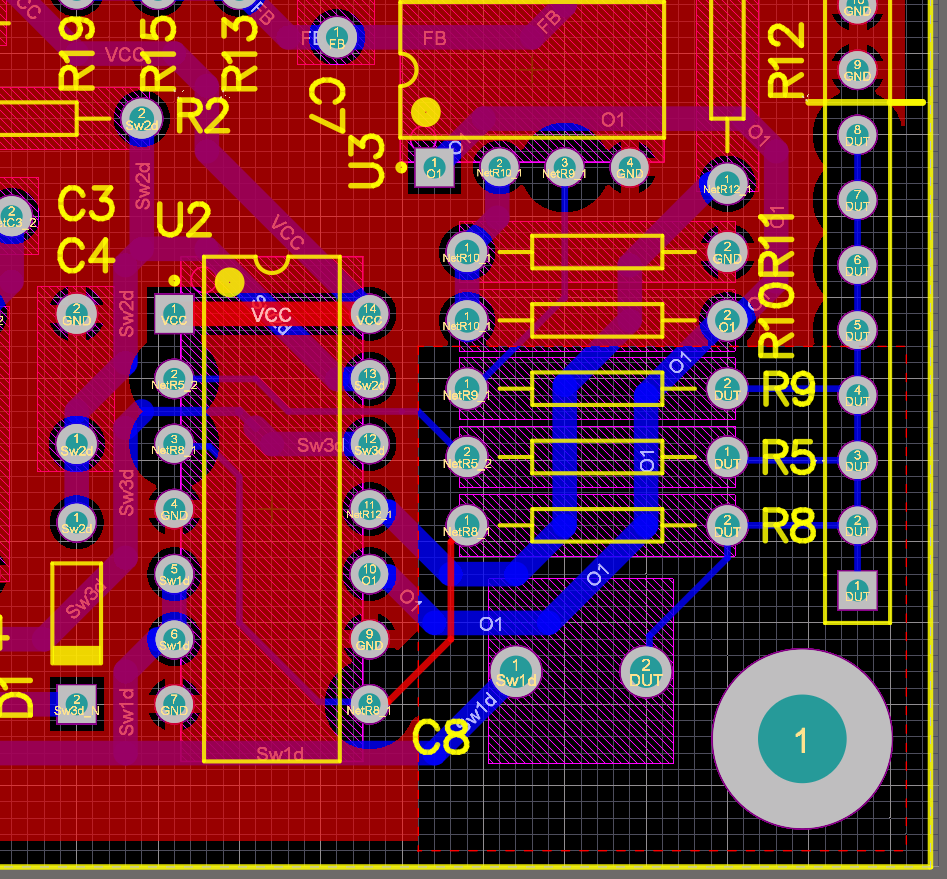

I've reduced capacitance: skinny traces, more copper pour clearance, and cutout to reduce capacitance between ground plane and resistors that will be right on top of it.
...but the cutout means slightly more e-field pickup.

We have to chose between two evils. As I said, the capacitance doesn't look problematic, but for measuring low capacitances in a normal lab/workshop environment, the shielding is essential.I've reduced capacitance: skinny traces, more copper pour clearance, and cutout to reduce capacitance between ground plane and resistors that will be right on top of it
Therefore, I think it would be preferable to revert to the previous version, if you don't mind; or find some kind of tradeoff
