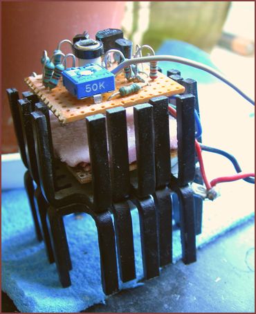

If you study this picture I took 20 minutes ago,
you see my circuit has got 3 connections = 3 wires.
Those 2 in bottom right, are those you connect to transformer.
this is the both legs of this active resistor.
> red = V+ from rectifier bridge
> blue = V- from rectifier bridge
> grey = the upper little wire, to measure the current across 1 Ohm resistor
1 Volt between blue/grey = 1 Ampere
0.5 Volt from = 500 mA
Actuially I remember now, that 0.5 Ampere is the max current I dared to pass.
Now if we know Voltage between V+ and V- and the current
we can get this resistor value:
Volt / Current = Ohm
Here is my fresh photo, showing these 3 wires.

Yes, it has two basic modes.
As a constant current source load and as a constant resistance load.
It is upto anyone what one think one need.
For me it is enough to have an adjustable and constant resistance load.
Because I only use my unit for testing new transformers.
To see what Voltage DC output will be like with some loading.

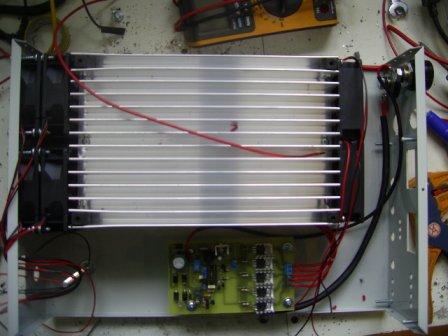

Some time ago i builded something simular to a regulated load .
Since i only used it in prototyping fase there is no problem posting it here .
Let me start from the beginning .
This module is a test setup i builded as part of a battery charger / discharger for the Nickel battery of a tram .
There are 2 versions first just discharges at the rate you set with the duty cycle potentiometer the second is current stabilised .
As i builded it with 42 Volt @ 20 Amperes it functions at about 52 Celcius .
You could smoothen it a little by adding capacitors .
It is very straight forward i guess (although its a little bit of abuse of parts)
Termistor (r20) or shutdown line (5 volt from microcontroller) can shut the pwm down through the shutdown pin.
The rest speaks for itself i guess ,most of you will know about the SG3525
The second version differs only in a sort of *feedback* the first version the current dropped with the voltage the second makes the duty cycle rise when the voltage drops stabilising the current .
You can easily make some changes or upscale c.q. downscale if you like .
In the zip file you will find a multisim schema (no simulation) ,
2 pcb's made in proteus and a picture of the module as i builded it .
Do keep in mind the pwm is not filtered .
For smoothening you will have to add capacitors or calculate a filter according to the frequency you set .
The design itself turned out to be very robust .
Even uncooled the mosfets are no more then handwarm (also reversed polarity proof) (i used irf1405)
I never had any destroyed parts in this setup while the test supply was upto 50 volt 25 Ampere .
(Be carefull soldering the mosfets cause there is little space between the leggs)
http://rapidshare.com/files/133893583/pwmload.zip
Good luck 🙂

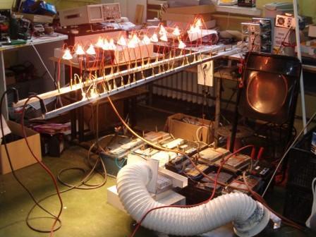

Yea sure, but you can stop there... Anything else, like low voltage, or high current or fast adj. is out of the game...
The semiconductor version is only usable for small powers .
If you want it to be reliable you will have to use resistors & mosfet .
For testing on high power like i had to do with the trams or chargers upto 2 KW using the I2R of a mosfet is almost impossible .
To do that with lightbulbs (which we did at times) its to much work .
This was maybe a bit more work but its sure beats garbage cans of water with resistors + 30 halogens for testing a 150 Ampere charger .
With a microcontroller you can easily make a nice resistive pwm load .
(the final versions i made are based on microcontroller)
Same setup just the pwm & ventilator control are done by MCU .
For powers of a Kilowatt or more only semiconductors is no option i'm afraid .
@Dmfraser.
You mean something simple like this ?
(Victim under test is a 13.8 Volt - 133 Ampere lead acid charger)
This is why i chosen to put a little more effort into it .
Just hook it up set the current wanted and let's roll.
(is nice in winter too to warm your feet)
