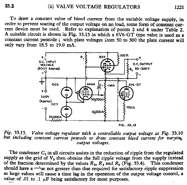

OK, you're true. In the Langfrord-Smith's book Radiotron, there is an example of such a circuit using vacuum tubes. If I'm not wrong, he used a 807 as series pass ellement and a 6V6 as shunt device. I'll see if I can find it.
he used a 807 as series pass element and a 6V6 as shunt device. I'll see if I can find it.
Yeah, I got it!
keep in mind, for those not skilled in tube art, that there aren't tube P devices.

The tube circuit Osvaldo showed is not about shunt regulation.
It's a series regulator with a constant current load.
Exact. It is explained in the book, but I wanted to mean that the idea is old. Constant current or variable inversely with the demand, is the same idea, but the first was easier to build in such days.
