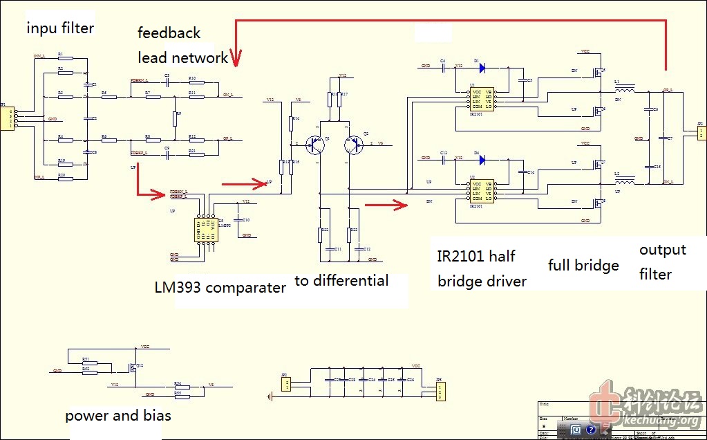

it‘s basically a differential amp that uses ucd feedback topology on both P and N side. also support differential audio input. if one have only single ended audio source then the other leg of audio in shall be shorted by jumper.
