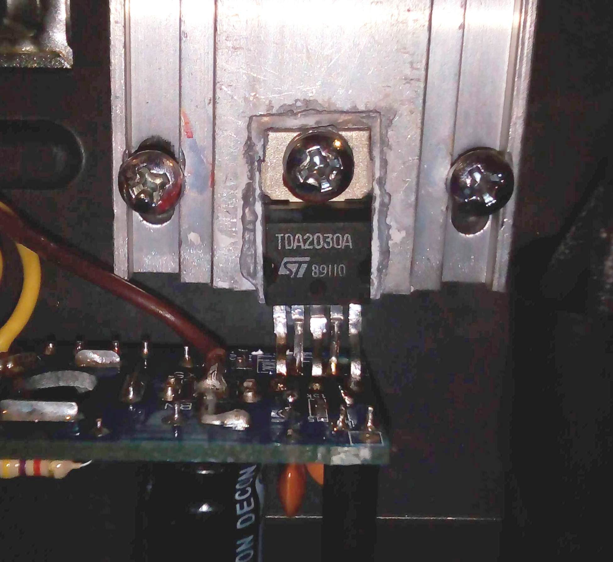

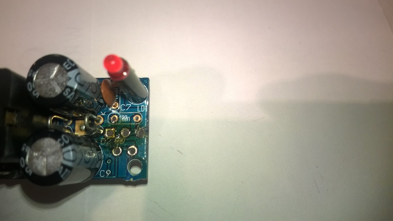

So, I inherited a broken Behringer AT108 acoustic instrument combo amplifier. When turned ON it makes a continuous booming low frequency noise and I noticed the speaker cone moves all the way to the back and does not come at the resting (mid) position unless I turn it off.
I looked inside it is based on a TI074C and a D2030A. I happen to have a 2030 laying around so I will just try to replace that and see what happens. I also tested the PSU and (I think it is working fine) it produces 13.4V AC between the brown wire and any of the two yellow wires, while between the two yellows I read (as expected) double that, eg 26.8V AC. Now I have no sure way to measure how much DC actually reaches the power amp, so what I'll do is when I remove the IC I will turn on and measure at pads (pins) 3 and 5. I expect to read around 30-35V DC. I hope I won't make things worse, but my hunch is it's just the power amp IC is bad which should be an easy repair. What do you think?

One advantage with class AB (such as TDA2030) is that you can test the circuit without a speaker connected and get a very good indication of the state of the amplifier circuit. It may be the TDA2030 that is defect but it may also be one of the electrolytic capacitors. In particular, I would suspect the coupling capacitor at the output, between TDA2030 pin 4 and the speaker. The reason: The fact that the speaker goes to the back indicates a DC across the speaker. The output coupling capacitor should prevent such a DC - unless it is defect.
So, disconnect the speakers, short-circuit the inputs to ground through 1KOhm and turn the power on. First, check the supply voltage and if anything becomes particularly hot. Then, is the voltage at TDA2030 pin 4 around half of the supply voltage? If yes, it is most likely the output capacitor that is defect. If no, why is the amplifier not in regulation?

By the time I got the 2nd reply from ..."FakeFrench" (great alias btw) it was already too late, I had removed the speaker and tested voltages but without shorting the speaker leads using the 1KΩ to ground. I just disconnected the speaker and made sure the leads did not touch. I hope I did not make it worse... ?
Here's what I found: The PSU brings in 26.8V AC exactly as I described in the previous post, e.g. 13.4V on each yellow wire (x2) to brown (=ground). Now between pin 3 and 5 at the 2030 I was reading about 30 V DC, actually it was fluctuating +/- .3V around 30.5V DC.

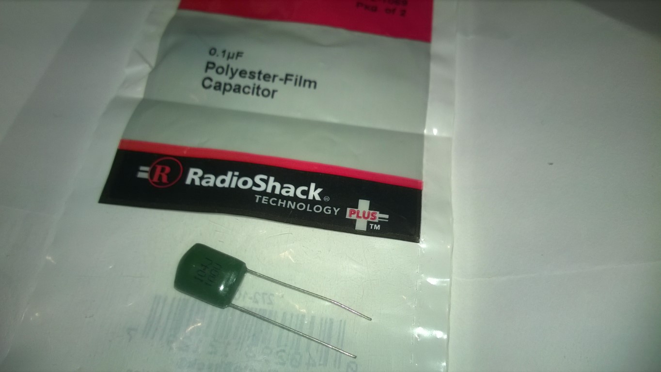

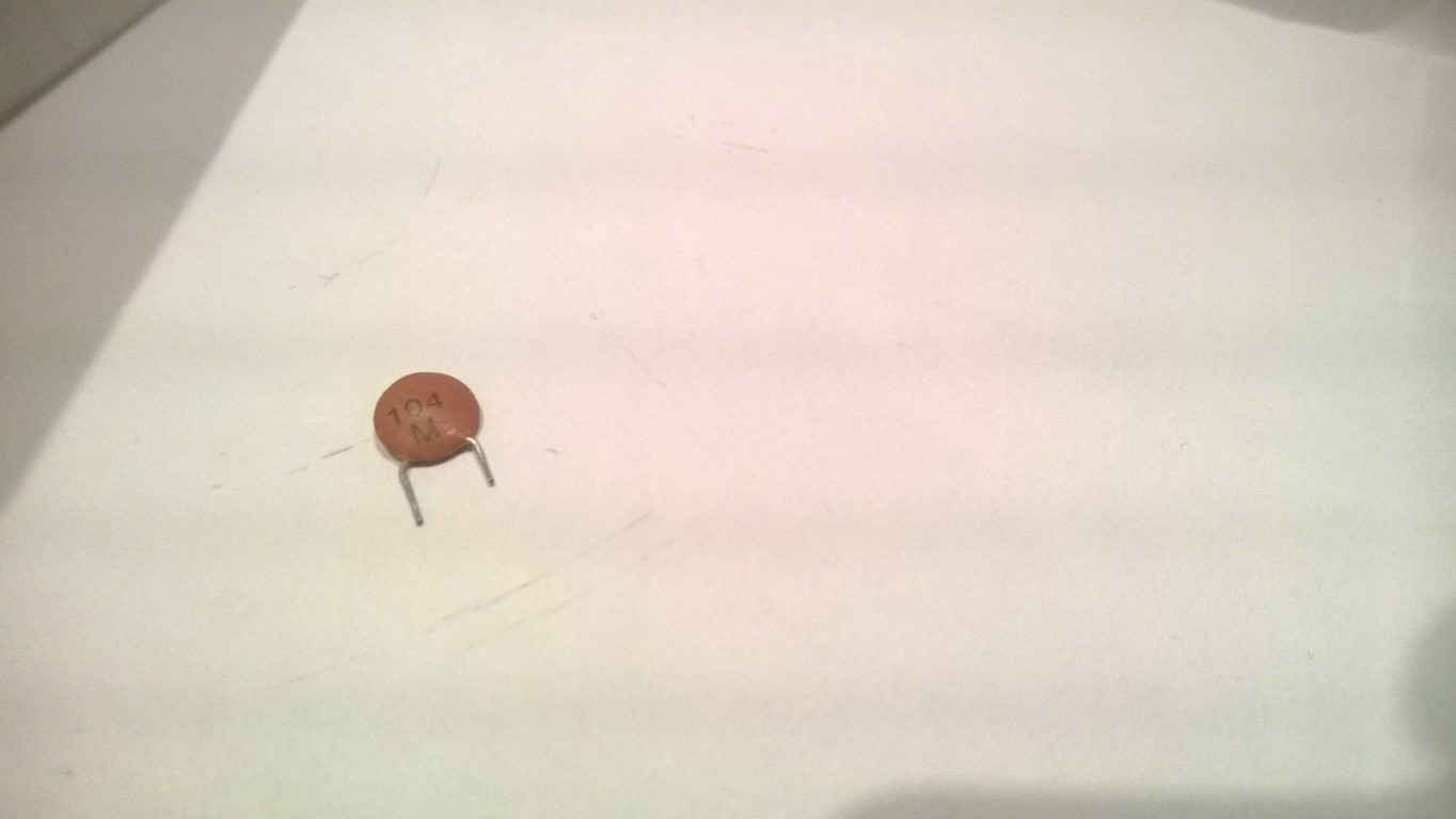

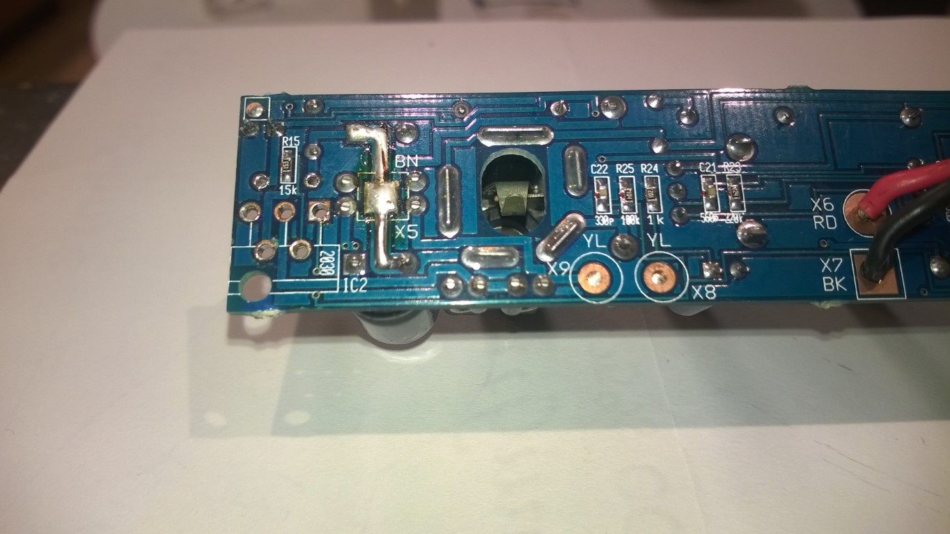

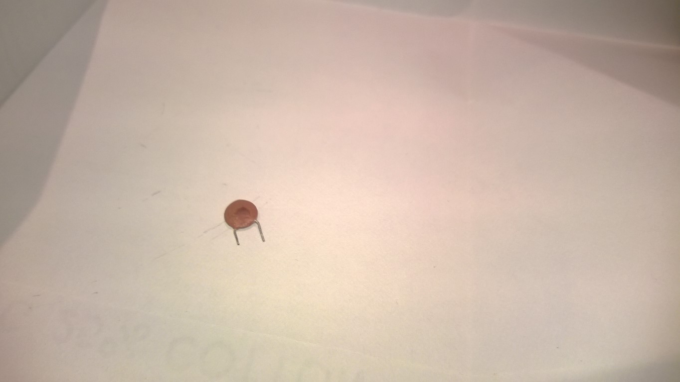

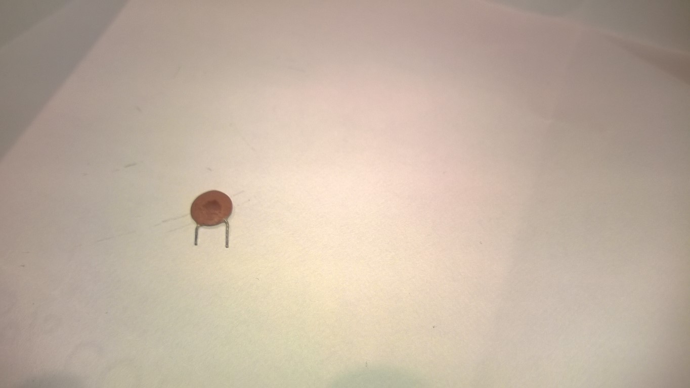

So, I removed the IC (not the cleanest job but I checked pad connectivity and it should be OK). One thing that bothered me is a capacitor in series between pin 3 and the brown PSU cable but not pin 4 that goes to a 15K resistor and then I can't trace it. Anyway the cap is a 104 M ceramic disk (100nF) it has no sign of bulging or anything else just has a bit of brownish discoloration on one side, what do you think? Should I replace that as well? Problem is it's getting late here in Chicago right now and I do have a 0.1μF but it is a radio shack (green) polyester film. Is it ok to put in place of an (orange) ceramic disk?

Yes, you can use polyester film instead of a ceramic disc.
No, test without grounding the inputs hardly made further damage. An open input tends to pick up hum and makes static measurements difficult.
Now the IC is anyway out, check without power all your electrolytic capacitors with an Ohm-meter. Red probe to capacitor "+" and black probe to capacitor "-". Check for steady low impedance (indicates defect).
Thanks, I just checked all electrolytic capacitors, at low 200Ω scale, observing correct polarity, all check fine (actually at initial contact the display appears flashing a random number but in a second it settles to a solid 1. I take that is OK !?). Btw, can I test the ceramic that way, I do not think so (I tried anyway with red/black probe both ways, again no resistance present. I am zeroing to the 2030 being toast, the guy who gave it to me said it stopped working after a minor flood in his basement, however, I found little evidence of rust on the components, some on the chassis but negligible. Anyway, off to get a 2030 so I went looking for the spare 2030 I (thought I) have, it is a 2003, darn it! So now I am off to my friend's John store (Minstrel Music in Niles, IL) he also repairs amps (mostly tubes) but said he should have one 2030 laying around. It's almost a 1/2 hr drive so I got to be there before 8 pm when he closes. I'll report later, I am obliged to all of you for the support, just amazing!

OK SUCCESS !!!
Nothing else was bad on the circuit, my friend John confirmed all caps were in tact and he found me a TDA2030A (which appears to be authentic) installed and the amp sounds fine, actually compared to a similar one he had at the store mine sounds so much quieter now with the IC replacement.

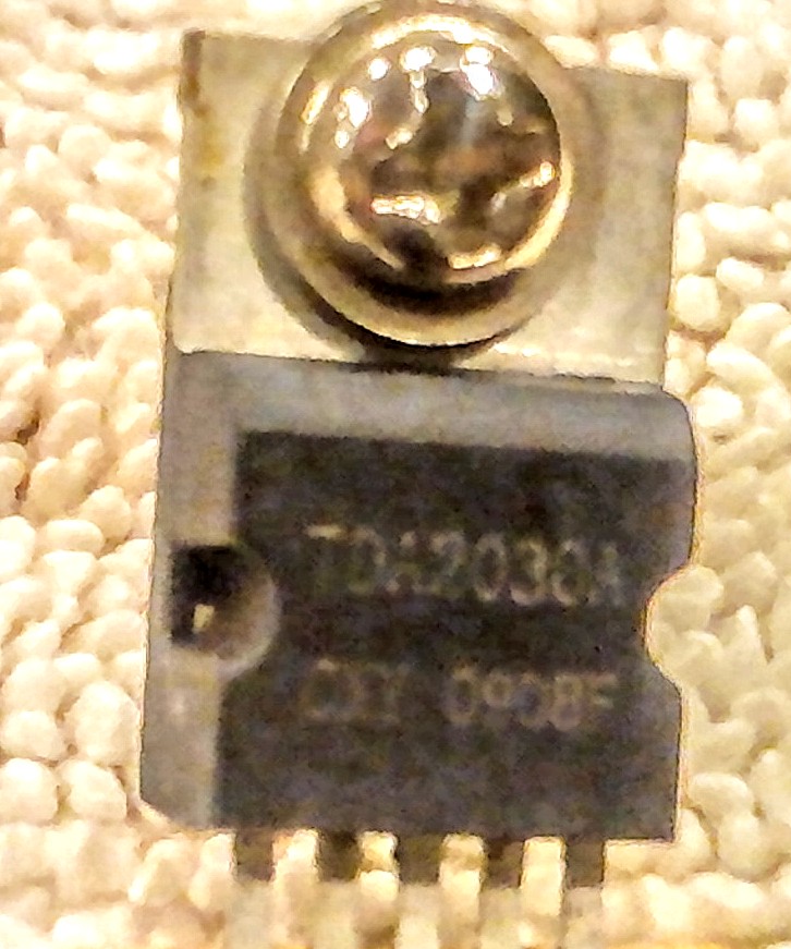

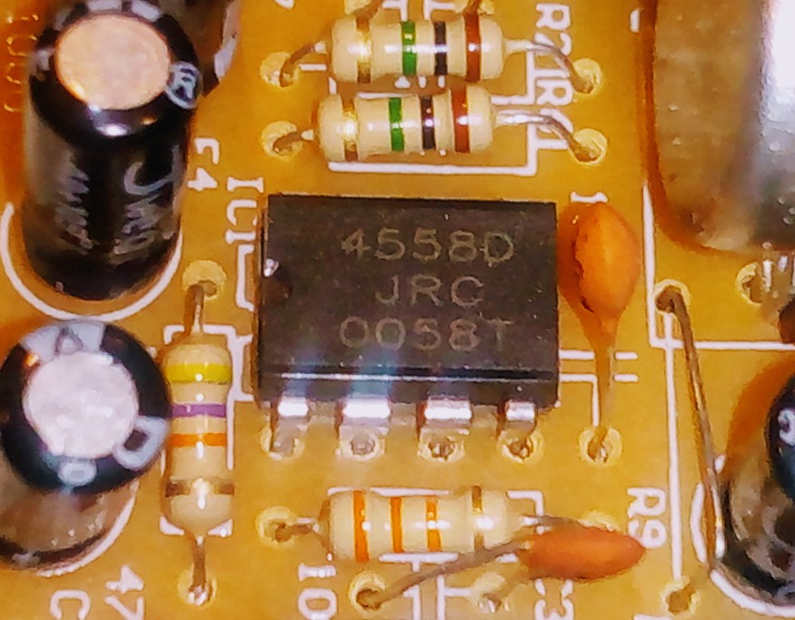

So, I would like to thank you all for your kindness and patience and advice. Also thanks for the BG Micro info for ~$2 a piece I'll give it a try; I did find the spare TDA2030A ICs I had, but I do not trust them, they came from cannibalizing a few cheap FirstAct little toy-amps along with some JRC4558D. If you have time look at the pics (and the inscriptions) do they look authentic to you? I don't know, but I doubt it, these amps were made in China for ToysRus and at their lowest they were selling on closeout for something like $4.99 a piece. Hard to be using original (let alone NOS 4558D) at such a low price.
