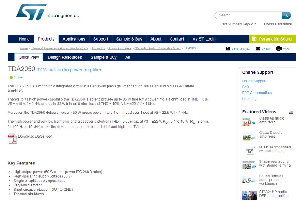

ST Microelectronics has discontinued the following parts:
TDA2003
TDA2030A
TDA2040
TDA2050
There are probably others, but these are common DIY parts.🙁

No wonder they refused my order !!!! 🙁
Although their website shows that it is still active!!

It is typical for manufacturers not to show parts as obsolete immediately. However, Mouser now shows these ICs at EOL (end of life) and DigiKey sent me this:
Dear Valued Digi-Key Customer,
You have purchased the following part number from Digi-Key within the last two years. The manufacturer has announced an update to the part status.
Part Affected
Manufacturer STMICROELECTRONICS
Description IC AMP AUDIO PWR HIFI PENTAWATT5
Manufacturer Part Number TDA2050V
Digi-Key Part Number 497-3028-5-ND
Status Obsolete
Last Time Buy Date Undefined By Supplier
Substitutes Please click here

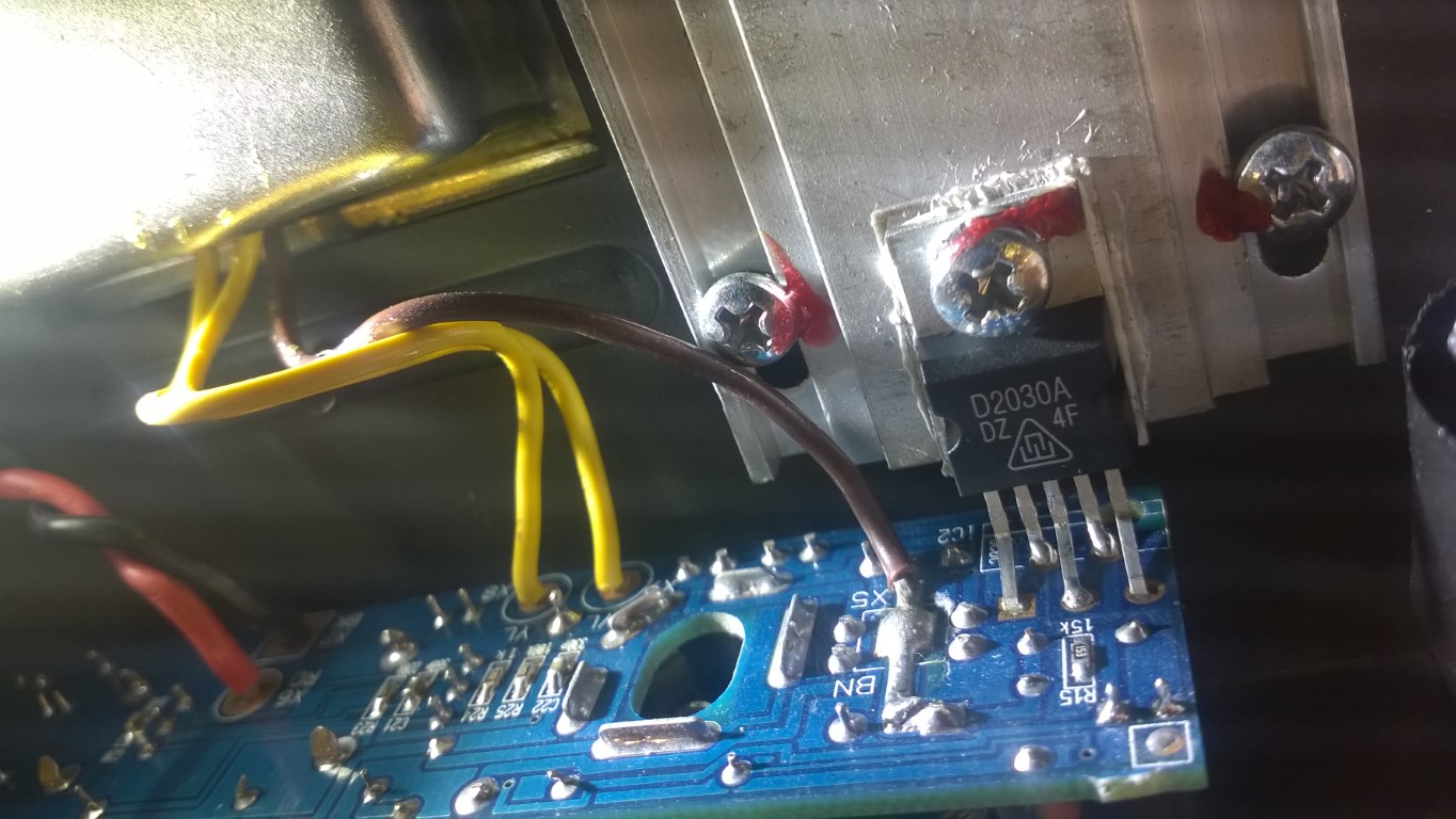

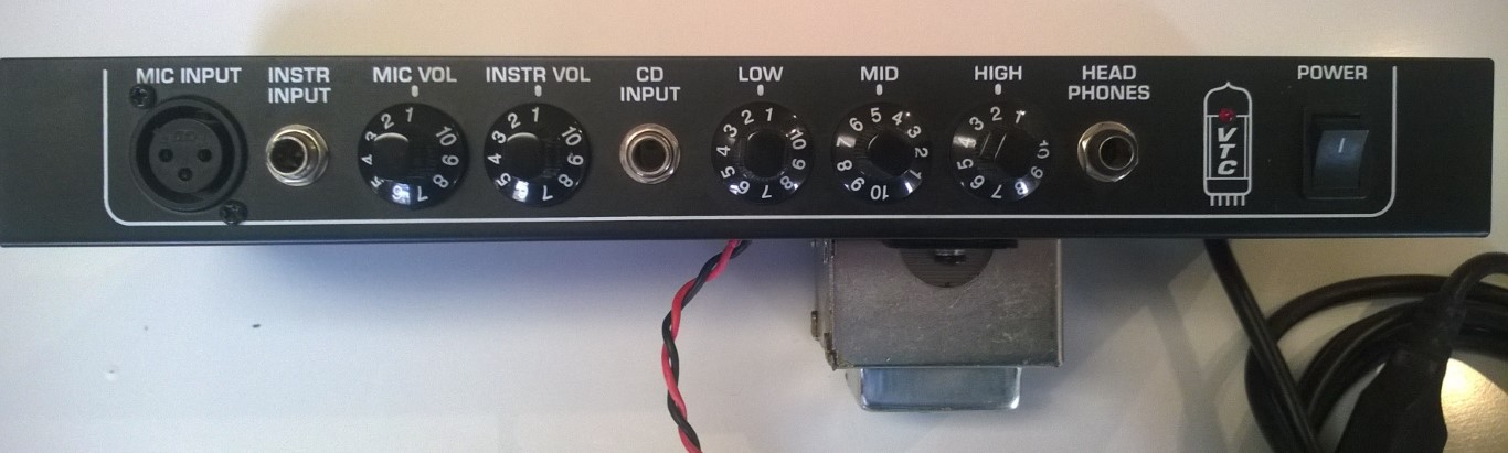

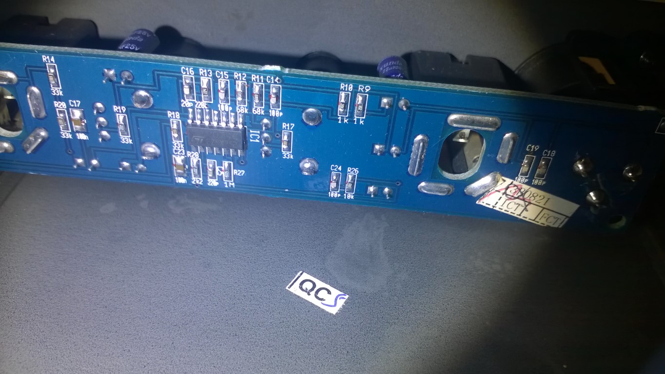

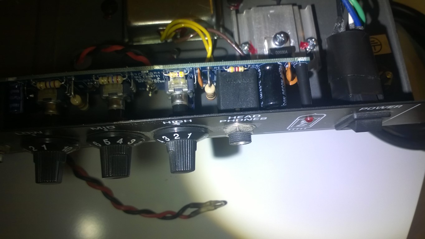

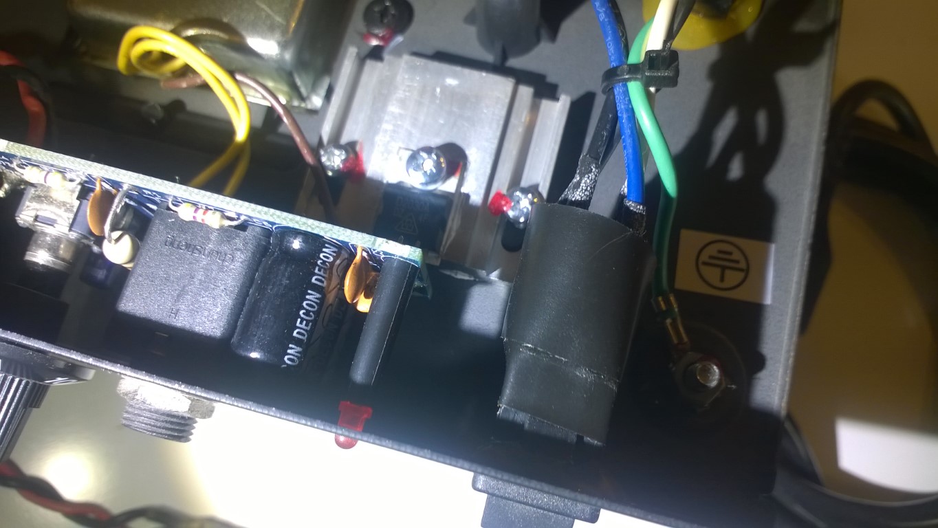

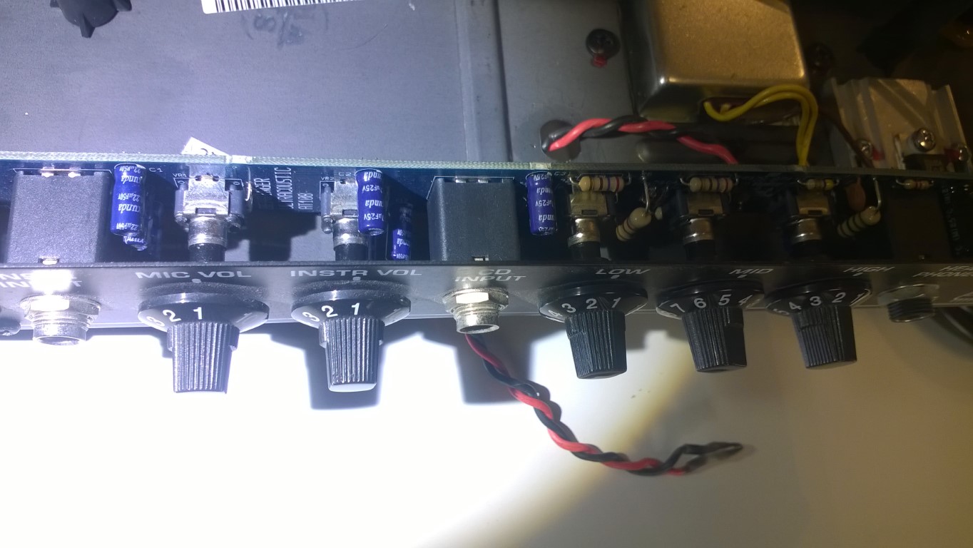

Thank you for accepting my post and the fast reply. For some reason, I am going on a limb here by asking rudimentary questions, but also because I do not mean to hijack the thread, although it is a very old one. I can start a new thread if needed. Please let me know.
So, I inherited a broken Behringer AT108 acoustic instrument combo amplifier. When turned ON it makes a continuous booming low frequency noise and I noticed the speaker cone moves all the way to the back and does not come at the resting (mid) position unless I turn it off.
I looked inside it is based on a TI074C and a D2030A. I happen to have a 2030 laying around so I will just try to replace that and see what happens. I also tested the PSU and (I think it is working fine) it produces 13.4V AC between the brown wire and any of the two yellow wires, while between the two yellows I read (as expected) double that, eg 26.8V AC. Now I have no sure way to measure how much DC actually reaches the power amp, so what I'll do is when I remove the IC I will turn on and measure at pads (pins) 3 and 5. I expect to read around 30-35V DC. I hope I won't make things worse, but my hunch is it's just the power amp IC is bad which should be an easy repair. What do you think?
And finally,
1. What other component(s) around the power amp IC should I check before I replace it. I am afraid whatever caused the bad IC will again "fry" the new 2030 as well. Could the 2030 have gone bad on ...its own?
2. Given the attached datasheets, it looks as if the 2040 is a pin for pin replacement for the 2030 and assuming the provided voltage is around 30V DC, without any other circuit modifications, it will produce about 20W a nice improvement from the claimed stock of 15W. Am I correct about this?
Thank you for your help! Let's see if with your help I can resurrect this little amp!?
And finally,
