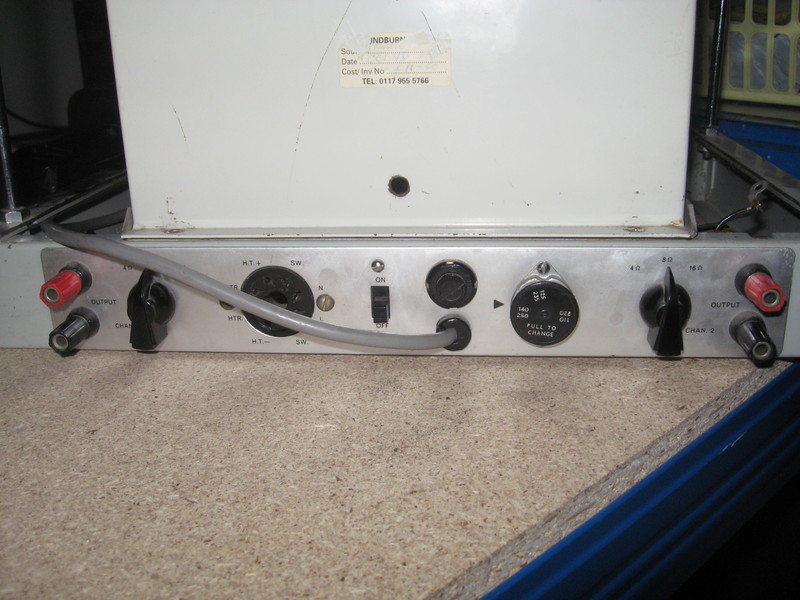

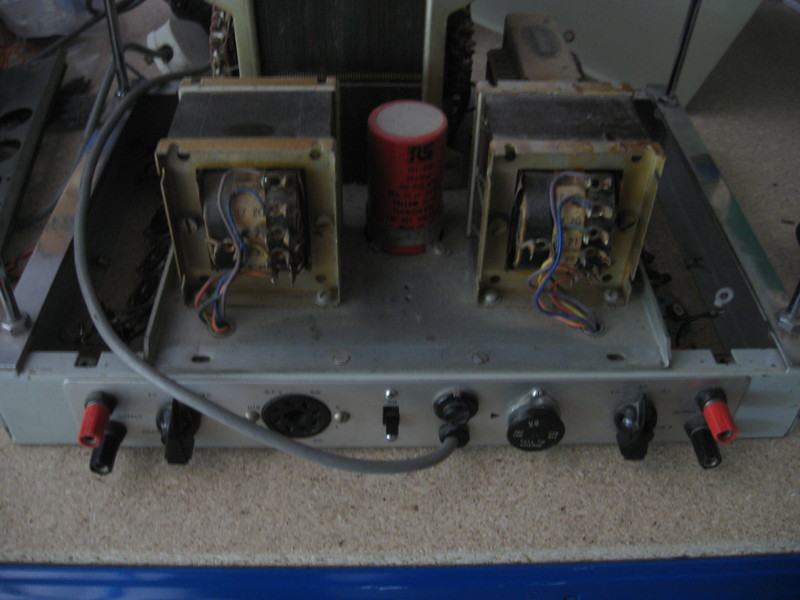

The amp first came to me in quite a mess...
The metalwork had HOLES in it, it was rusty, filthy and the wiring was shot.

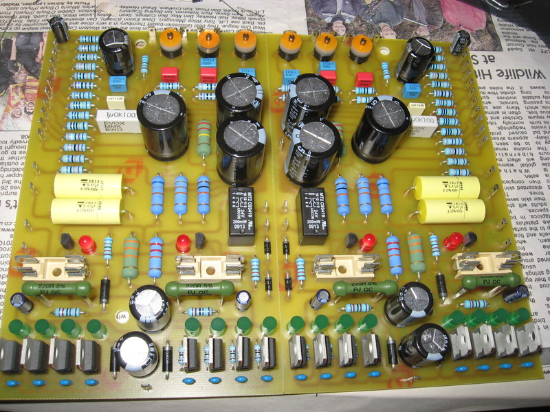

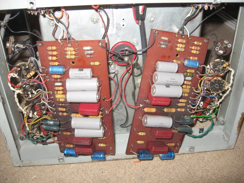

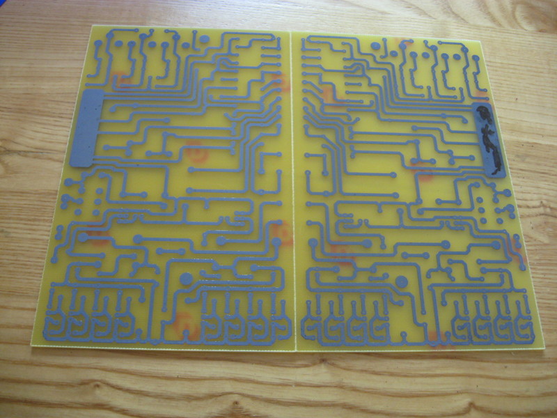

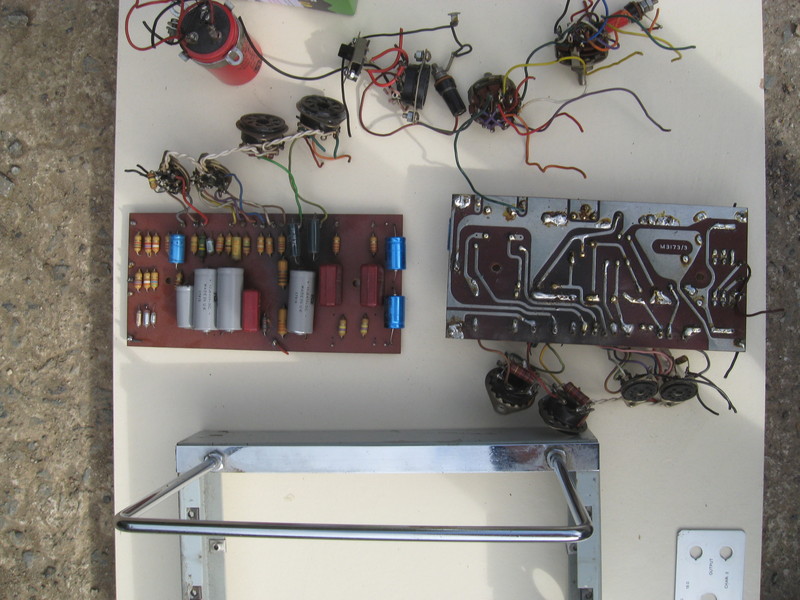

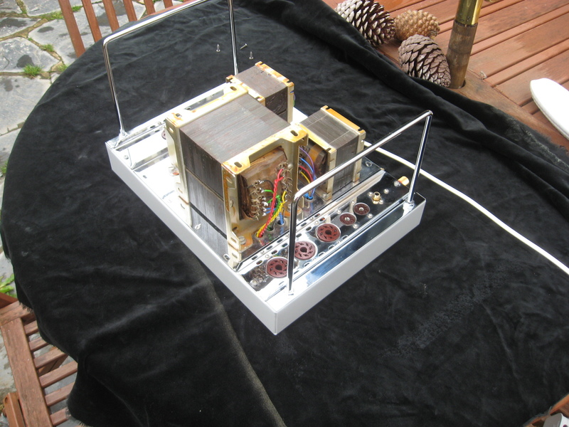

The old PCBs were pretty shot with broken traces so I put considerable effort into making a prototype new design (using the original Radford circuit), with a few tweaks (CCS cathode biasing which turned out to be a more trouble than it was worth) and a better physical layout.

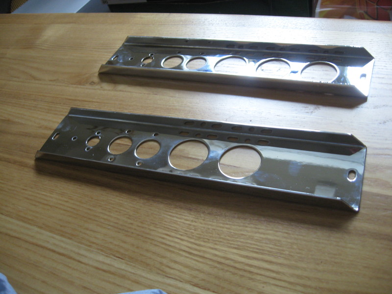

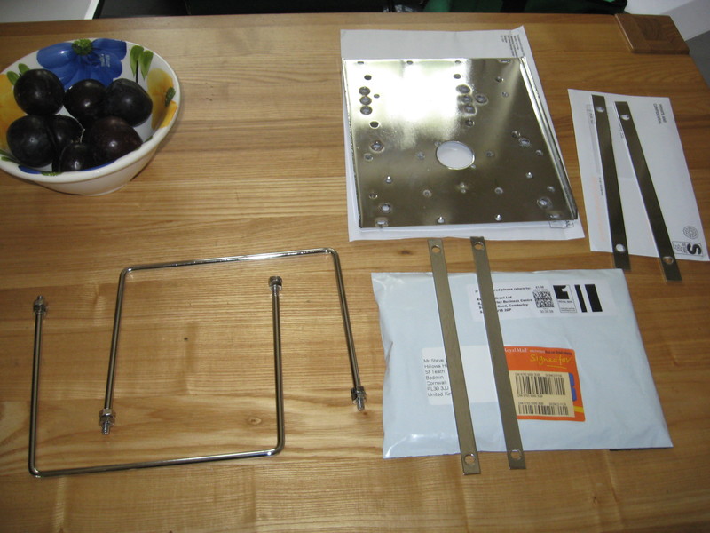

Meanwhile the metalwork I sent off to be chromed came back.

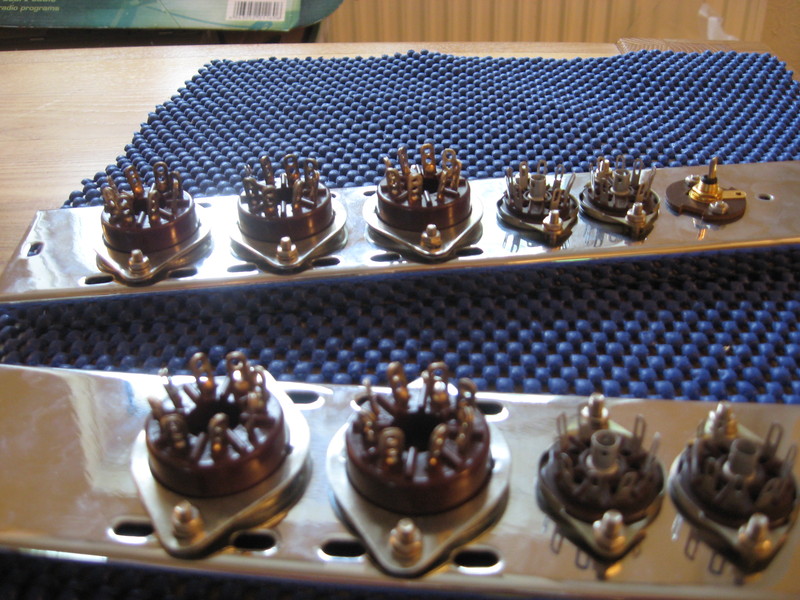

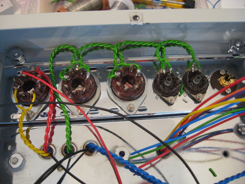

Here are the runners with new valve holders and sockets installed. I even managed to use the original spacer with a new gold plated RCA/Phono socket!

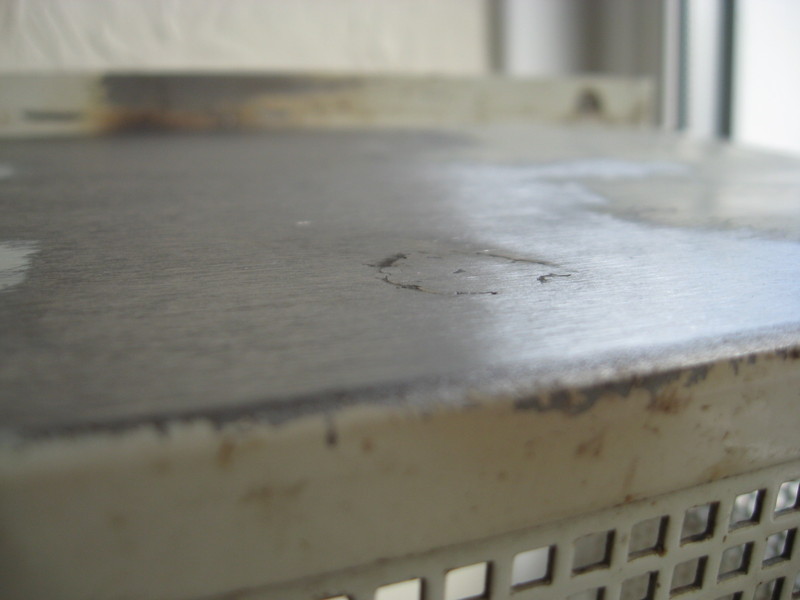

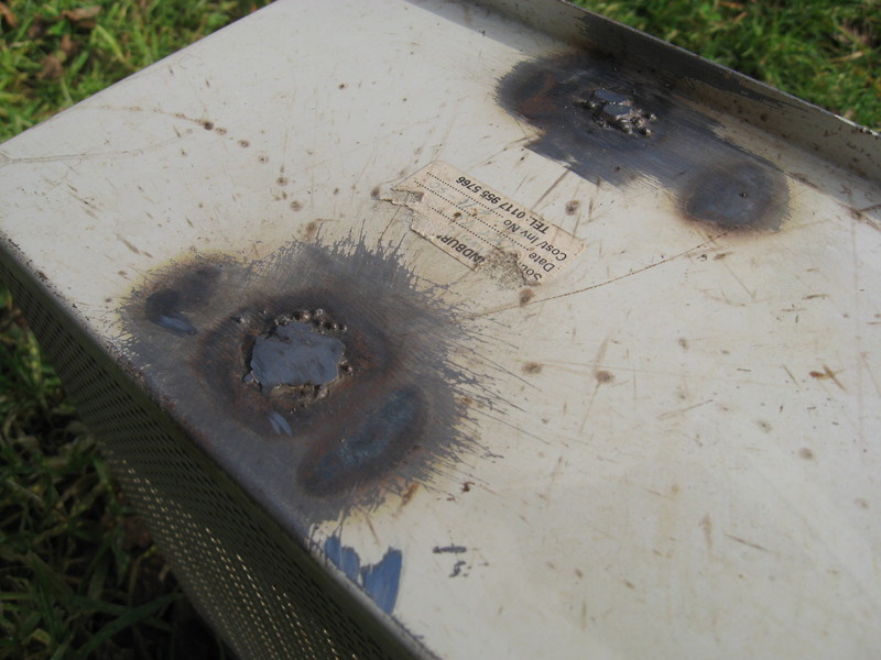

Whoops this is backwards, but before I got the painting done I had to see to those pesky holes. The welding and grinding were not done by me 🙂

Looks great with all the metalwork chromed, The pressings holding the valves are only zinc plated standard, and they easily stain with any moisture that gets on them.
My STA 15 had MK4 upgrade PCBs fitted and then stayed in my audio system for a pleasurable 20 years of use before exploding an electrolytic. It now sits on the shelf waiting to be repaired.😱
The Mk 4 PCBs are very similar to the Mk3 but had added bi-pass polypropylene caps on most of the electrolytics. Other mods that were recommended were hard wiring the output transformer impedance tap without the selector switch. They also supplied a new input socket, and heavy duty binding posts.

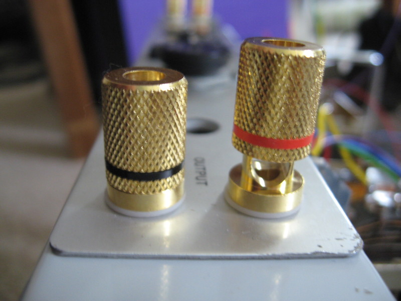

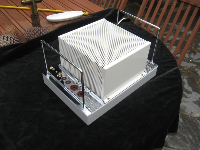

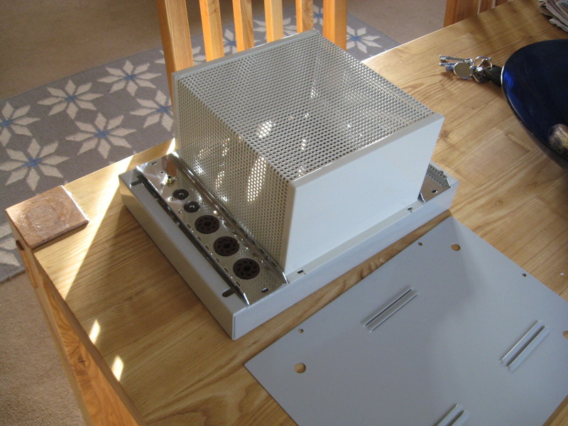

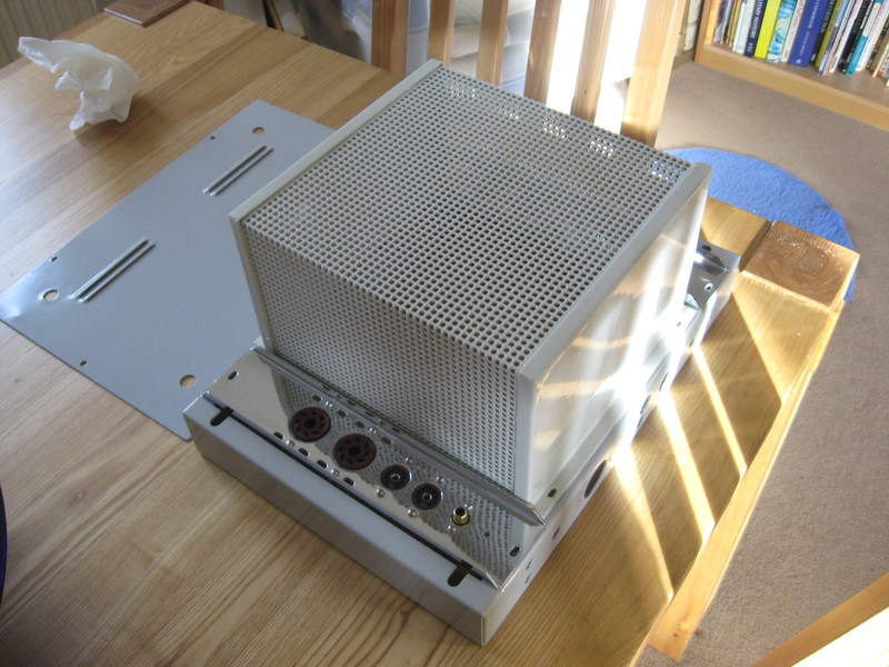

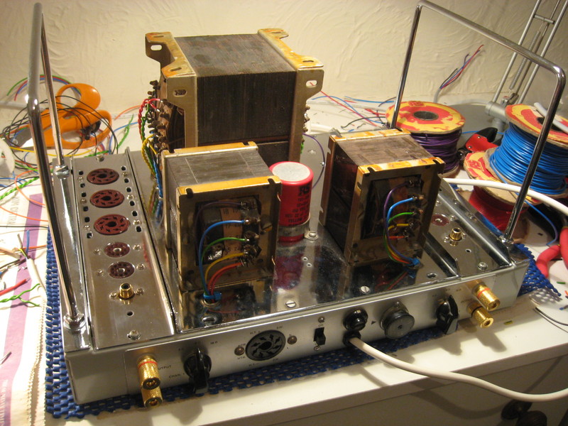

Here are some pictures of the assembly process. I tried to keep the amp as original as possible but I had to fit new binding posts, because the originals wouldn't fit in their holes due to the thickness of the new paintwork. IMO the new ones are far better anyway so this is no great loss.

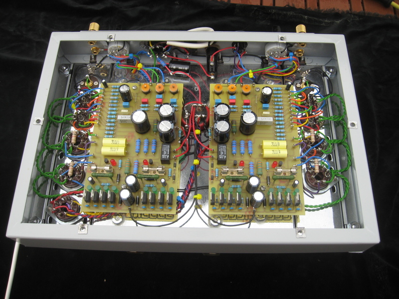

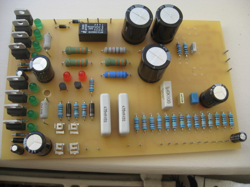

I then populated the final PCB version.
Features include cathode CCS bias, and a robust protection circuit to protect the amplifiers from runaway output valves. It works surprisingly well, in fact it has survived a shorted valve.

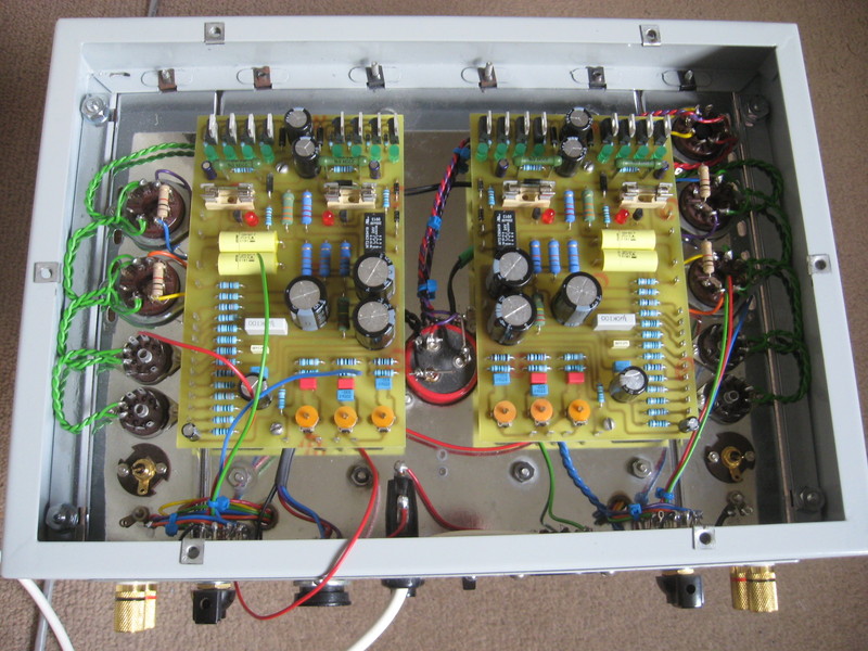

I then installed them in the amp ready for wiring.

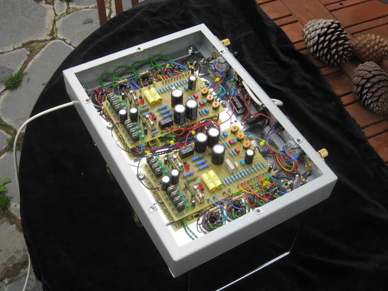

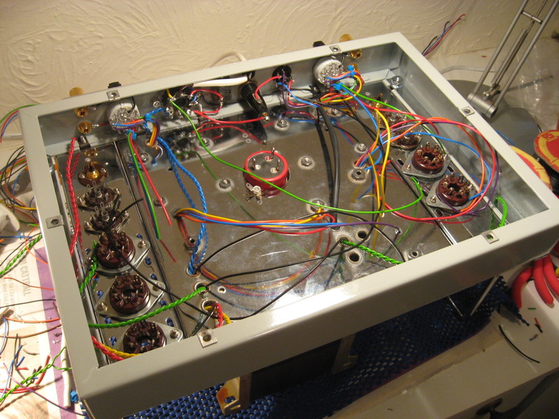

And the journey ends with me wiring up the boards!
I had a few teething problems but I eventually solved them. One was a very low frequency oscillation caused by the CSS bias, which I solved with the kind help of DF96, a frequent poster here.
Another was an extreme tendency to pick up earth loops, which I managed to fix by earthing the signal boards via low value resistors, to break the loops.
The whole project was a LOT of work!

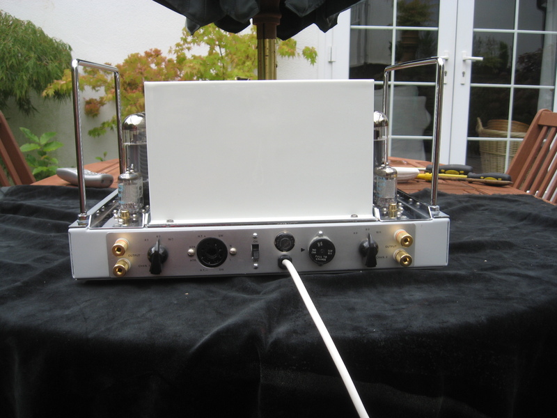

The last couple of pics.

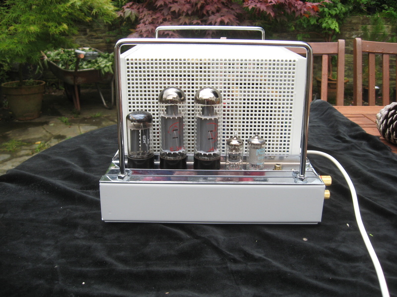

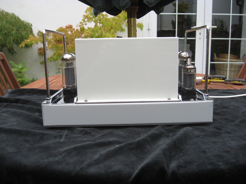

I hope you enjoyed them! I have others but they're mostly of more specific parts of the build, this is just an overview. If anyone is curious about any specific part of the rebuild I will post relevant pictures. The owner is very happy indeed with my work. Thanks for looking 🙂
